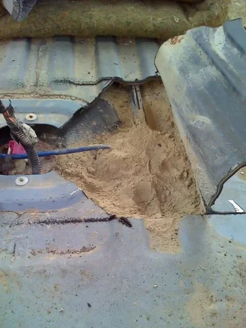

If I can get a general area, I will be cutting a hole.

You will see the cover plate for the float..the hole you want to cut is to the right. About a 5 x5 cut. A wheel cutter is fine as long as your careful.

WOW>>>>>>>I mean WOW...................is that dirt and/or sand? That pump looks like a oceanic discovery from some ancient wreck. Replacing that should help.... No?
Gravel Dust! And Yes, replacing it did help.

Dudley those pictures are insane. I can't believe it still ran looking like that!
if the fuel pump looks like that i wonder what the tank looks like. If it was me i would be dropping the tank and cleaning it out and figure out where all that junk is coming in from.
mwalls54 has a good point. Your fuel filter could probably use a change too.
i would do that for sure. I read in the other thread that this is your daughters. It wont take long for that new pump to suck up some of that gunk and leave her stranded on the side of the road.

Drop the tank, and get it cleaned out. Heck, if it were me I'd get a new tank, flush the lines (if not replace), change the fuel filter, spark plugs, and run fuel line cleaner for a few thousand miles...
