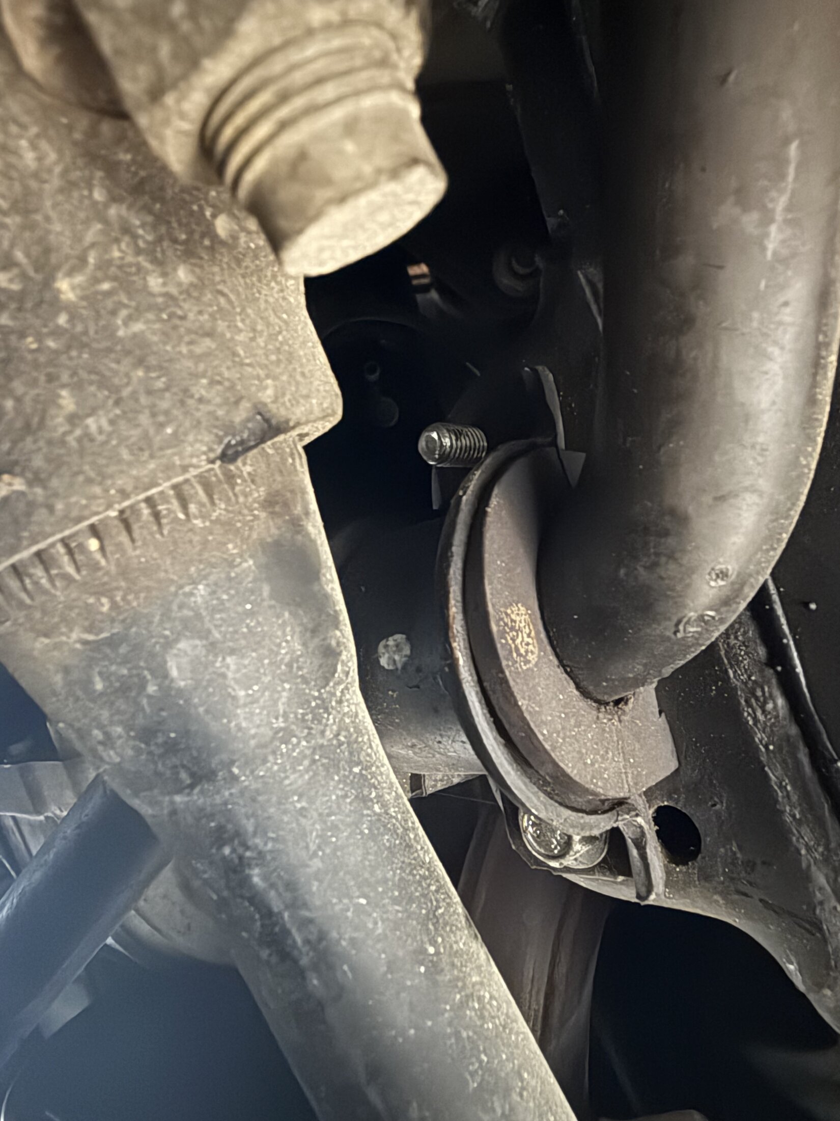

So I spent some time crawling around under it, making sure things were tight, etc. as one does. I noticed that the front sway bar bushings (see pic) have two fasteners (duh). However, one is going what I think is the wrong way, and there is no nut. To me, this seems like it could be the source of my problem, however, these sway bar bushings were replaced by a shop about a year ago (normally I do the work myself, but I wanted these done before a trip and they were doing my t-belt anyway), and I have not heard this noise before the event after my wheeling adventure.
Question: I assume these fasteners are installed wrong. It's the same on the left and right. Looking at the partsouq diagram, I don't see any nuts, so I assume the shop put them in the wrong direction, threading them thru a captive nut on the backside or something, leaving the clamp for the sway bar bolted effectively on just one side. Can anyone confirm, or send me a picture of theirs?
Thank you! Ok… so those are actually correct.

There should be a nut on the bottom of that downward-facing bolt.

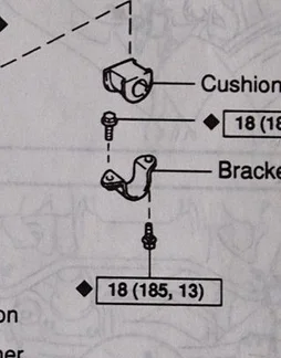

Also, I thought the downward facing bolt needed a nut too, but it turns out the bracket is threaded on that side, so no nut required (see shop manual image posted above). Furthermore, I replaced the sway bar bushings and end links long before this issue appeared after my wheeling adventure last weekend.

I know the image from the FSM shows no nut, but mine (original OEM) has a nut on it...

My 2006 that I replaced original parts on with new Toyota parts looks exactly as yours. It looks exactly as the diagram posted. There should not be a nut, the bracket is threaded.
