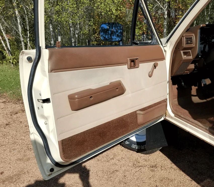

I was just going to mention, my 85 has half door cards up front but its not drilled like your doors in that lower bare section.
@c2dfj45 those panels are very cool. But, given my 7/8 coverage panels... I'm thinking they might look a bit odd - unless they're exactly 36.5" Love the idea though.
Yeah, I think they're supposed to look something like this...
And the lower holes are for that sweet sweet carpet ;)

The above pic is exactly how my '84 was set-up, down to the color combo. I always kept the AAA KA county maps that covered the Mojave Desert in the driver's side pocket.
