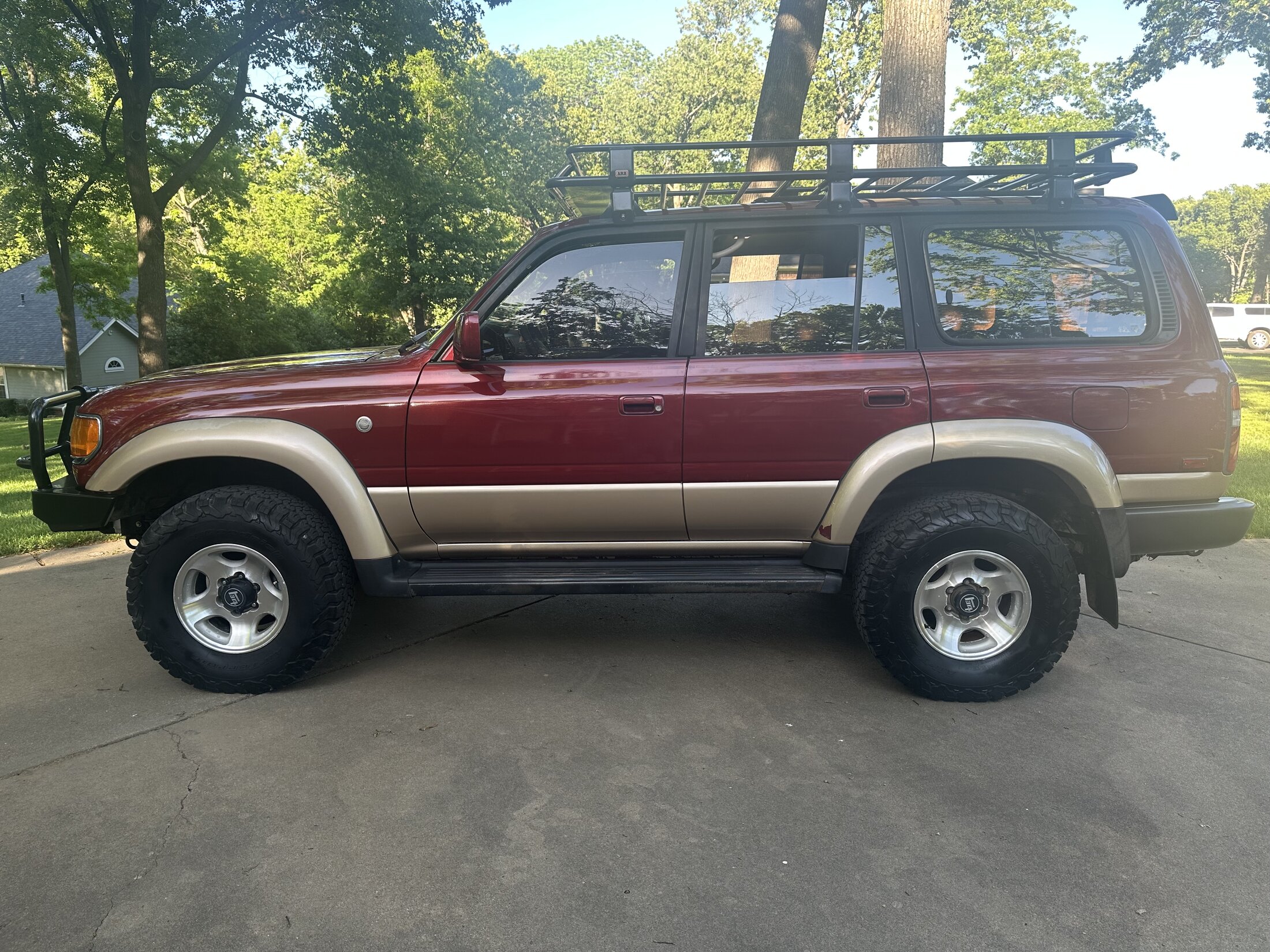

Sorry guys for my lack of terminology. I’m about as mechanical included as a wood pecker. Here’s what going on. I ordered a set of center caps from SolveFuntion. I’ve attached a pic of the outcome. I really prefer this look to the stock caps. Everything went smith until the 4th cap. As you can see in the second pic, Solve function uses an adaptor/collar that threads onto I guess the hub flange, correct me if this isnt the flange. And the front caps bolt into these collars. As you can see from the second pic, I had to unscrew the collar about 1/8th to 1/4th of an inch in order to reach the threads (only on this one cap). I’ve reached out to SolveFunction for a possible set of longer bolts and a new cap since as you can see, I cracked this one trying to force it. I’m 1000 percent sure he’ll work with me to correct this but I would like to know if this is dangerous to drive in this condition. If so, I’ll just revert back until I get a longer bolt. Hopefully this was clearer than my original post. Please advise on safety.
Thanks
Robert

Removed the cap and reinstalled the standard nuts today on that wheel. SolveFunction already has longer bolts in the mail. Great customer service.
Robert
