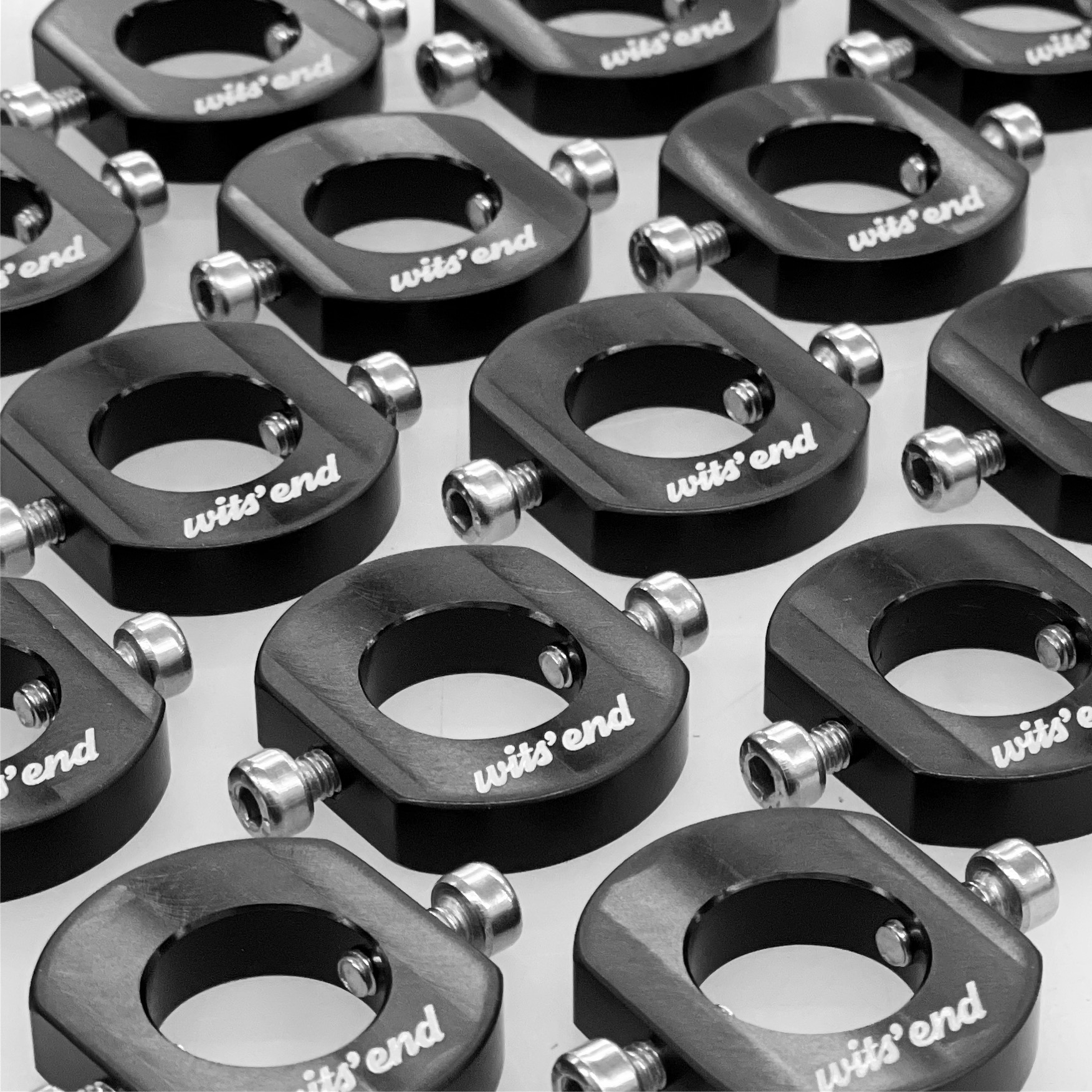

Next up from the goody bag that arrived from the anodizer…
Been out of stock for a minute but got plenty plenty more after filling back orders.

I have my mirror dissaembled, but I can't get the wit's end piece to slide over the shaft, I'm going to figure out a way to ream out the wit's end part or grind/sand down the shaft to get it to fit.
Any ideas?
I assume the fix should go over the shaft snugly but still removable. If I press this on it's not coming off...
