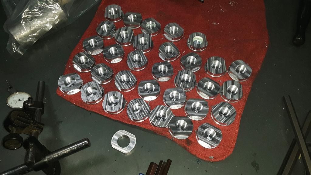

Well these turned out to be fairly popular. First batch sold out so finished up another batch. Going to anodize.
How much?
Might have been discussed here. When you drill the holes, make sure the FM block it flush with the top. If not the spring will fully compress before your screws can go into the holes you drilled. Deeper is not better here.
Nice product. Now you will need to produce an upgraded triangle trim piece that comes off to access the bolts. It’s always a 50/50 gamble to get it off in one piece. At least with me.
I broke my original one so I bought a new $20 one then promptly broke it the next day. The fix was JB Welding a magnet onto the triangle pastic near where the original stud popped off. It comes off very easily now and holds very well. No shaking, vibration or annoying breaking when I have to remove it!
@NLXTACY, your mirror stud looks different than mine. Did you have to cut off the ears or anything? Mine has the sheared tabs and I went with the threaded pipe fix about 3 years ago and want to buy your fix kit as I couldn't ever get the mirror tight enough to stay put through car washes. I don't recall if I cut mine though or if it was needed.
@Dissent stud is the same but looks a little different because when the mirror compression spring pushed his shim retainer off it physically moved material and pushed it up. The mirror fix collar should have not problem going over this and there is still material for drilling the holes that catch the SHCS of the collar
I’m not trying to hate, but mine lasted about a month. I pulled it apart and figured it broke because of the other set of holes I drilled too low. It wasn’t the case. The aluminum casting is very porous and just broke. The two holes have to support a lot of tension from the spring. I even tried to Tig weld more meat on it, however I figured it wouldn’t work since it was cast.
I ended up using a long bolt and drilled a hole and rerouted the wires. I think a better option would be to make a hollow threaded rod with bus on each end. Then the wire and still be routed factory style.
