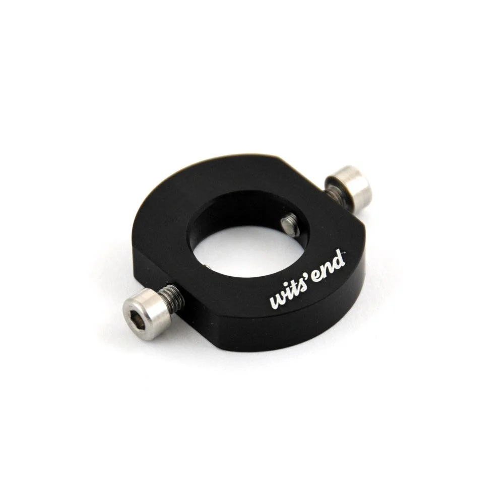

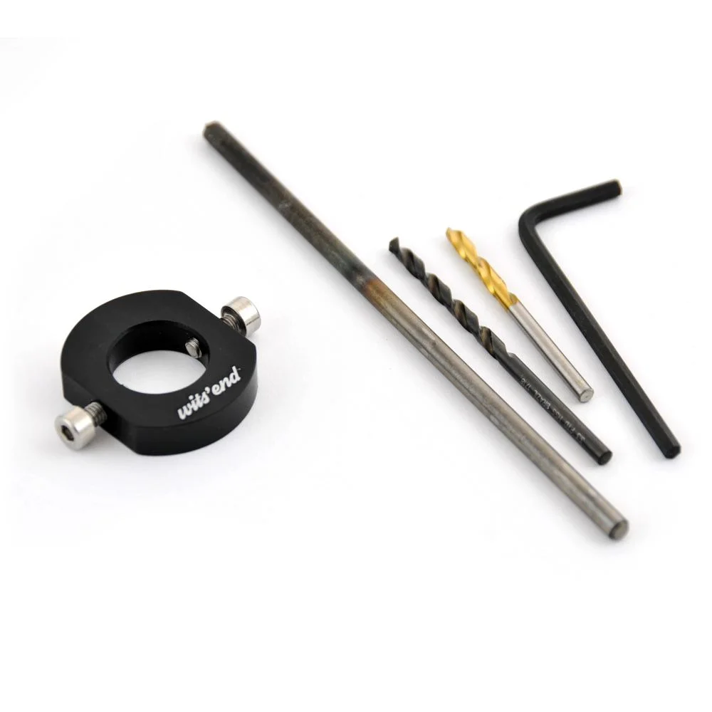

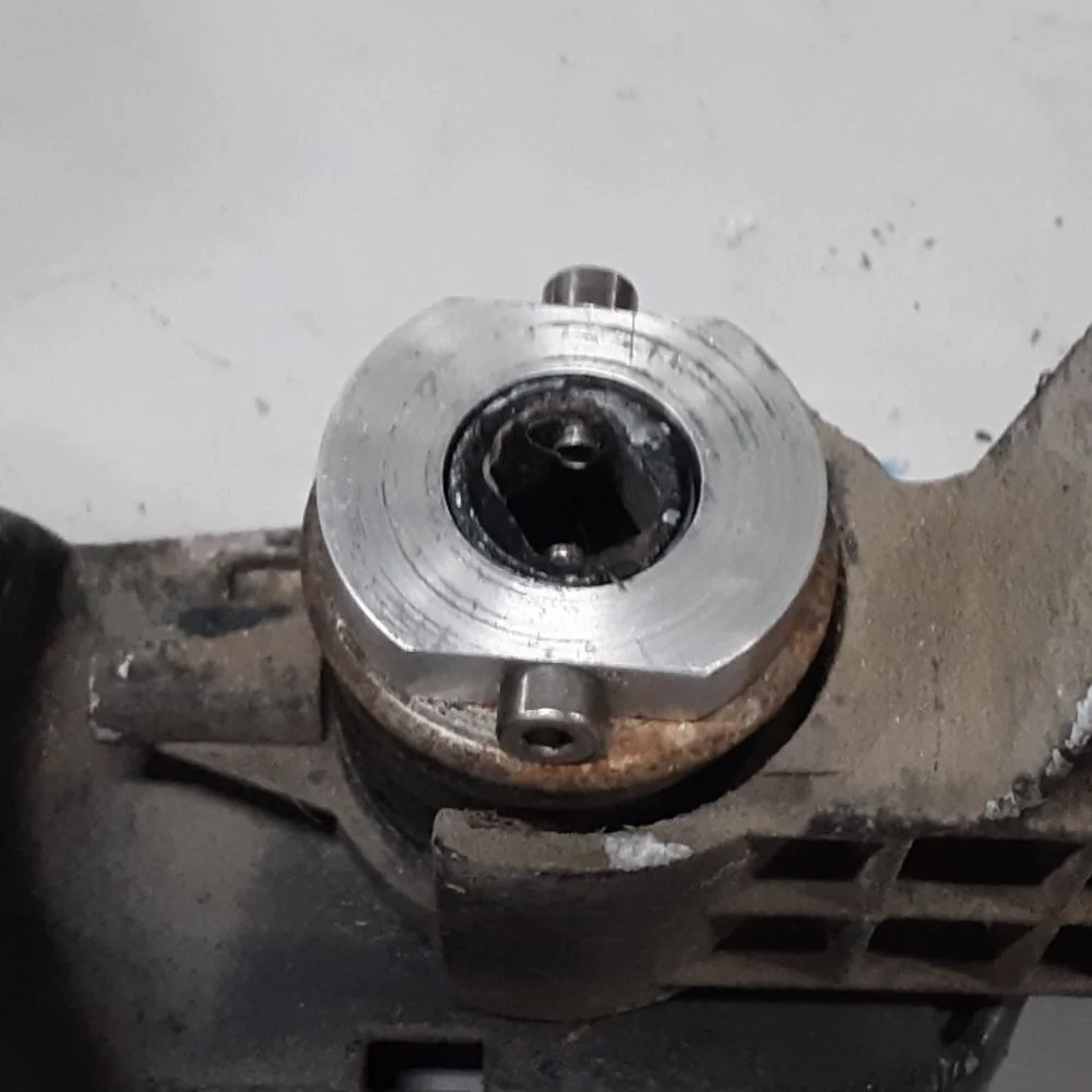

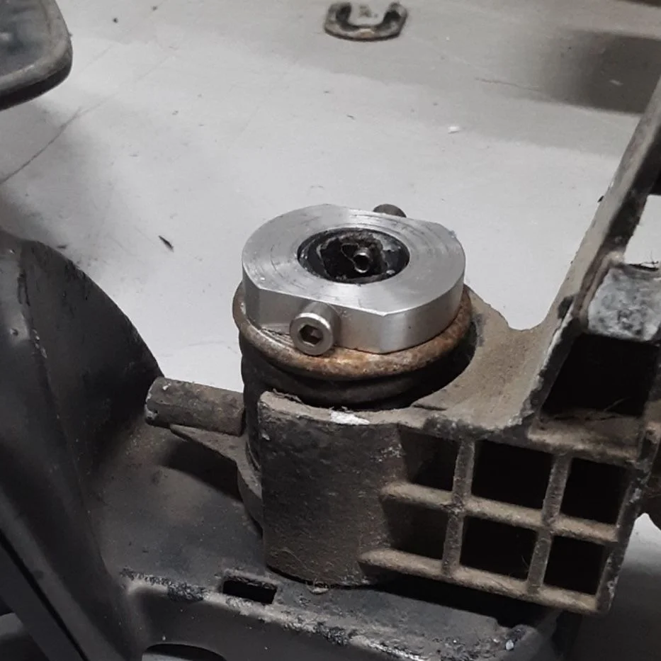

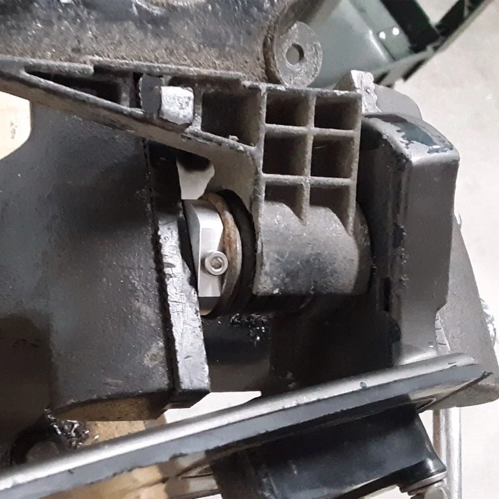

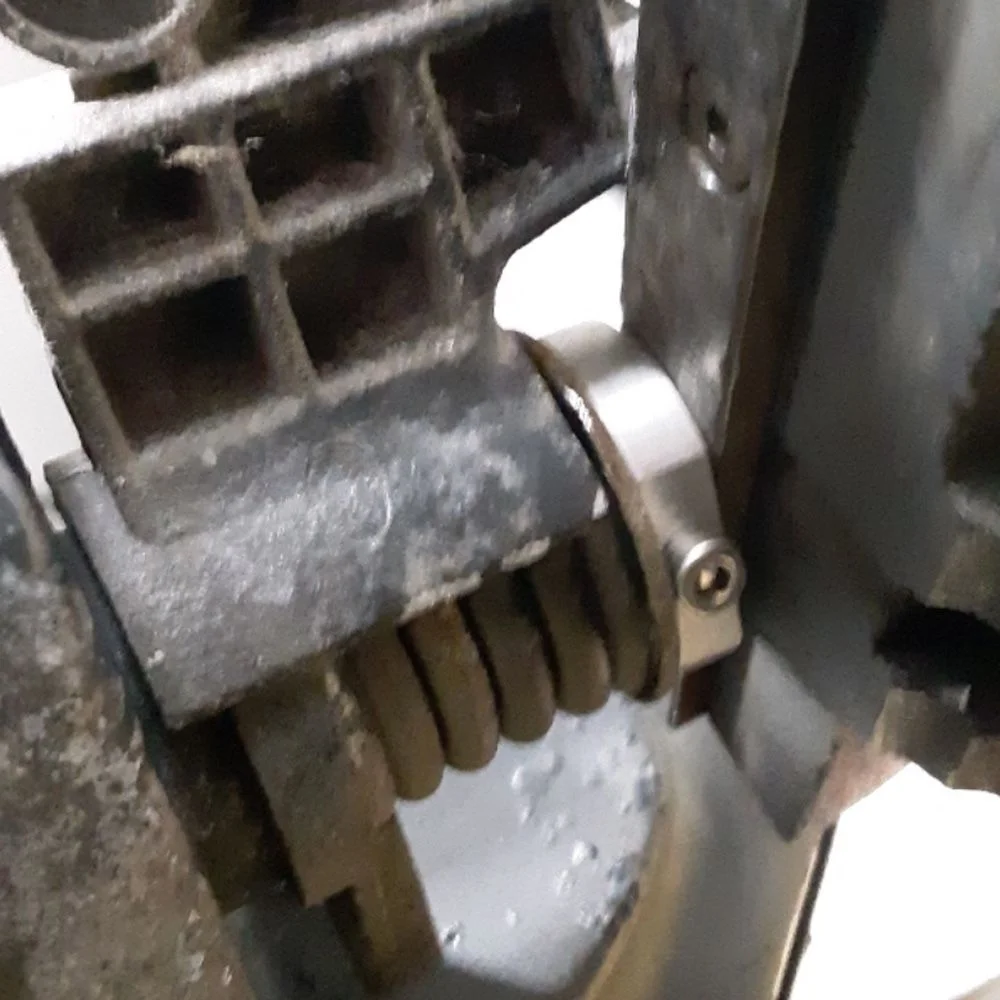

Anyone with an 80 Series Land Cruiser will, one day, eventually have to deal with the Floppy Mirror Syndrome (FMS). Now this is not to be mistake with Shaky Mirror Syndrome (SMS). FMS needs something a little more that what modern medicine can offer, it requires surgery. In this case you *could* just pound a 16d nail into it and call it a day. For those of use that don't solve our problems with nail, there is a more refined solution.
Remove the mirror currently experiencing floppiness. Decide if you want to either pound a nail in the shaft or go my route. Either way works.
If you go my way then just place the new piece and Mark for drilling and then drill both sides.
Mine just broke. Haven’t taken it apart yet and found the clip on the ground. I was reading some threads about rerouting the wires when using a bolt. With this fix I’m assuming no need to mess with the wires?
The wires have plenty of room like they did before. Chaffing on the screws might happen after many many cycles. Hundreds or thousands is my guess
The wires are thankfully in a sleeve already.
Nice product. Now you will need to produce an upgraded triangle trim piece that comes off to access the bolts. It’s always a 50/50 gamble to get it off in one piece. At least with me.
Not to disparage your eloquent solution but just want to throw out that its also possible to grind new grooves 90* out and slip the c clip back in. Which is maybe a bit better than driving a nail through the thing. This does look easier/better though.
Oh I don’t disagree. I actually started with a hose clamp until that gave 😂
This looks like a great solution. I was lucky enough to find junk yard pieces to fix mine. They of course required painting. If they give out again this is what I am going to do.
