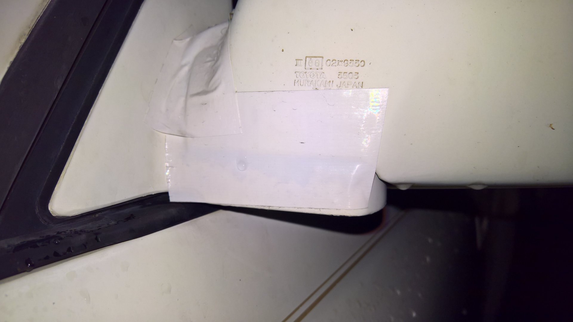

No just the little triangle window pieceI don't remember if I have to take the door panel off to wrestle the mirror wires out. Does anyone recall? I don't want to but I just remembered I do have new inner/outer window trim to install.![]()
Awesome, thanks!No just the little triangle window piece
If you are removing the mirror and separating it from the vehicle then there is more to it. On my 95 I replaced the passenger side mirror yesterday and in order to access the connector for the mirror harness I had to remove the door panel. There is a connector that sits behind the speaker. I have attached a link to the video that helped me complete the job without breaking things. The plastic garnish (Triangle) pops off by pulling the top first and when you do this the retainer might be worn out and not reusable like it was in my case . If that happens then you need part 67499-30020. ** Joey supplied this number to me. Thank you Joey!I don't remember if I have to take the door panel off to wrestle the mirror wires out. Does anyone recall? I don't want to but I just remembered I do have new inner/outer window trim to install.![]()
Not everyone has a fancy de-pin tool. Oh wait I do have one.No you just de-pin from the back of the mirror glass panel and you can slide the wires and pins thru the tube in the mirror pivot.
