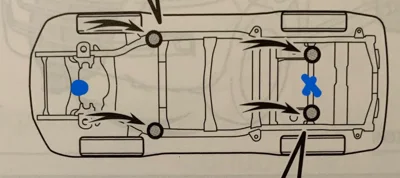

1) Can I use floor flack on the rearing housing differential (some call it the pumpkin) and front cross member (need to remove skid protector)? I hear it's better to use the frame rail but i would like to get the entire front or back up by using the aforementioned jacking points.

I forgot to attach the picture from the manual related to point #1

1. Yes, you can lift from the center of the axle housing and front cross member without issue. You will need to remove the splash shields in the front to prevent it bending though. Also depending on the lifting plate of the jack you use, you may mark up the crossmember.. if there is some kind of wooden or hard rubber block, it really helps.
I use a Pro Eagle with the rubber disk in the center of the lift plate with no issue pushing with the factory skid plates installed. No warping, no issue with re-fitment, no visual distortion.
Good to know. Mine was damaged by a tire shop assuming they could jack there. No rubber pad.
Practically speaking, I never jack from the front cross brace because taking off the shields isn't worth the effort. I'll usually jack from the robust LCA inboard mounts with a polyurethane jack pad.
