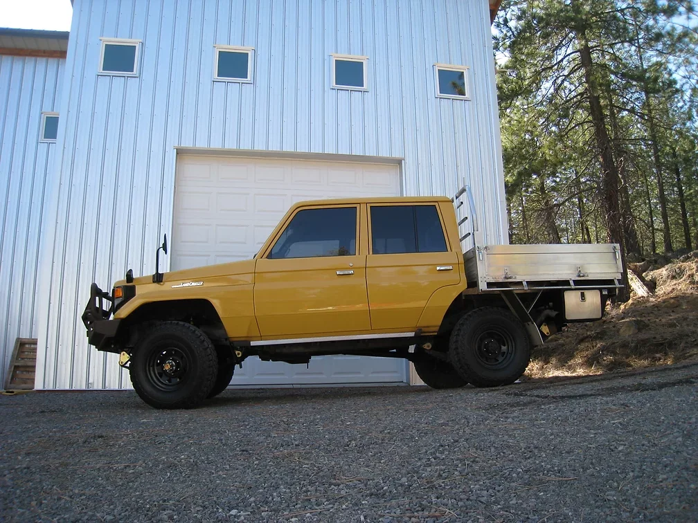

Welcome to Mud. Yeah there's at least 5 or so people doing this at the moment. @JDMBC has a thread started on his HZJ79 fire truck, and I just started posting about mine, but I have yet to remove the fire truck body yet. I would suggest considering a flat deck as an option vs a factory box.

My main reason is the amount of space offered by using a factory box will be less than a flat deck. It depends on what you plan to do with the truck in the end. You can fit a 6' long flat deck without compromising the off road capability. Also flat deck manufacturers are able to include creative storage solutions that a factory box won't be able to. I really love the looks of the factory box, but in the end I decided against it. If you have instagram, there's a ton of Aussie 79s on there with a wide array of flat decks / metal canopies to inspire a design.

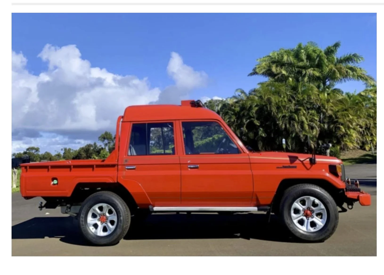

I saw a photo (can’t remember where it was published) where the pump under the rear seat had been removed, the rear floor had been repaired and the elevated roof had been replaced with the low profile roof from a dual cab 79 Series. It looked great. 😊

Was that this one of Eco Offroad?
I am really liking the flatbed/ute look. I think there was another one in red as well somewhere.

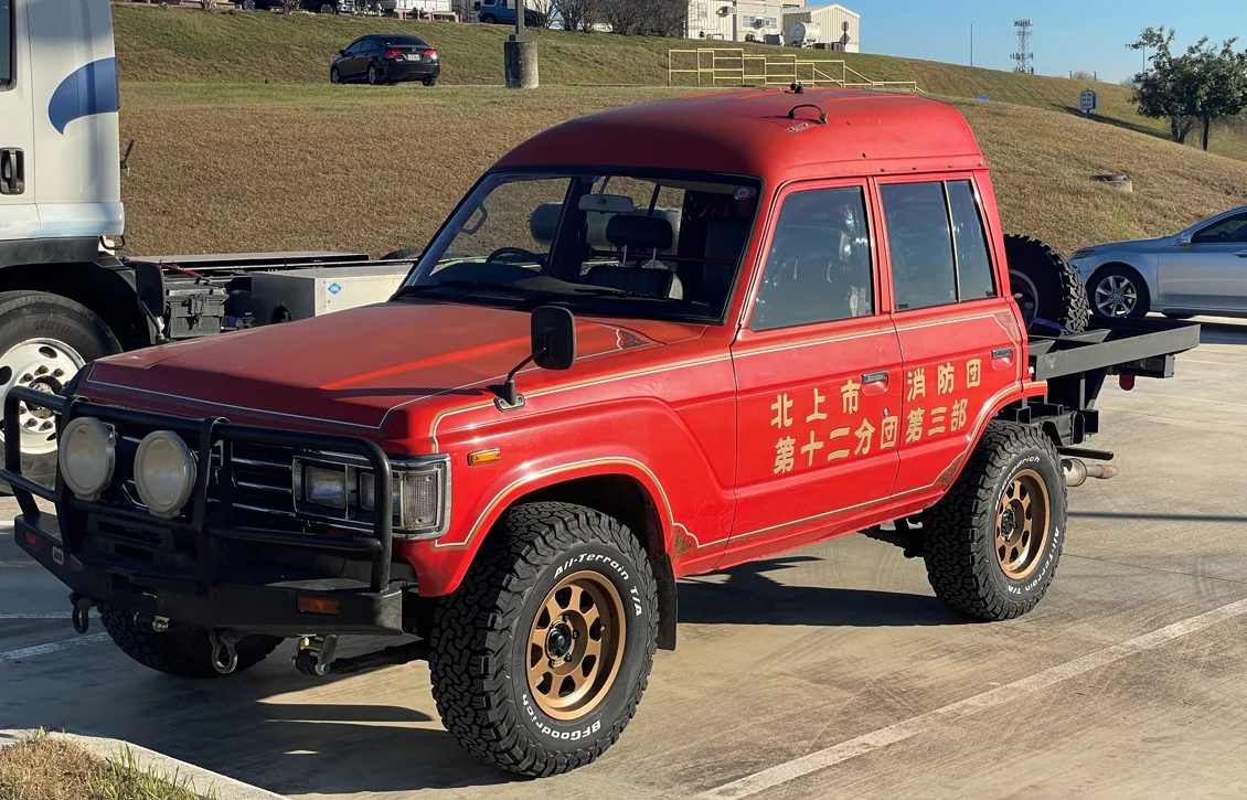

Not a 75, but I'm working on an FJ62 fire truck. Still very much a work in process, but so far its still a great platform!

Looking good. How was removing the pump station?
