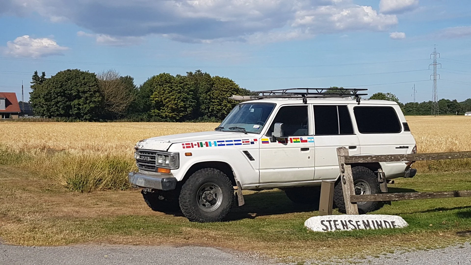

Here I am, another broken record. Just received my FJ62, 1988, from Argentina yesterday (I'm in Denmark). Drove it there from LA.
It was driven on the ferry, but now it won't start. Battery is completely flat. It's charging overnight, so I'm hoping that jump-starting it with another car just didn't provide enough juice.
