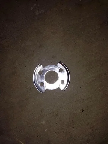

here's the pump mounted and wired up. i have the pump up kit for it to which should be a nice addition. this is the switch set up in the dash. some mild trimming was needed to get them to fit. these parts came with the pump up kit. what are they for and do i need to leave them on the quick coupler?
can any one tell me what this part on my ARB pump quick coupler is for?
