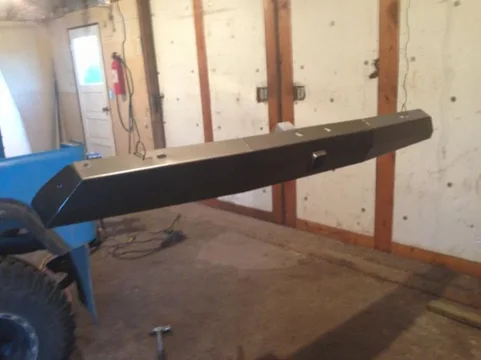

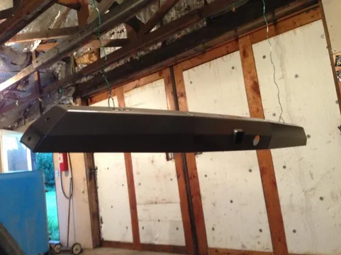

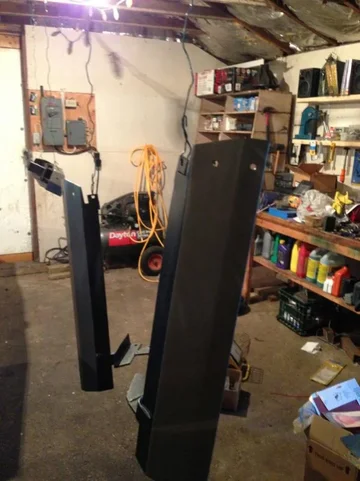

well nothing new about the lift this time as the title suggests but I wanted to post up a picture of the bumper I'm touching up for the 62. it's one a friend made and now has no use for it. it's got two side pieces that protect the quarter panels too they are in primer right now.
it's up side down being painted. I'll of course post when I get it on the truck

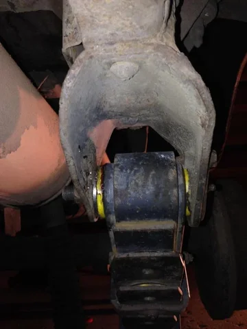

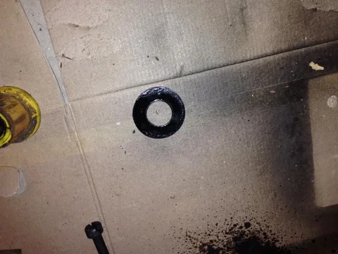

well im back at fine tuning things and doing some needed maintenance before winter. its turning into a big job. i am trying to fix my spring clunk. i thought it might be the sleeves (OME dakkar) that were sliding but it actually turned out to be the springs sliding over the bushings because they were not a snug fit between the hanger. i made some "washers" out of 1/8 inch steel and slid them in to fill the gap so the bushing cant slide out of the spring sleeve. i'll post some pictures of what i'm talking about when i get them loaded up. we'll see if it fixes the problem. i also changed my 3 degree caster shim to 4 degrees because i still have a little annoying drive line vibration i want to try to fix and then i can put the three degree ones up front. that's what the alignment shop said i was out by anyway up front. while that was all off i put the proper shock bushings in because the ones that came with my shocks were the wrong size and i kinda wrecked them making them fit. now that's all back together and i have my rear axle apart to do bearings. i sure wish i had just done them while i was doing the rear end. while im there i figured its time to change the rear brake liners. I've had them sitting on my bench for almost a year so i better get them in. the old ones are really thin. so thats where i am right now and have a sore eye i'm annoyed with. taking the brake liners off i had one of the little twist washers that compress the spring (no idea what they are called) that holds the liner in place pop off and smoked me right in the eye. stupid move. because of that I'm done for the night. i still have to put it all back together and then put some of those "washers" in the front springs. after that i have to fix my heater cable which is stuck (the valve moves fine so i think its the other cable). lastly i want to hook up my air compressor. it's all plumbed from my locker and the pump is mounted. i just need to wire it up and mount the switches. i have the next two days dedicated to the truck but i still don't know if i'll get it all done. it's a lot of work when doing it single handed (friends are all at work). i sure love working on this thing but the little things can sure add up if neglected. one thing i've learned is that i love air tools. i just bought a set and this is the first job i've used them on. sure saves a lot of busted knuckles and sore hands!!!

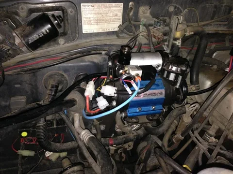

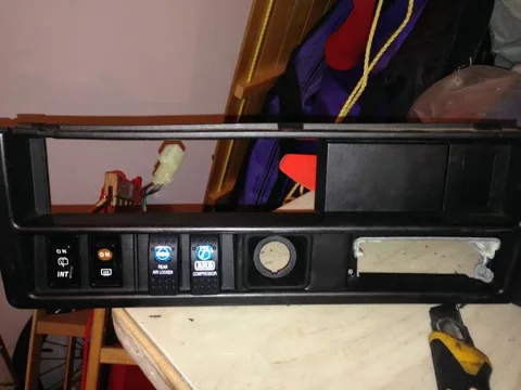

got one from 4wheel auto coming for tuesday. in the mean time i'll get some other stuff done. i found out the for some reason the control wire from the heater control was bent and that's why it wouldn't move all the way through the full normal range. straightened out the wire and now they work perfectly. no idea why that happened but thankfully as easy fix. should also have the ARB compressor and switches all hooked up. just to be sure on the wiring diagram switch one goes to the locker and the compressor switch goes to the isolation switch wires right?
here's the pump mounted and wired up. i have the pump up kit for it to which should be a nice addition.
this is the switch set up in the dash. some mild trimming was needed to get them to fit.

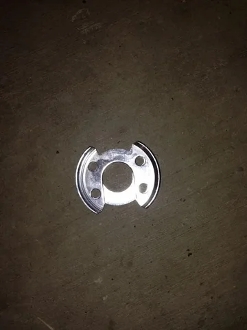

these parts came with the pump up kit. what are they for and do i need to leave them on the quick coupler?
here is a picture of the "washers" i made to fill the gap in the spring perch. this will hopefully stop the bushing from sliding out of the sleeve therefore allowing the spring end to slide back and forth over the bushings (there would be a small gap between the bushings in the sleeve) causing a clunk every time it slips. make sense?
