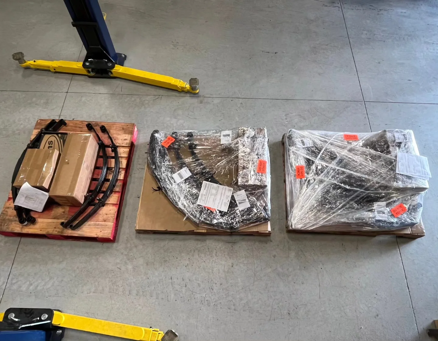

We would love to help @ Cruiser Outfitters. We have Old Man Emu and Dobinsons kits in stock and ready for immediate shipping along with all of the while your in there parts you may want/need such as sway bar extensions, hardware, etc. Our parts team will discuss your exact FJ60, your current and future plans, tire size, etc and dial in a suspension for you. Give us a call and we can make it happen: 801-563-1277
Here are a few kits we shipped out this last week :cool:
