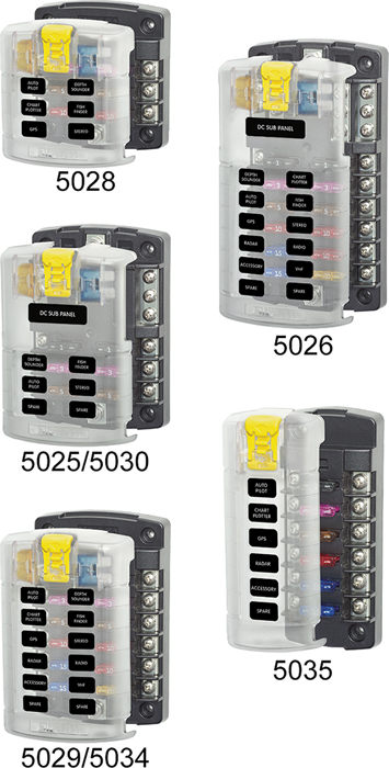

Even cleaner is one of these. Blue Sea makes them in 6 and 12 circuit versions, with either a common hot bus or separate feeds. I used the 5028 for my upgraded headlight circuit, but you just as easily use it in place of fusible links. Hint: when working on your truck's electrical system, visit a marine supply store - they have MUCH better goodies than auto parts stores.
