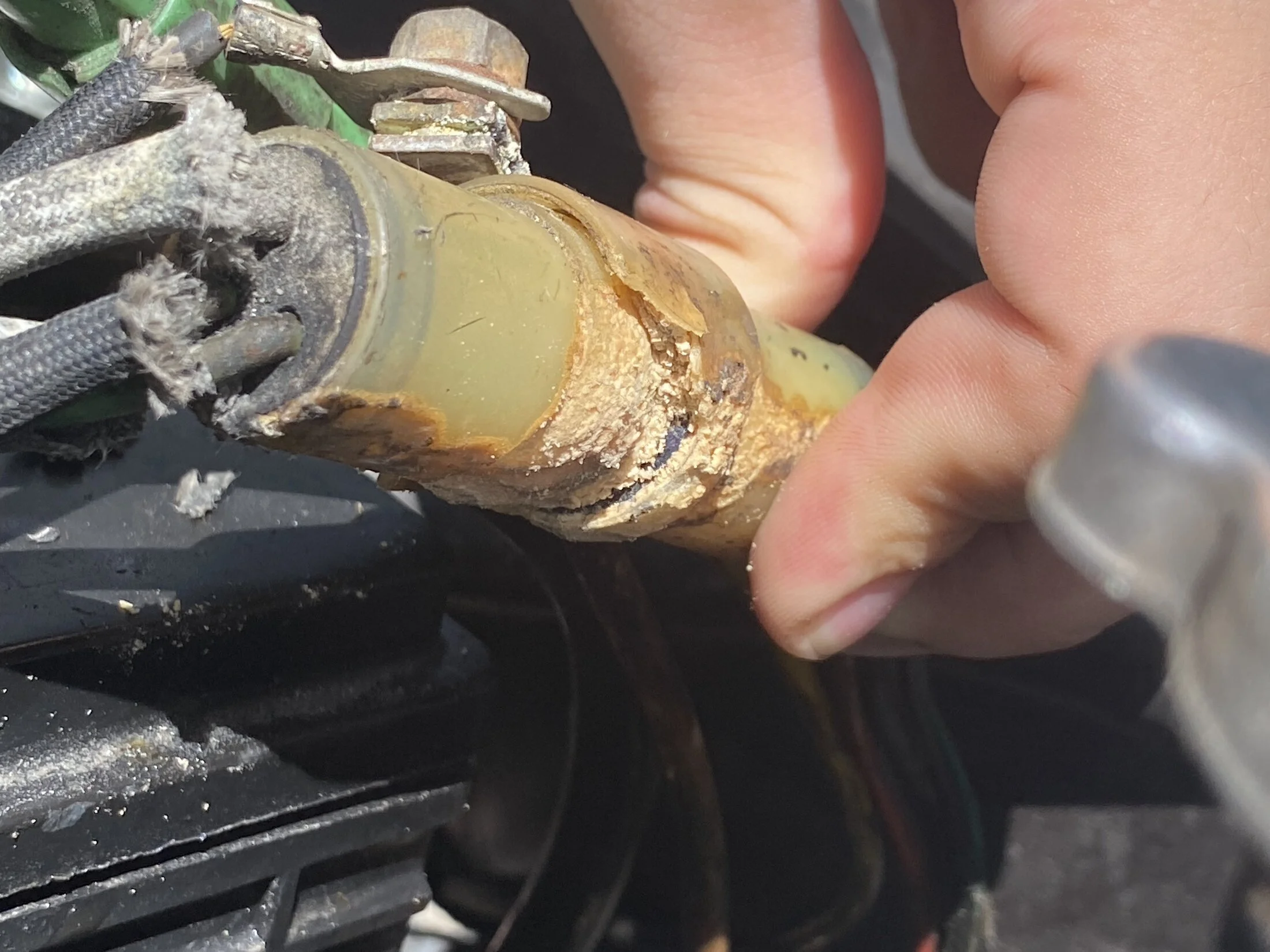

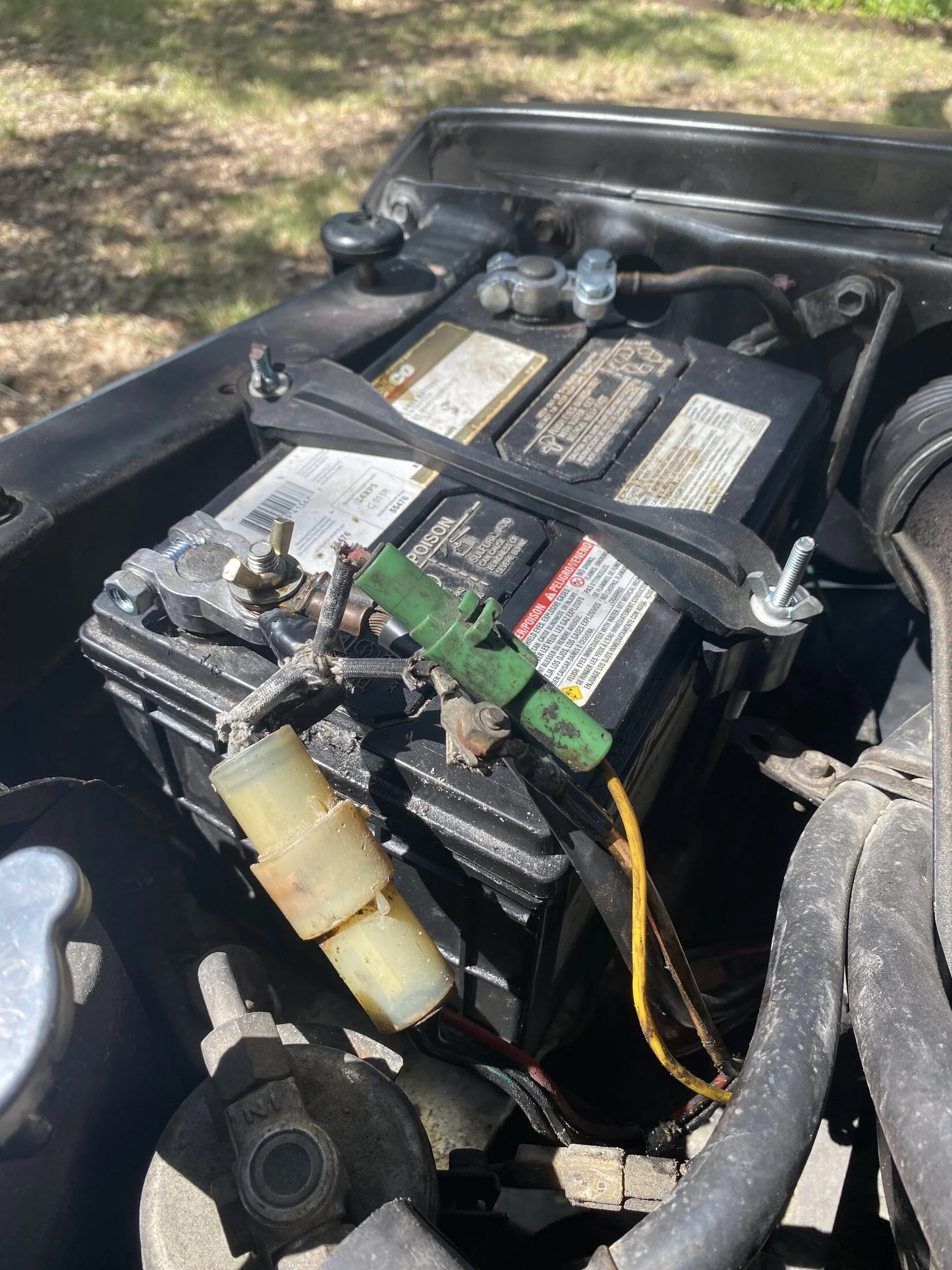

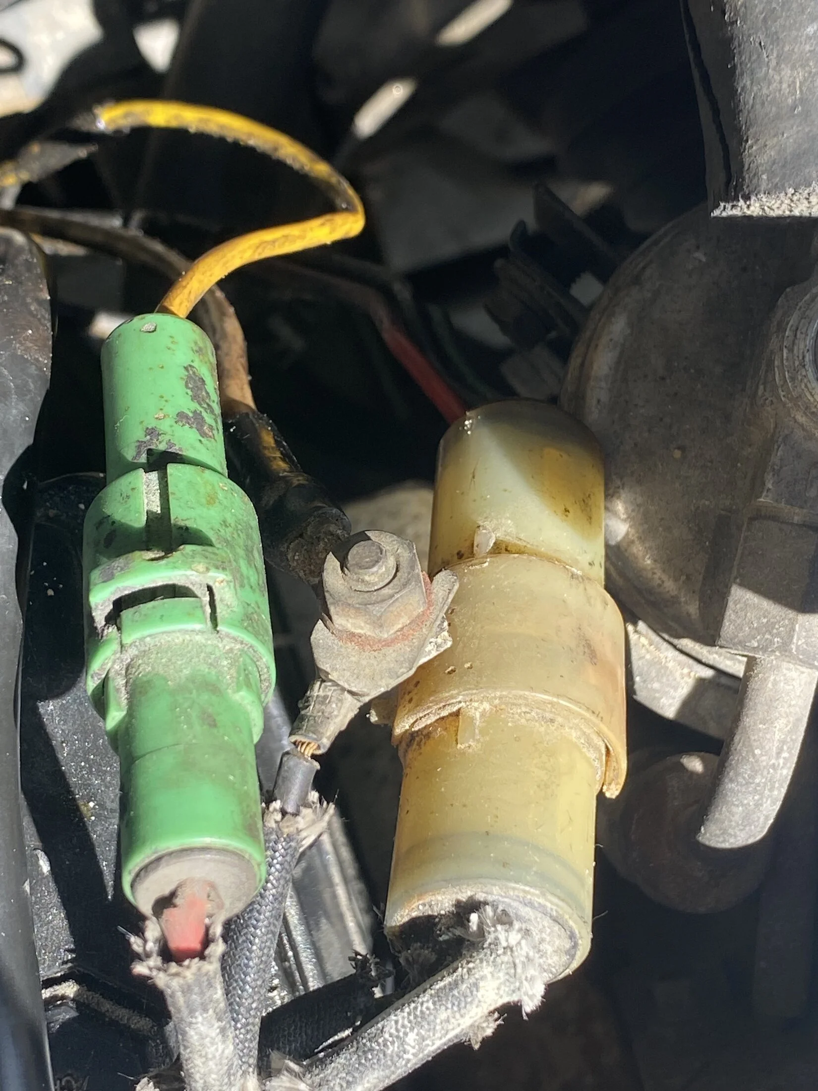

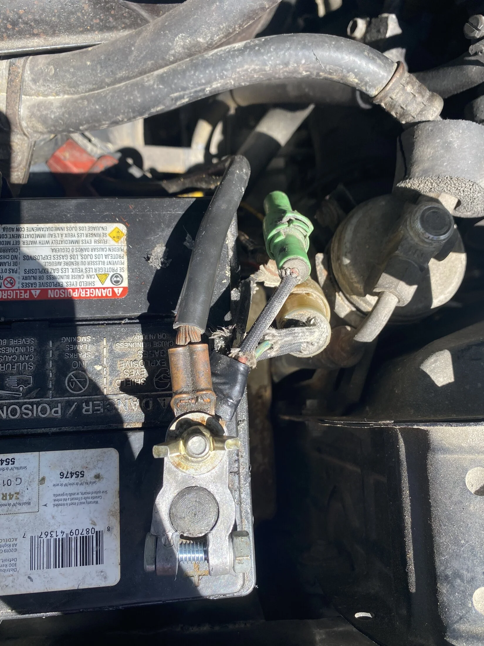

1. The dreaded "click" has started to come back in this hot Texas heat, I have already replaced battery, terminal connectors, starter, and alt. So I fear that my fusible link will give its farewells sooner rather than later. It already looks like it's on its last leg. (see attached photos)

1. I would like to first try and repair/save the fusible link that I already have before it goes out. If possible. If not, I would still like learn about what electrical knowledge goes into making this component tick and what I would need to do to repair it, from an engineering standpoint (aspiring engineer). Or where should I be looking to teach myself more on these topics? If not for me than for others who reference this discussion.

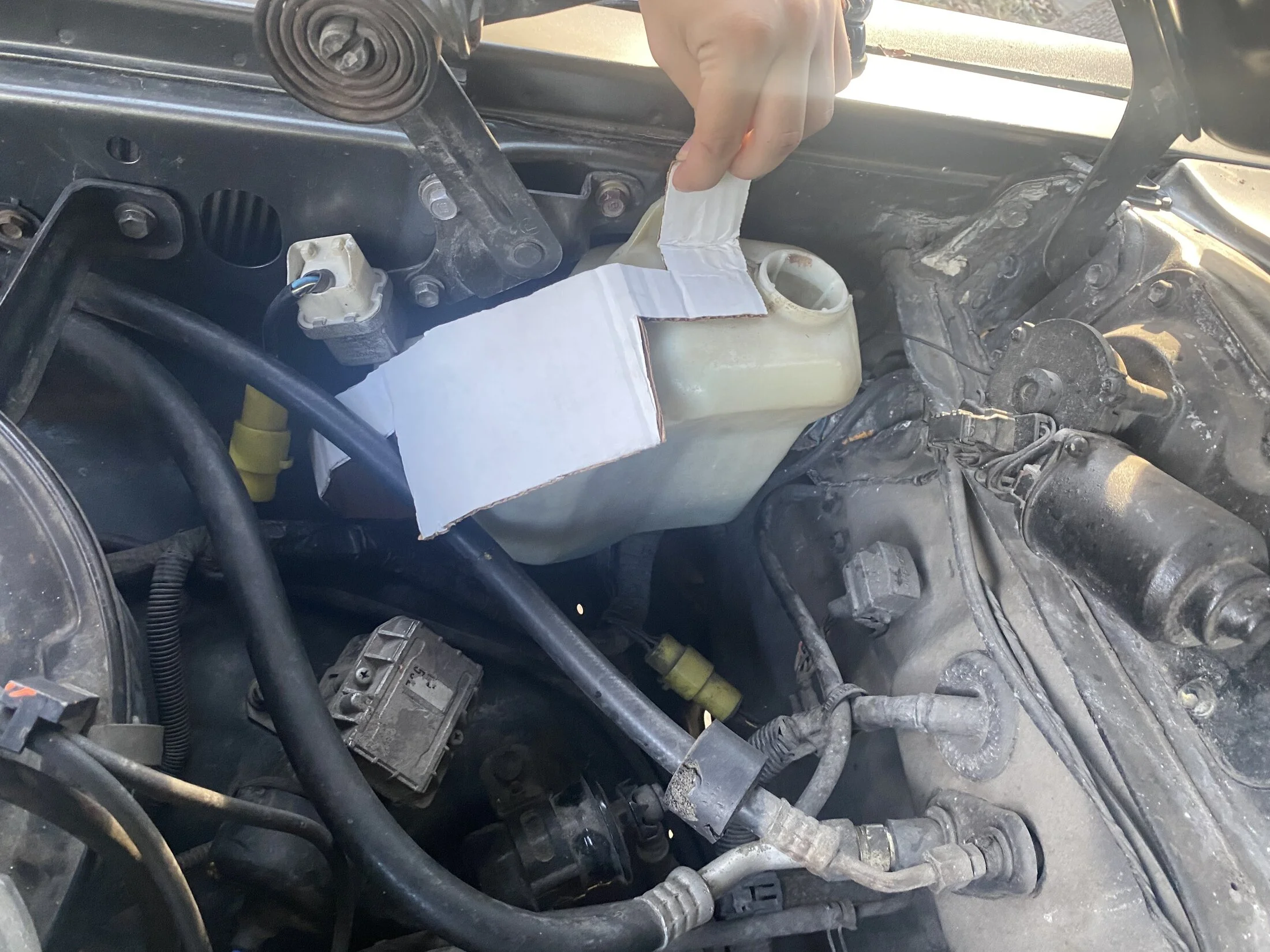

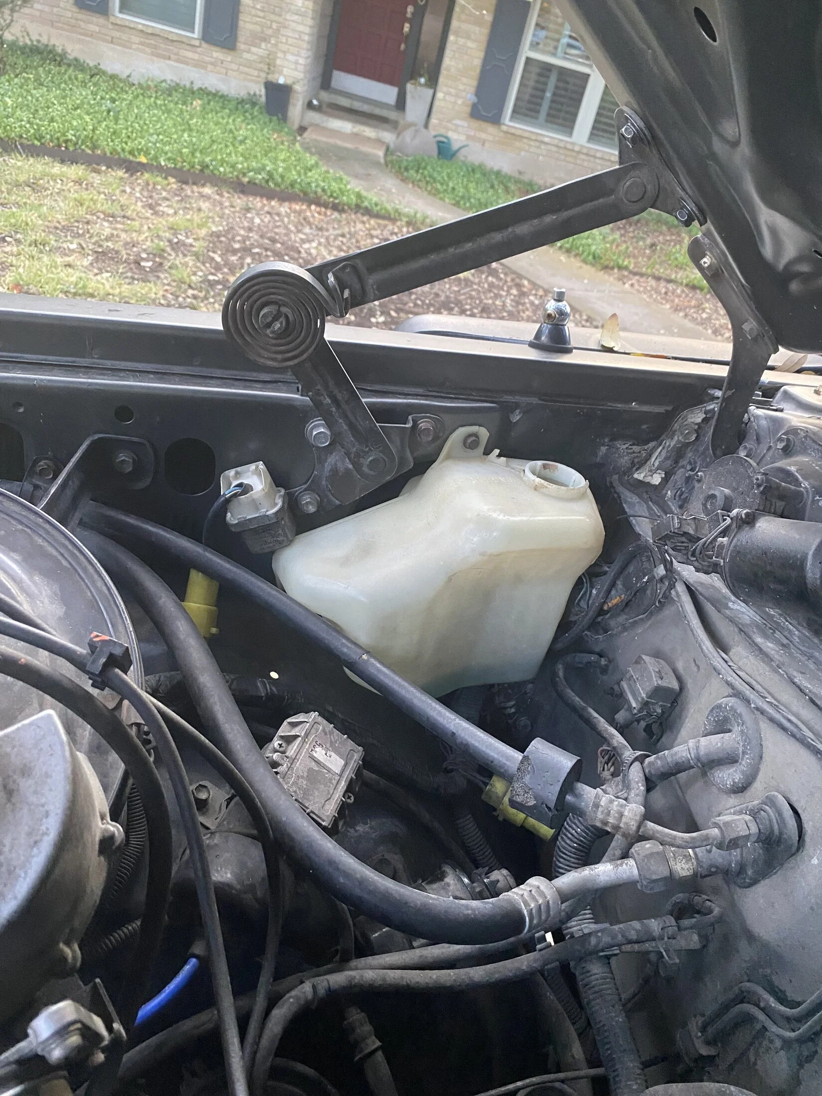

-Does your current position account for the washer reservoir? Pic attached for reference.

1) My understanding is the fusible link is designed to be similar to a slow blow fuse and the primary weak point in the harness to protect your car from burning down if there is an issue somewhere on the vehicle harness.
It is possible to buy the correct connectors/terminals and new fusible link wire online to build an exact replica of the current set up. This might be the most cost effective solution but will take some internet sleuthing to find all the right stuff and youll have to get the right crimpers etc etc etc
Its all part of the fun with these rigs......

-Regarding the washer, mine was broken, but I did try to stay out of its way with the bend. Not 100% sure, but you could 3d print the file in my thread to check

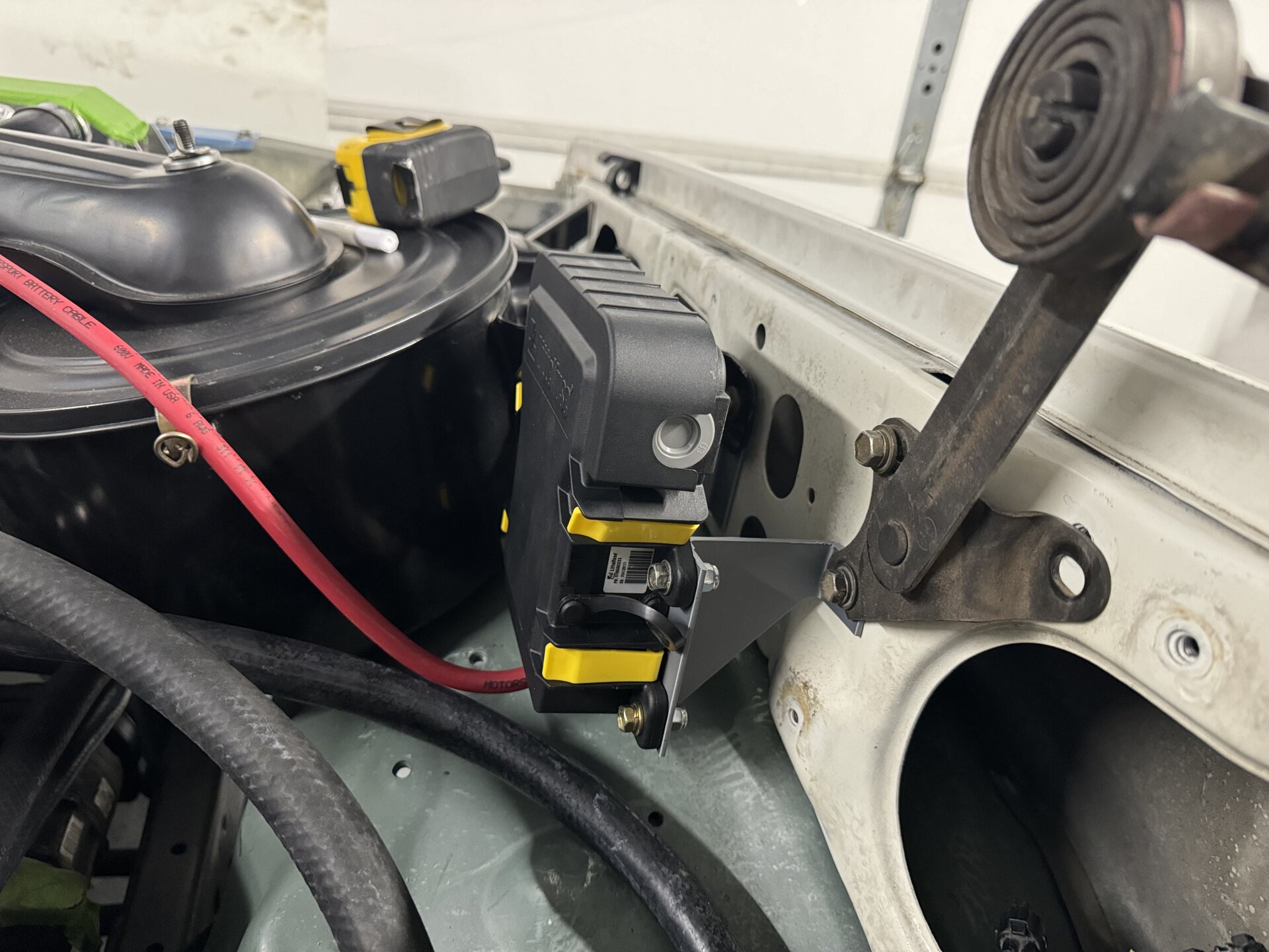

I was playing around in the engine bay and came up with this idea as a possible fix to the OEM DIY fusible link location problem and wanted to bounce it off you guys while I CAD up the bracket. Does this location/setup seem reasonable? It would mount to the washer reservoir mounting point and to the wheel well. @CruiserTrash @BurntToast
Might get interference from the hood assist spring. Maybe it sneaks by though. You also want the shortest distance possible between the fuses and the battery + post. The longer the run, the more of a risk of an unfused dead short.
It was either there or on the air filter bracket, out of the two this one seemed less invasive but I will continue to play around and keep you updated.
Can you explain what you mean a little bit more, I understand that shorter is better, but in this case what is "short". Is it like 2in or 6in, and at what point does length start to make a noticeable difference. I thought it was because the longer the wire the more resistance there is, or is that the cause of an "unfused dead short"?

No, but you’re getting warm to a place I’m seriously thinking about. Regarding accessibility I think it needs to be easier to get to than that.

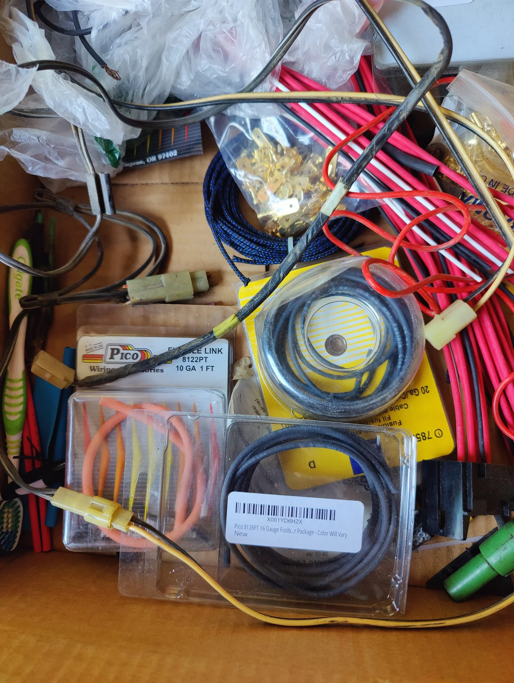

I think the repair option viable. I was able to salvage my connectors. I did plan on an alternative connector in case I couldn't salvage mine. The double link wire, connectors, crimpers, heat shrink, etc were all available on Amazon. The FJ62 fusible link gets confusing with the FJ60 link because people start saying they have one to sell you it are offering a product that is still available from Toyota. The FJ62 fusible link is not available new but it is fairly simple to recreate.
