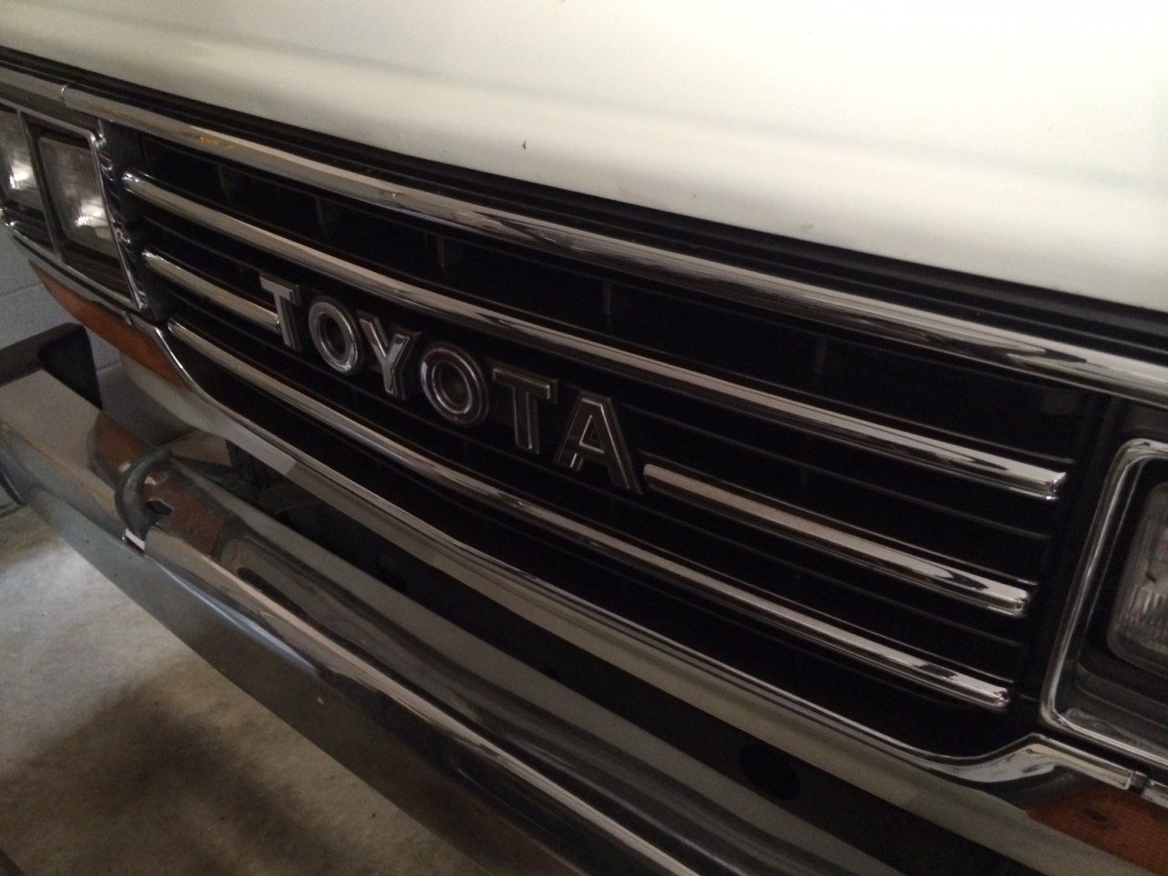

I just found that CCOT offers an aftermarket grille and the headlight surounds, and they are a dead on match. I ordered last week and total with shipping was about $250, installed in 30 minutes. Best money I've spent so far for the aesthetics of my 62!!...To top it off, I took my old faded, shipped, peeling, set and sold on Ebay and went for $230.

Can you post a close-up photo of the CCoT grille? - the price from CCoT is pretty rockin', I must say.

A few pics

I have heard mixed reviews on those aftermarket grills. But they do look pretty good! no fitment issues huh...?! Wonder who manufactures them? I'm liking this idea!
...via IH8MUD app
No fitment issues. I'm a die hard OEM guy but this was one I had to try. I bought an aftermarket tail light lens about 5 years ago once and I couldn't get it installed it was so awful, I never tried again..until this one. This went on with no problems at all and $1000 cheaper than OEM....$1000....
The grille on my '85 was held on by zip ties and wasn't noticeable unless you were really digging in there. That CCOT grille looks awesome... If I'm feeling spendy, I might consider that for my round headlight conversion :D
Sexy grille. Thanks for posting the pictures. Kudos to CCoT for carrying a product that seems unique to them.
