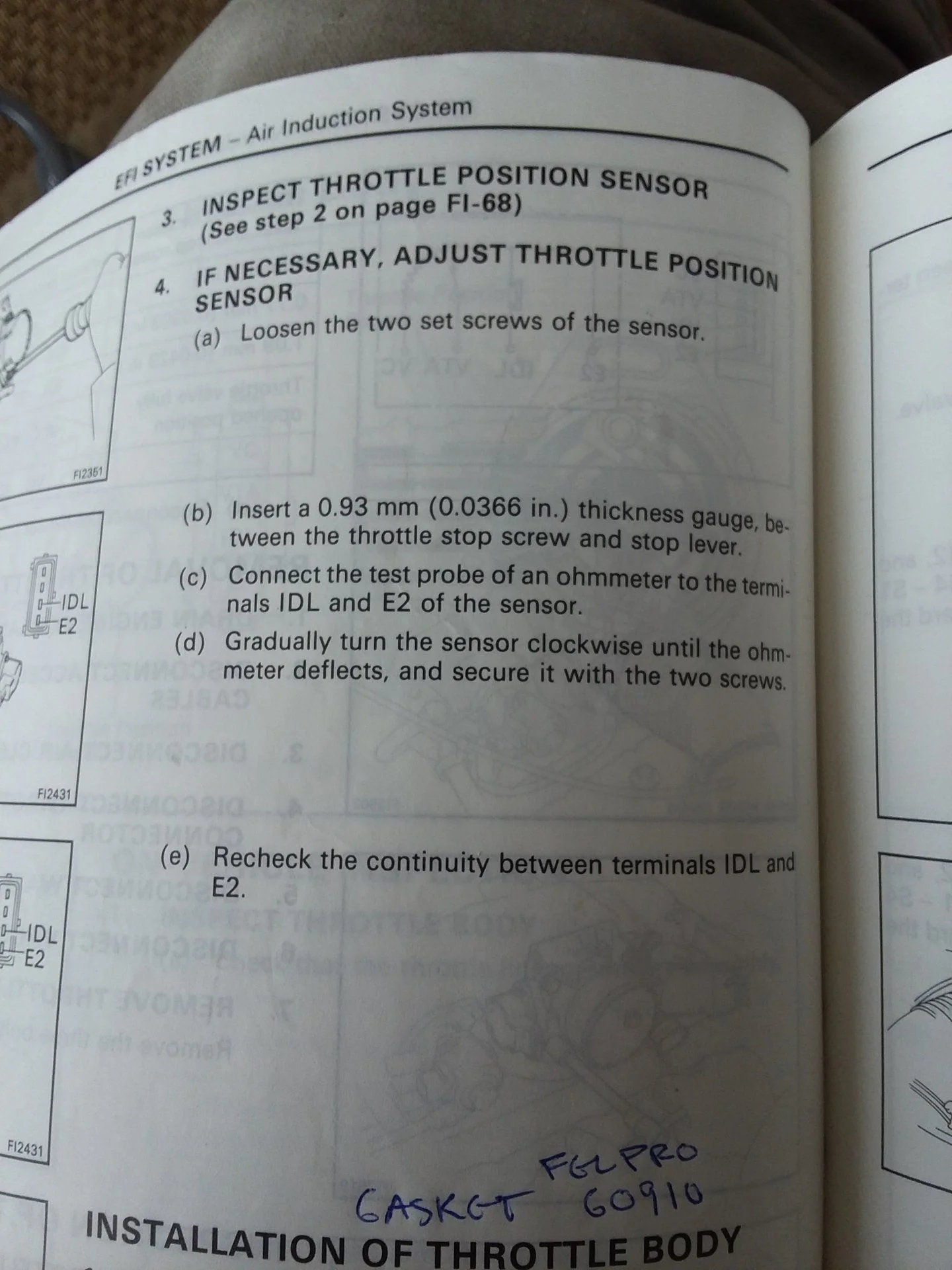

I don’t have any feeler gauges for checking the resistance measurements specified in the Haynes manual. I was wondering if I could somehow bypass the throttle position sensor just to get it to run?
I found some feeler gauges, so I’m about to start checking my TPS sensor. My emissions control sticker says California compliant, and tps diagnostics says to apply vacuum to tps sensor for California models. What is the beat way to go about applying a vacuum? How big a difference does it make?

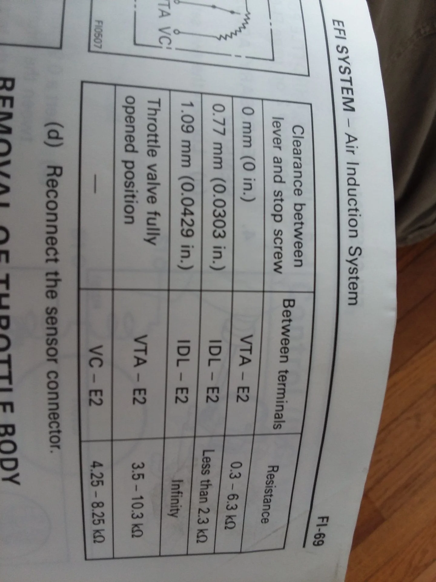

Checking the resistance between idl and e2 pins with 0.0303” feeler gauges between the throttle lever and throttle stop screw, I had an open circuit (infinite resistance). I adjusted the TPS until I started getting a resistance measurement which was 40 ohms. But then I read about the same resistance with 0.0429” of feeler gauge also. It’s either open circuit with both checks or closed circuit with both checks. I can’t get it to adjust where it switches from closed to open when I change from 0.0303” to 0.0429”.
A week or so ago someone posted a question about why I used 0.043" when adjusting my TPS instead of the 0.0303". Their FSM only had the 0.0303" number (in the text), but on the same page my FSM includes a table with the 0.0429" number, along with the 0.0303" in the text. Their FSM lacked the table. So I'm not sure what the deal is. My '86 FJ60 with 3FE runs great the way I set it up.

Any progress? You're into the tps switch now regardless ey? Heres the info from my FSM
I did both of those shim measurements with the throttle body on the bench. They list both so do both.
Also, @Vandyfan if you can't get it to read like the FSM indicates, replace that sucker. Its a critical piece for the 3FE to run correctly. Still available new from Toyota thankfully.
