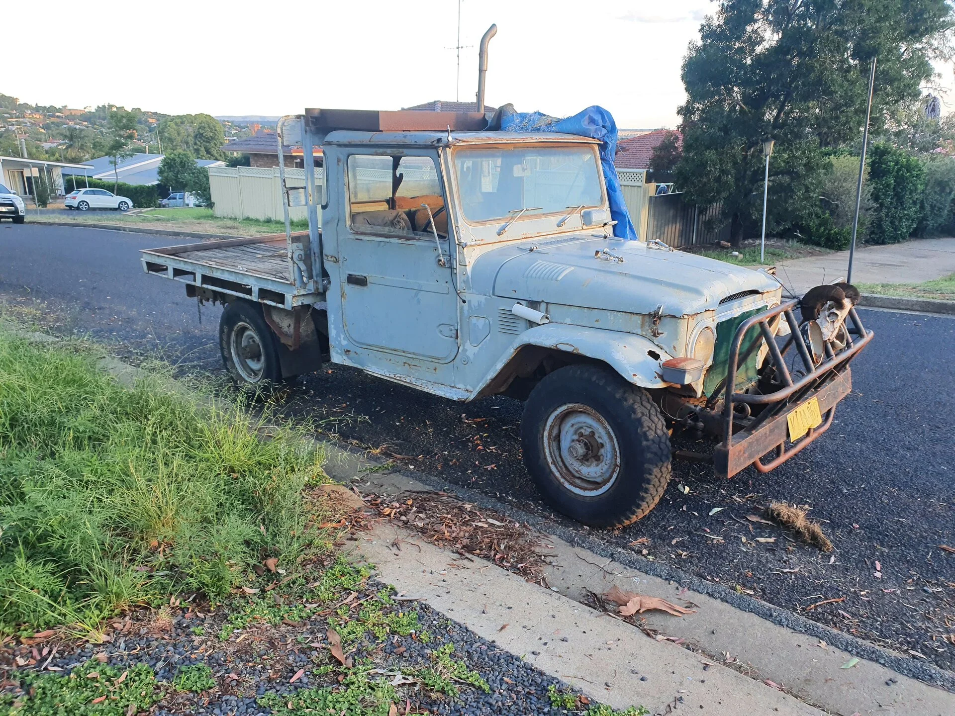

I've got a 1976 FJ45 I'm "restoring"

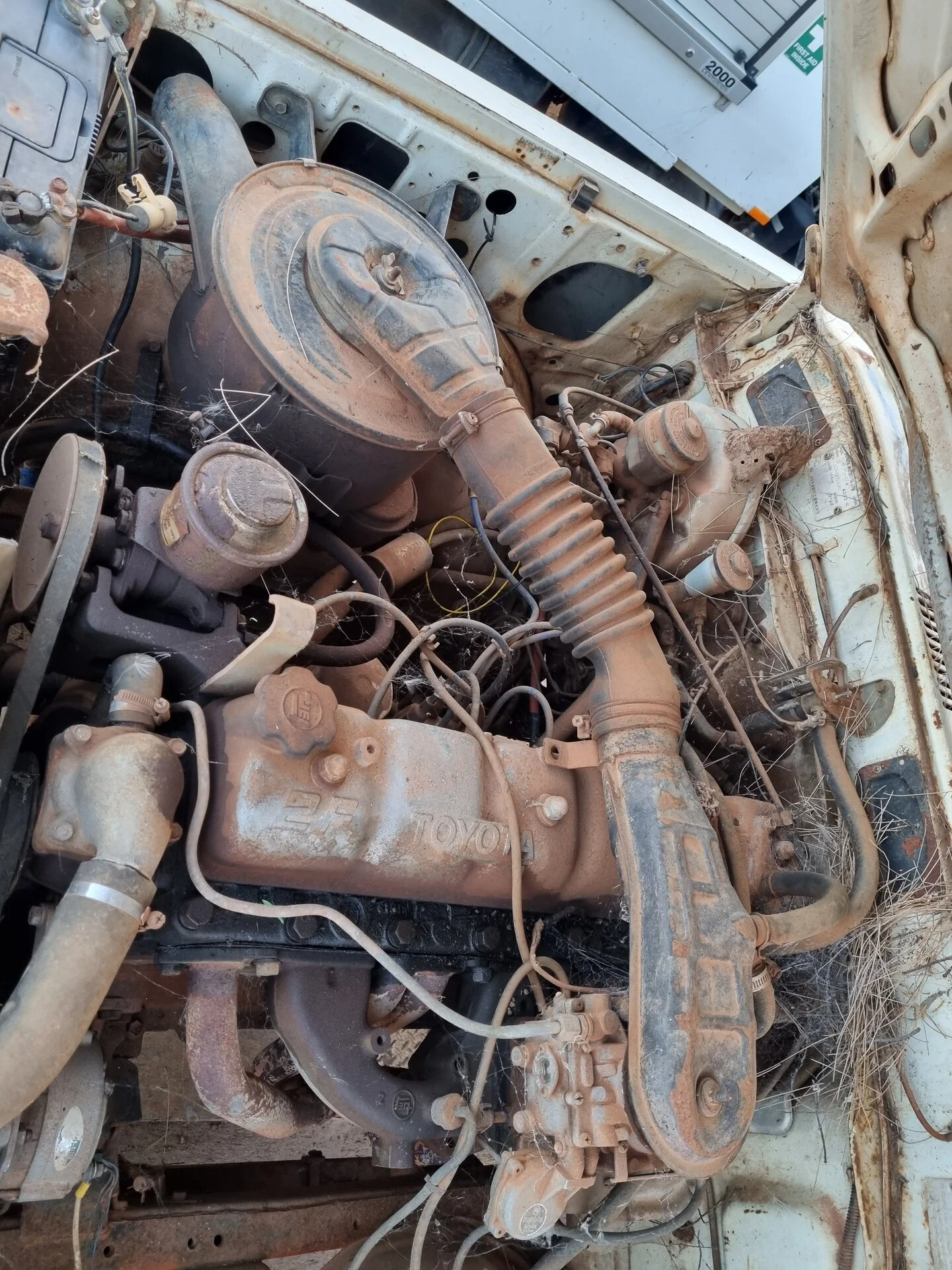

The 2F in it has died and too expensive for me to rebuild. So I have picked up a 1980 FJ60 cheap for its engine.
The question is, what else do I keep of the 60 that could be useful on the 45 before I scrap it.

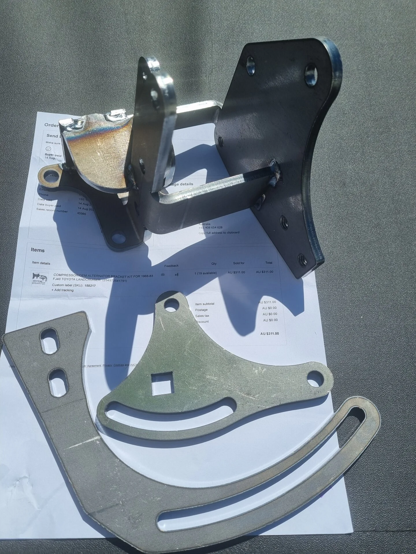

My FJ45 currently has manual steering, 4 wheel drum and no AC. I do however have a yet to be installed Vintage air AC and ALT bracket kit.

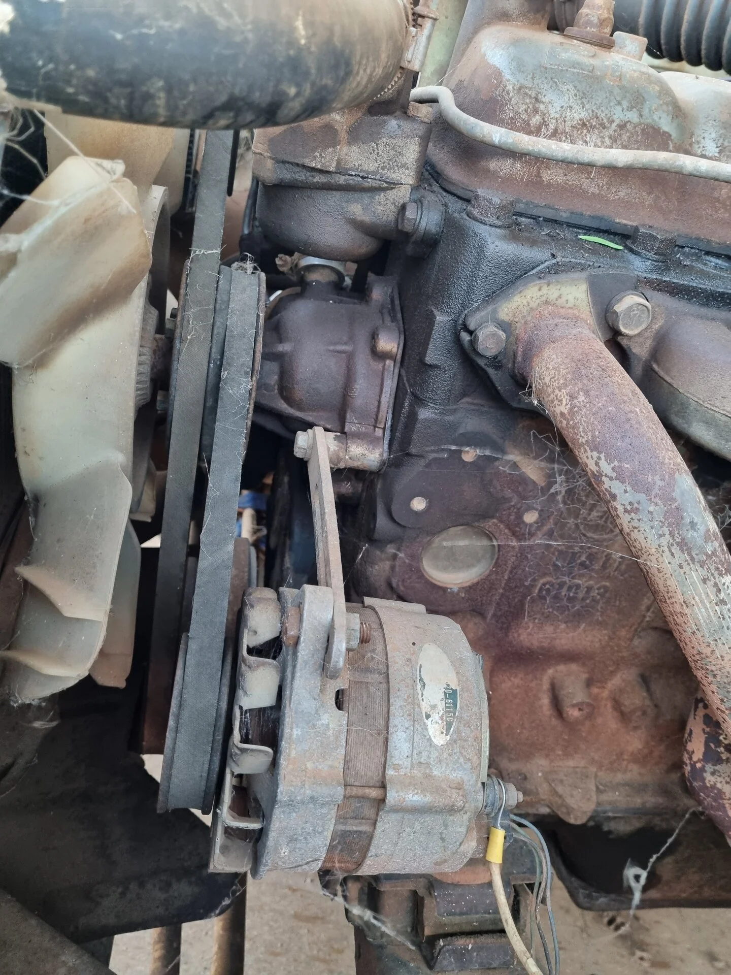

I thought I read somewhere that I can use the 60 power steering setup on the 45. If that's true though, what other parts do I need to swap besides box and pump? But in saying that, the pump is RH mounted where as so is the Vintage air kit I have. Is there a way to mount the pump on the LH side instead?

Ran out of time deciding what to do (vehicle was parkes in a yard it couldn't stat in) so I leave the axles and only took the Power steering pump and box.

So what I am chasing now is a LH mounted power steering pump bracket.
I'm think thr part no is 44443-60020 but cant find any exact pics to confirm
