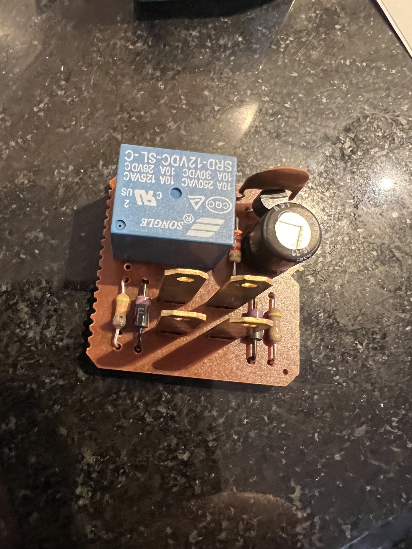

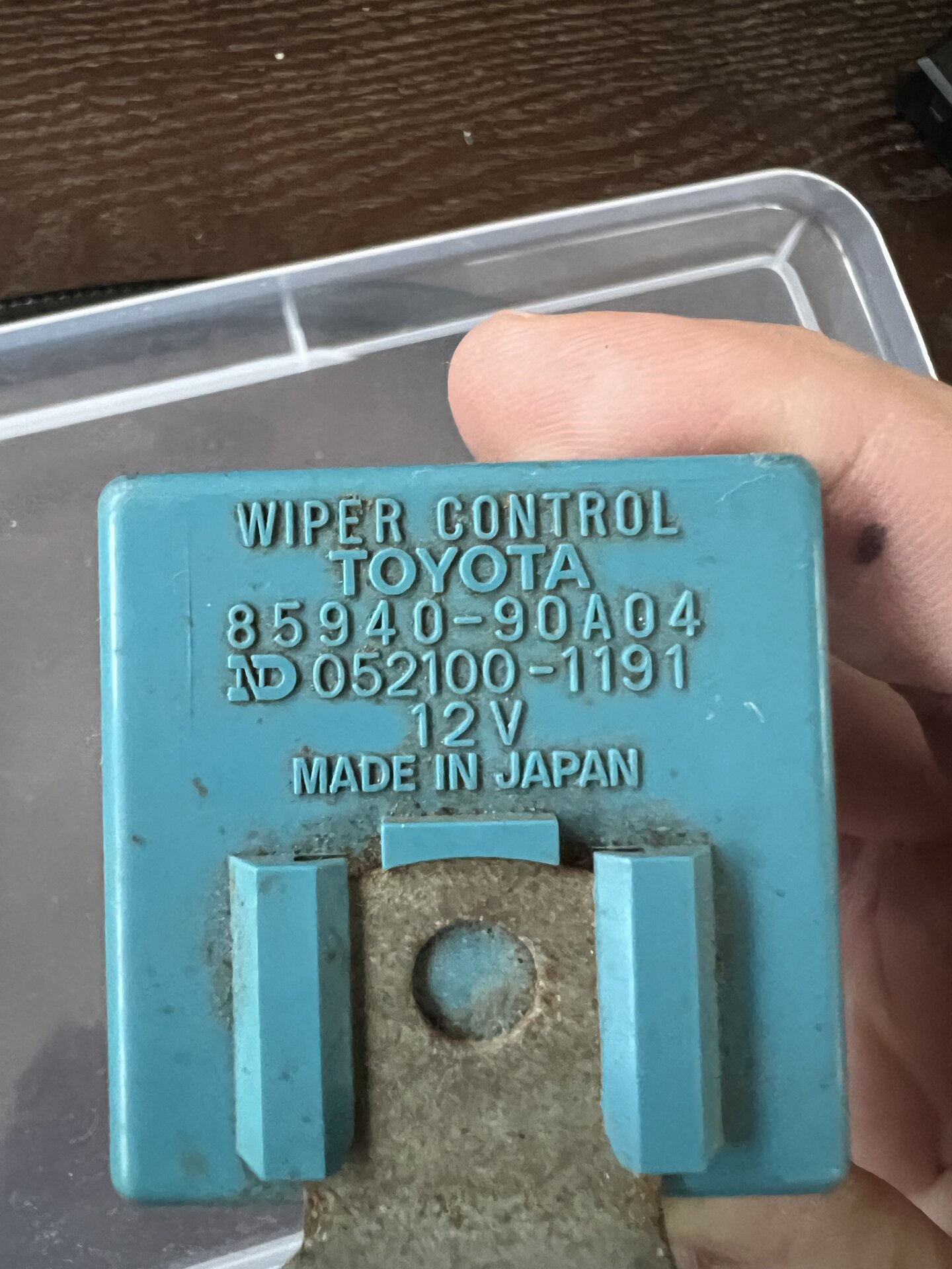

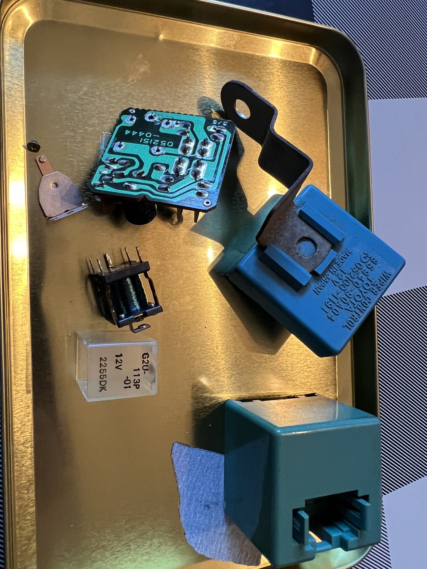

Just an update for anyone who might be trying to get wiper delay working on a FJ60. The relay up under the dash on my 1985 FJ60, i took it apart and the contacts on the relay on a little circuit board inside had welded together. I was able to find a little relay on Ebay that i soldered into the circuit board and it worked perfectly. I bought 10 of these relays for like $10. See pictures.
