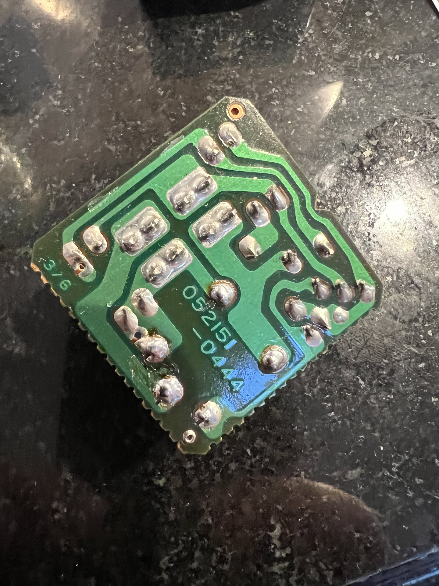

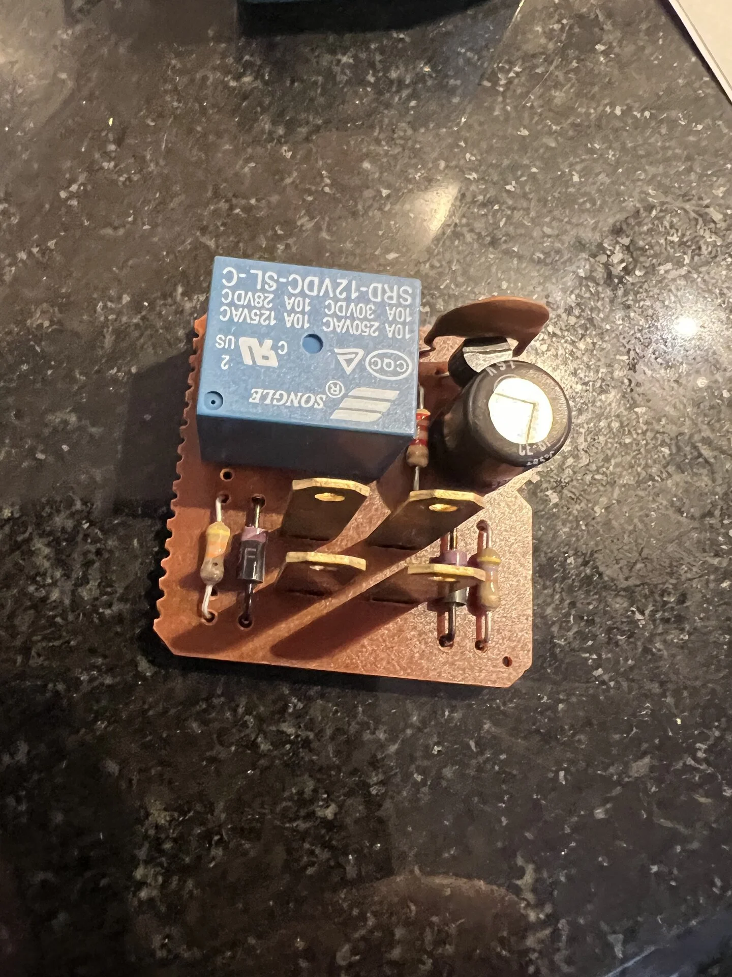

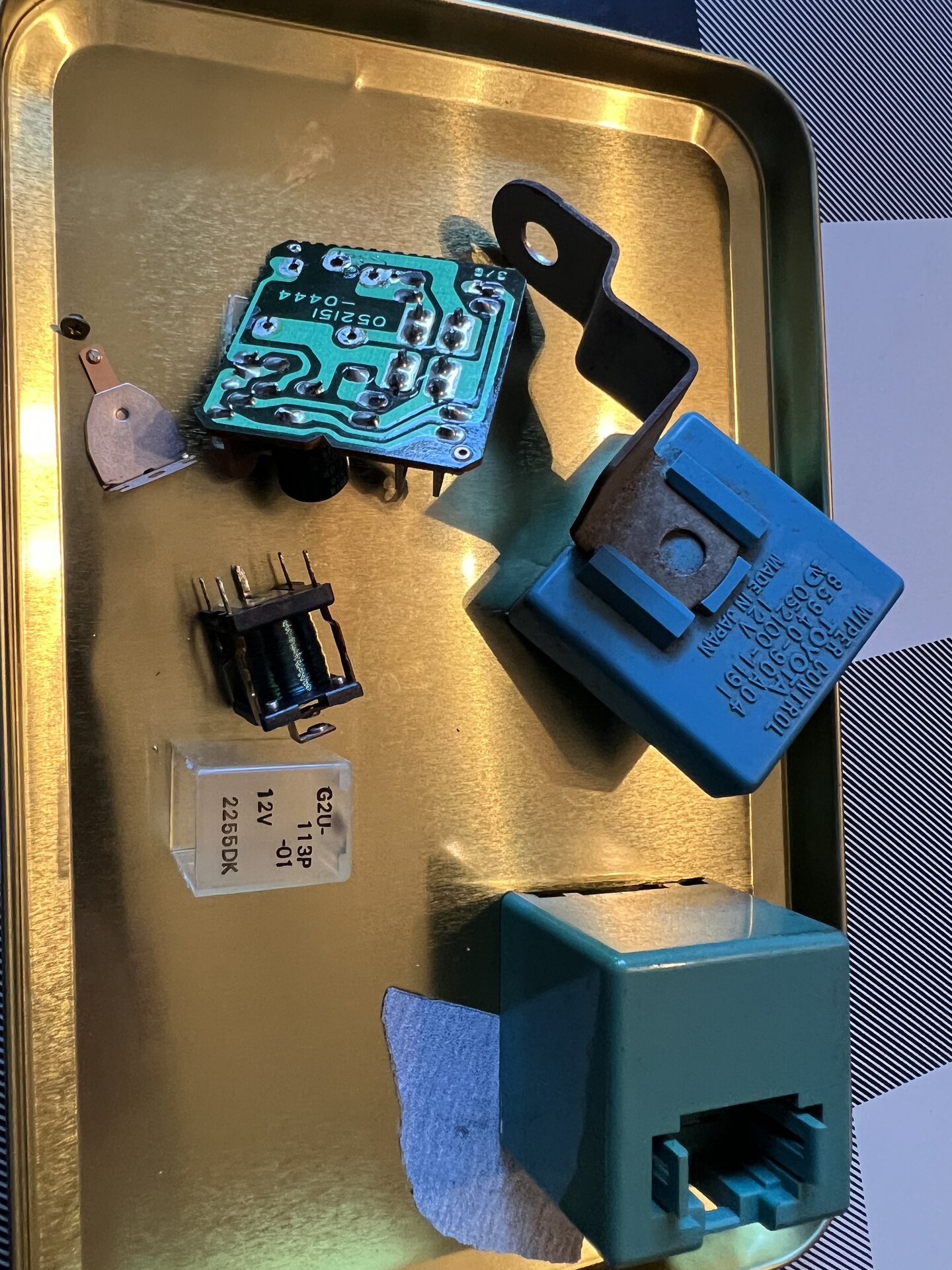

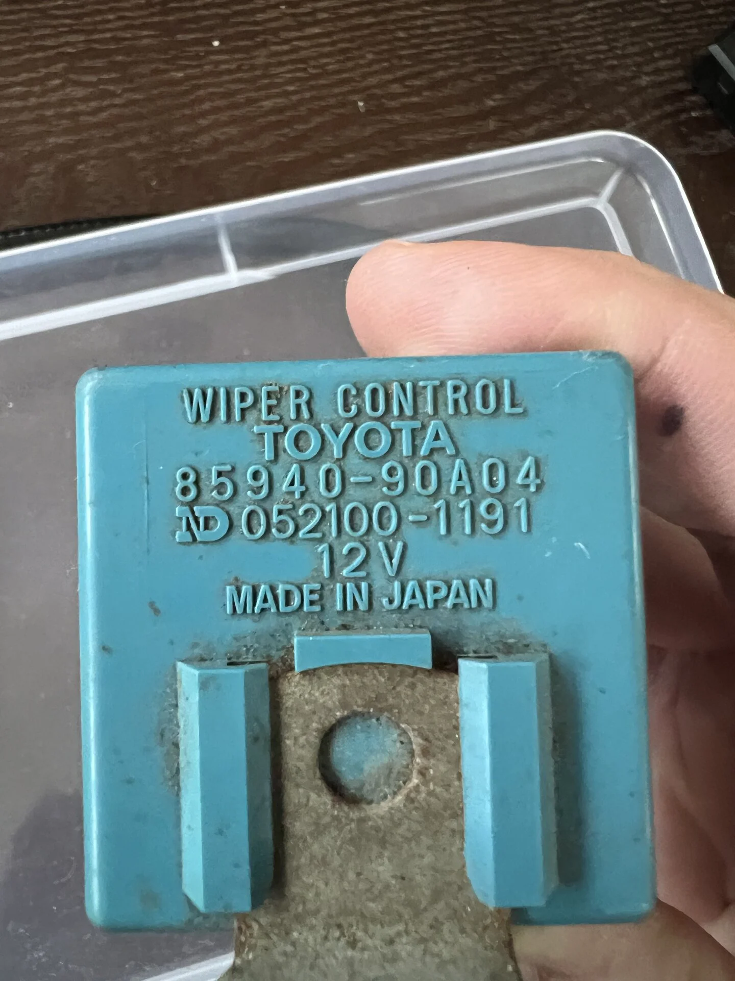

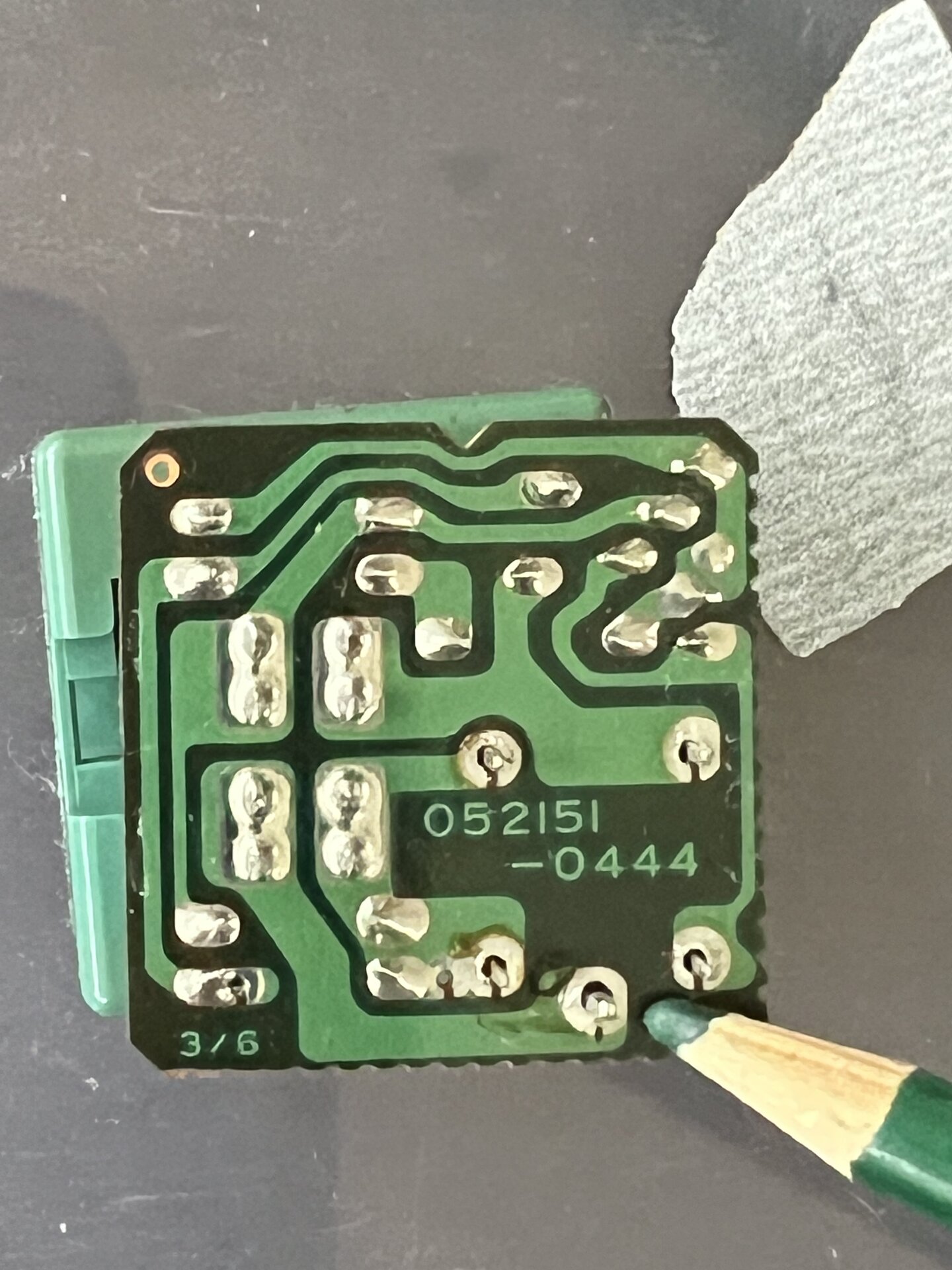

Just an update for anyone who might be trying to get wiper delay working on a FJ60. The relay up under the dash on my 1985 FJ60, i took it apart and the contacts on the relay on a little circuit board inside had welded together. I was able to find a little relay on Ebay that i soldered into the circuit board and it worked perfectly. I bought 10 of these relays for like $10. See pictures.
Can you please detail the part you bought on eBay (assuming it still exists) and where you did the solder repair? My relay failed this weekend and I am evaluating repair options in lieu of spending $200 on a used part on eBay.
