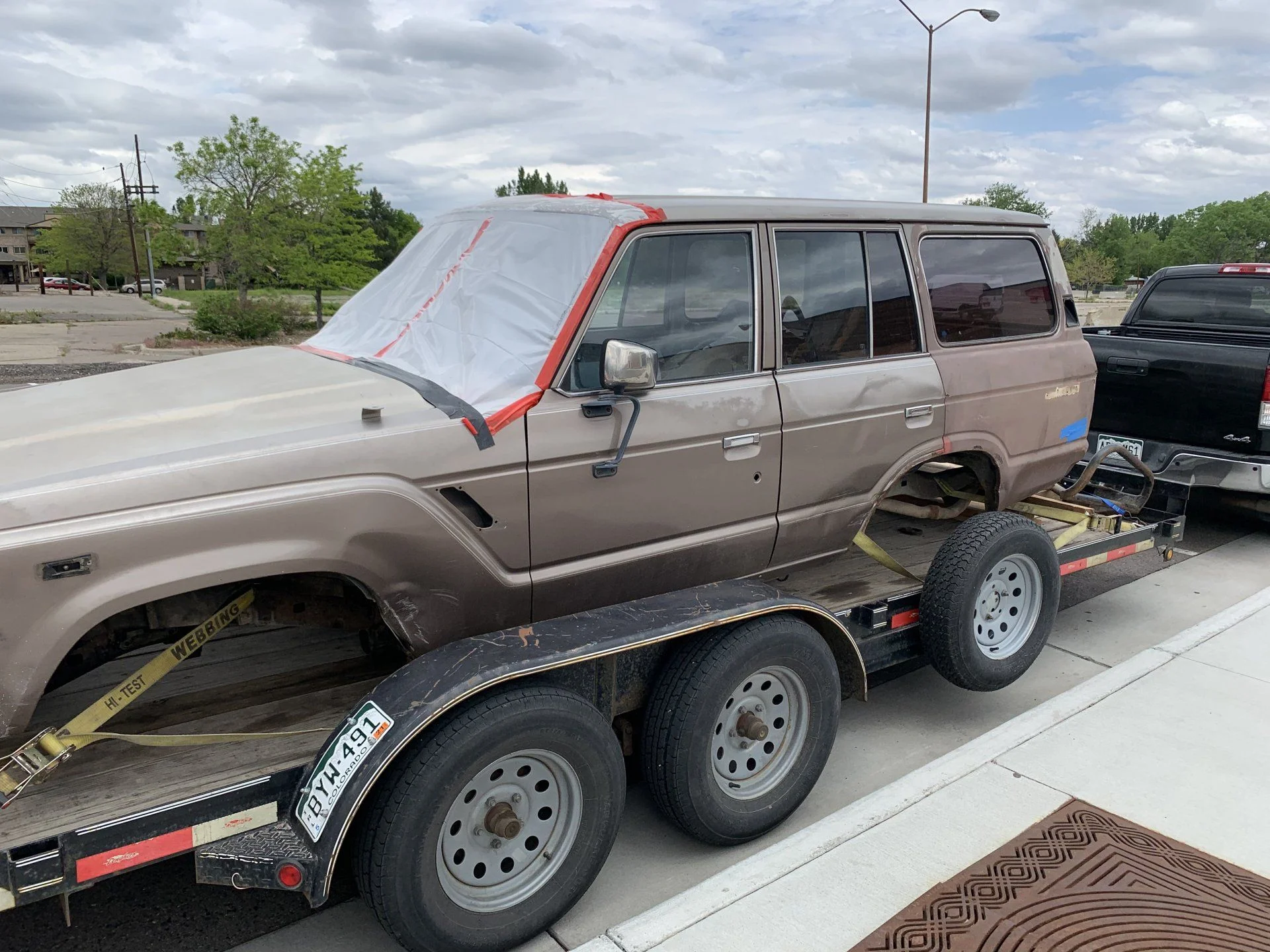

I picked up this beauty. (well its a bit rough, but pretty to me)
Basically just a body and frame...
Going to be robbing parts from this... Has and light engine knock so it will be getting a different power plant.

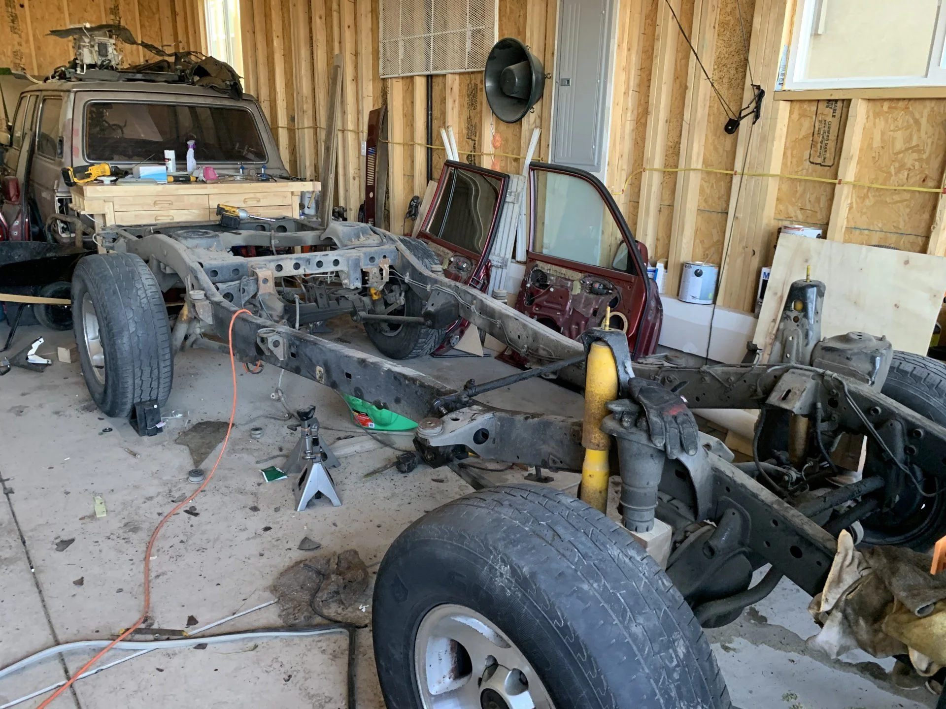

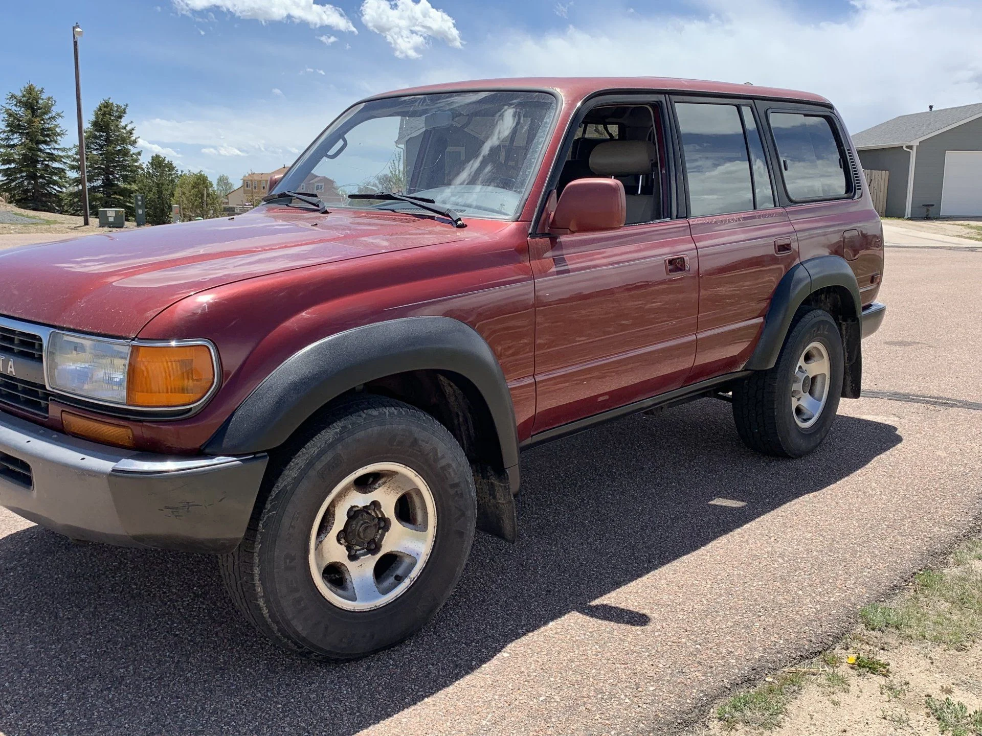

Been parting out the 80 but made some progress taking it down to the frame. And man I made a mess. Lol.
I haven’t decided if I’m going to cut the 80 chassis and swap it in or cut off the mounts and weld them in. I’ve thought about going with leafs in the rear and radius arms in the front. Not sure yet. It will get some sort of V8 power plant. Also going to be crafting in the 80 dash and HVAC components. So that will be interesting.
