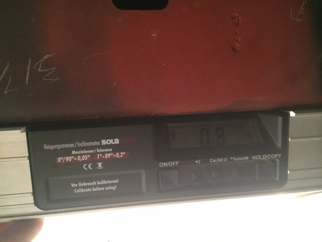

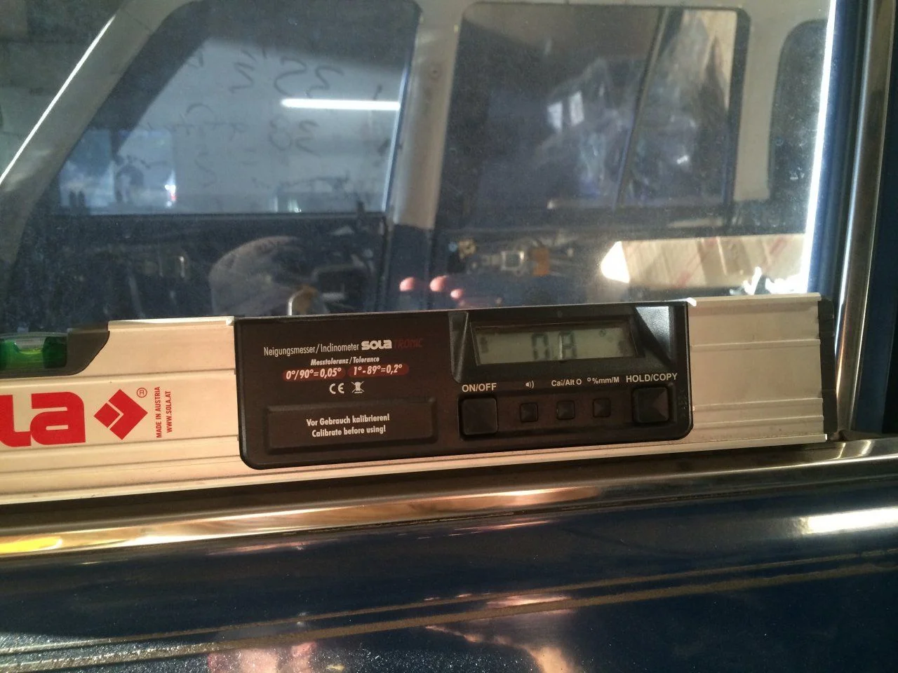

Now that it is nearly done I am very curious how it will sit with weight on it. All the other FJ60/62 to FJZ80 mash up I have seen the body is mounted on the frame with stink bug built into it. As I mentioned before I didn't do that, I put the body on the frame level or nearly level. At the back where the wheel well is and basically what decides how low you can go on the frame with the body I gave it a 1/2-3/4" body lift. From there I kept the body level rather than tilting the front end down. I only have a .15* difference between frame and body so it's level on the frame. This leaves it with a 2 1/2" body lift up front though where the rad support meets the frame. Now I have no worries it will sit right and won't look funky. However, I think that the Slee 4" coils may be to much without say 37's. It is looking like I could easily run 35's with no lift or with a 2.5" lift. To me this is great even if I want the Slee coils under it, reason being less lift = less geometry out of whack in the suspension. I also have tons of room for a flat belly, exhaust routing (can even easily retain the stock exhaust shileds) , headers, a huge fuel tank in the back and easy to get at the top of the rear shocks. So I am happy with it. I did go back and forth on this, if I should set the body up level or slant the front down like others have done. After a discussion with my buddy who is far better at all this than me (he is also my mentor) I went with body level on frame. With some many coil spring options out there for 80's it just seemed like the right way to go. I also really hate stink bug on my Cruisers. I was curious yesterday so slapped some stock coils in the front and of course since there is no weight on it there is no difference right now over stock coils or Slee 4" coils. Remember folks, springs are rated in ftlbs per inch. So with no weight they are all the same, it is when you weight them up that matters.

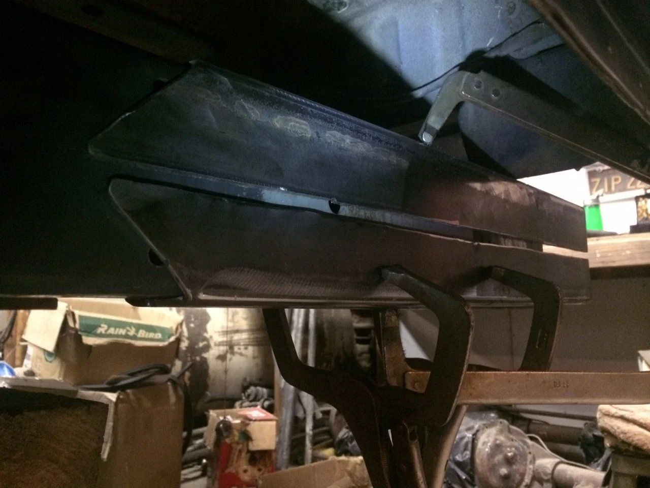

Last two body mounts are built, frame rail extension is done too. Now it is time to pull the body and do my final welding on all this, slap the body back on and then I think it is time to wash it. It hasn't been washed since 2011 when I got it!

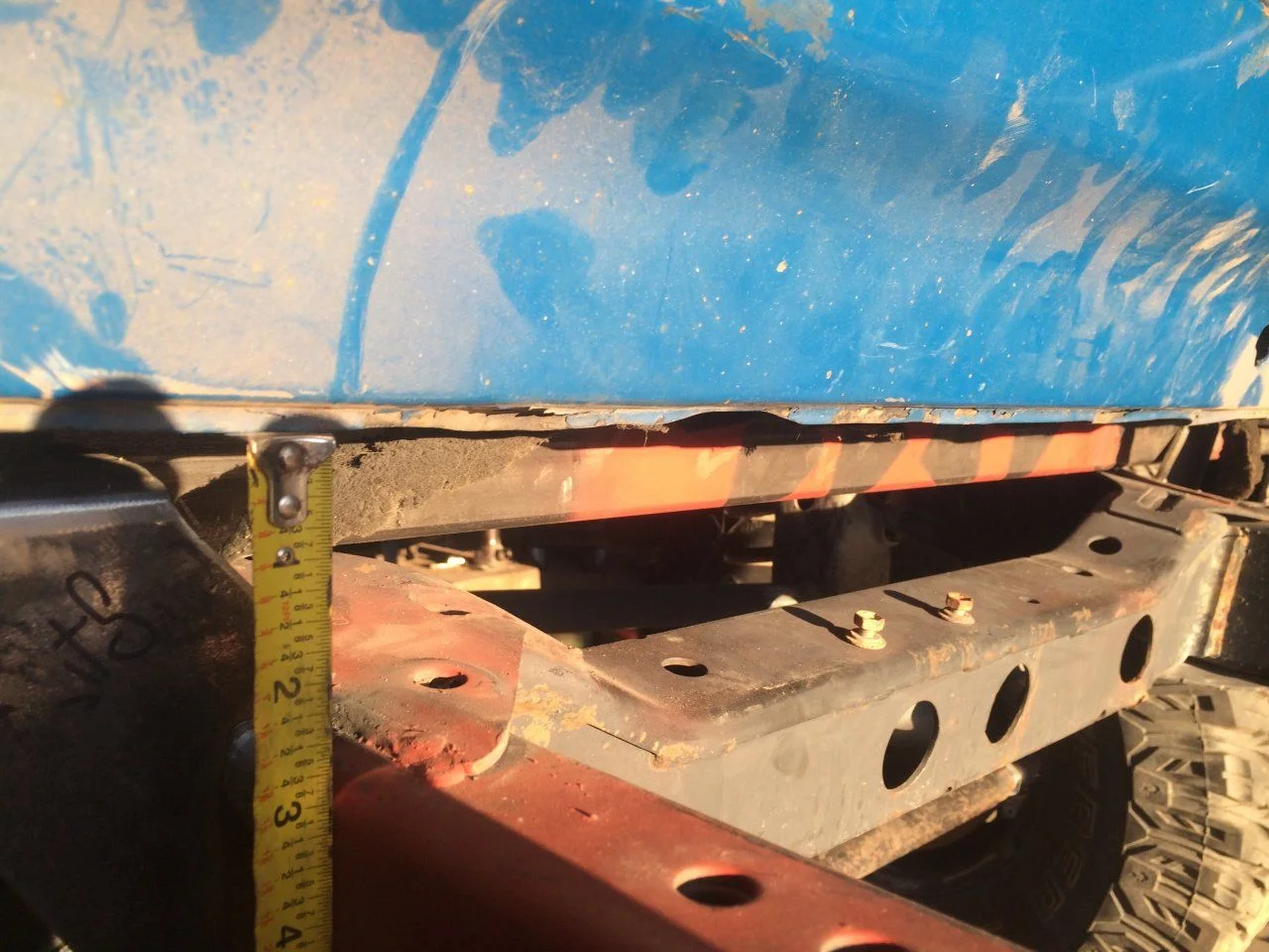

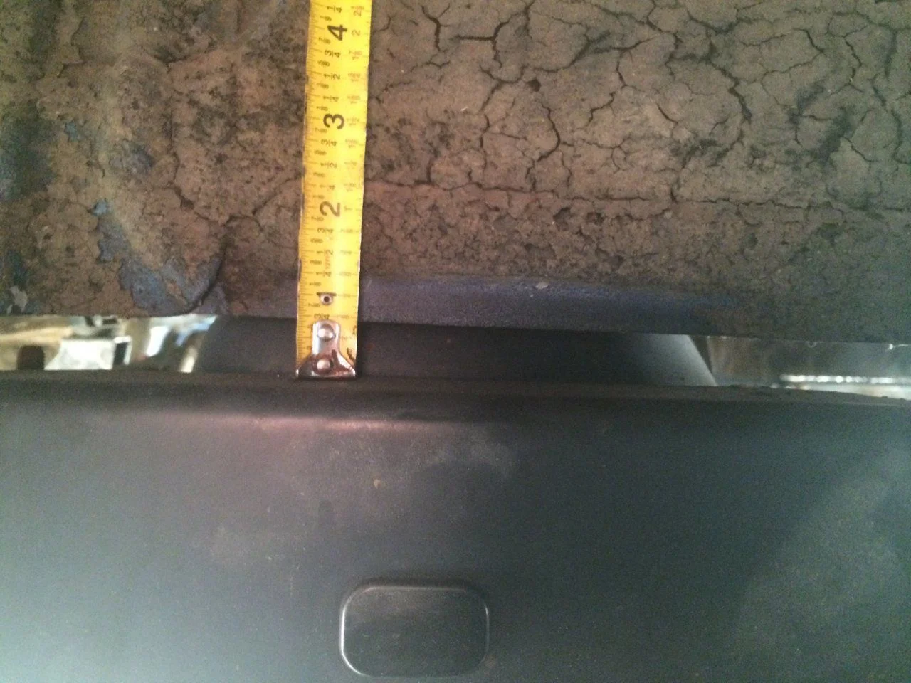

Here is what I am talking about "body lift"....
That is 3/4s of an inch above the frame rail, so really only. 1/2" body lift here.
However with the body on the frame level that gives you an approximate 2 1/2" body lift up front.
These last two pics you can see the body is spot on level with the frame. As mentioned I put stock coils in the front and have about 500lbs sitting in the engine bay. The shop floor is slightly higher in the front of the truck due to floor drains. I am actually really happy with how it has played out and am feeling it will look great once a power train is in it.

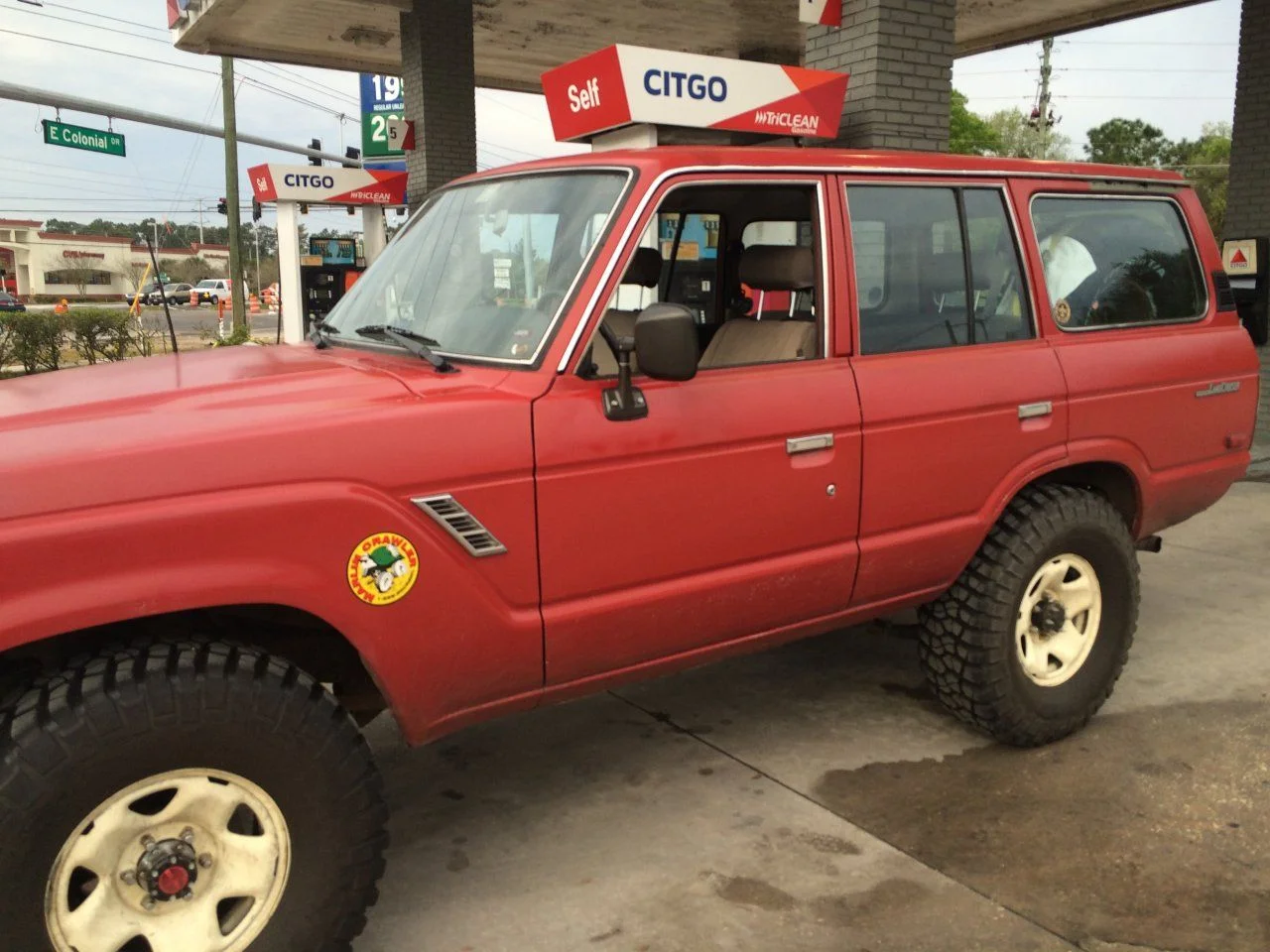

Tacoma wheels have 5.5" of backspacing and are what I run, I have an 80 rear and anything with less backspacing sticks out way too far IMO. Yours doesn't look bad because the front matches at least.
@cruisermatt got a part# for them wheels?
Ian, too bad you have to sell it....
Hope it finds a home real soon....
Good luck with your new endeavors
Frank
All 6-lug Tacoma wheels should have the same backspace, these are what I'm running though. They're the steelies that would come on a "base" model. 16"x7.5". Just be aware most tire places won't mount 315/75/16 like these on them because BFG wants an 8" rim.
