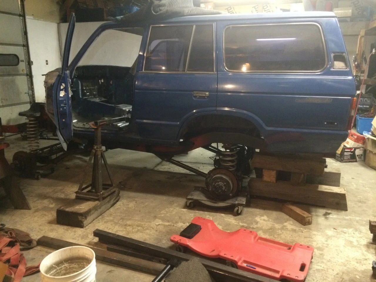

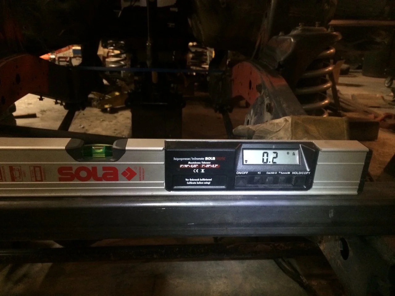

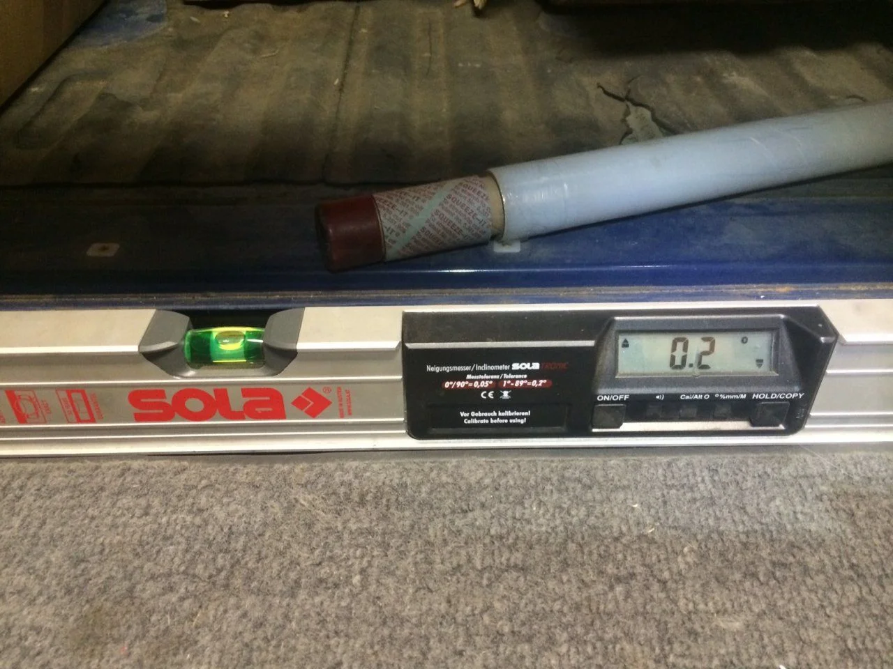

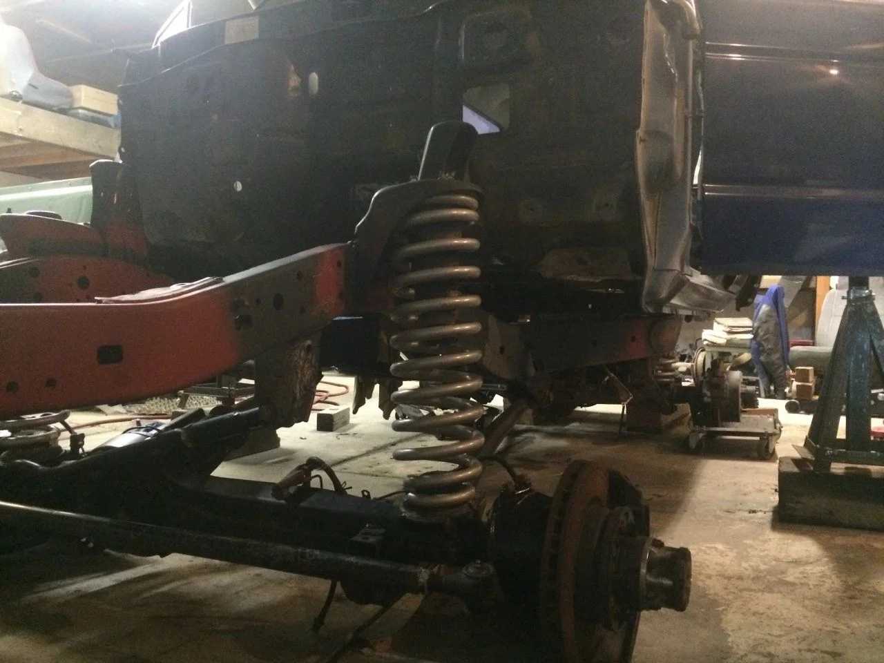

I got the chassis under the body, no wheels. No way that was going to happen even with no coils in it. Just don't have enough crap laying around to build a bigger pyramid! So I pulled the wheels and set it on my wheel carts, slide it under and then stuffed the Slee coils in it. Without even trying on an uneven shop floor I am already only off left to right by 2/10s of a degree! Stoked on that...

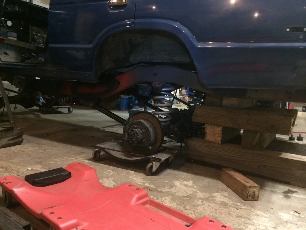

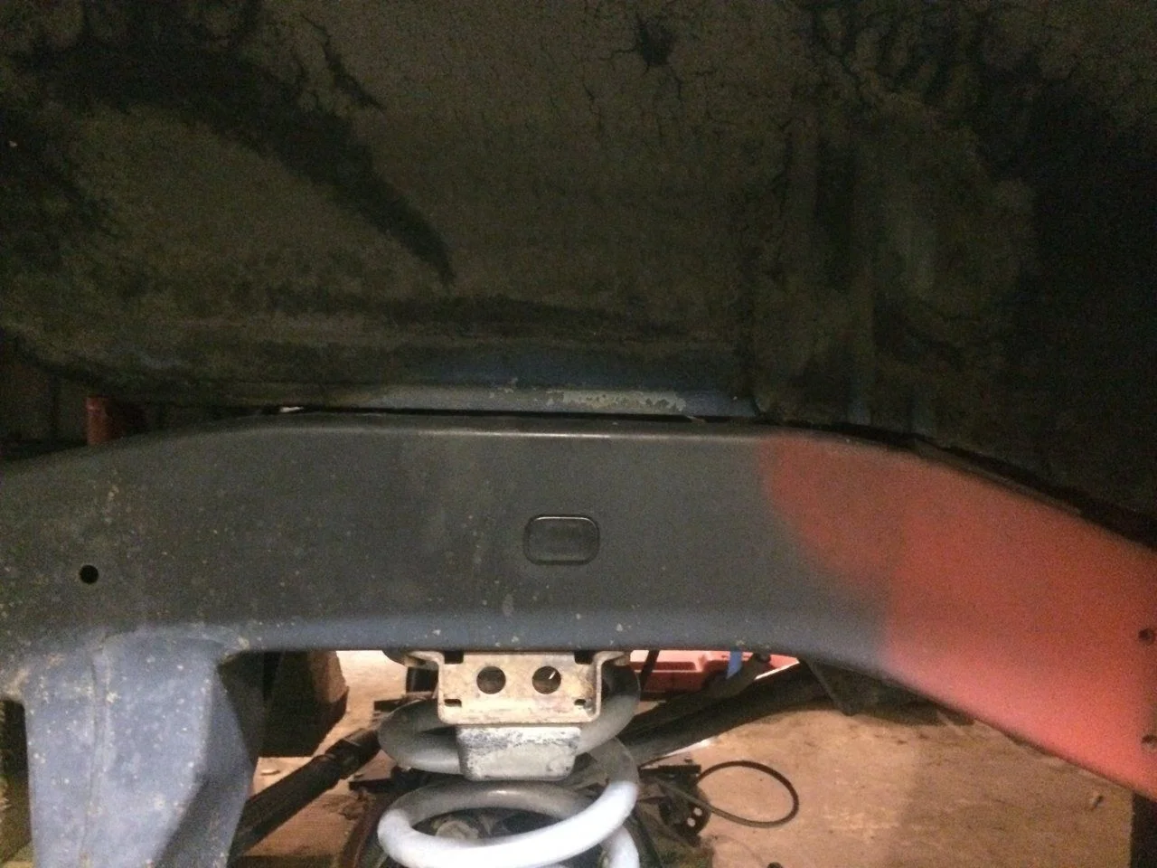

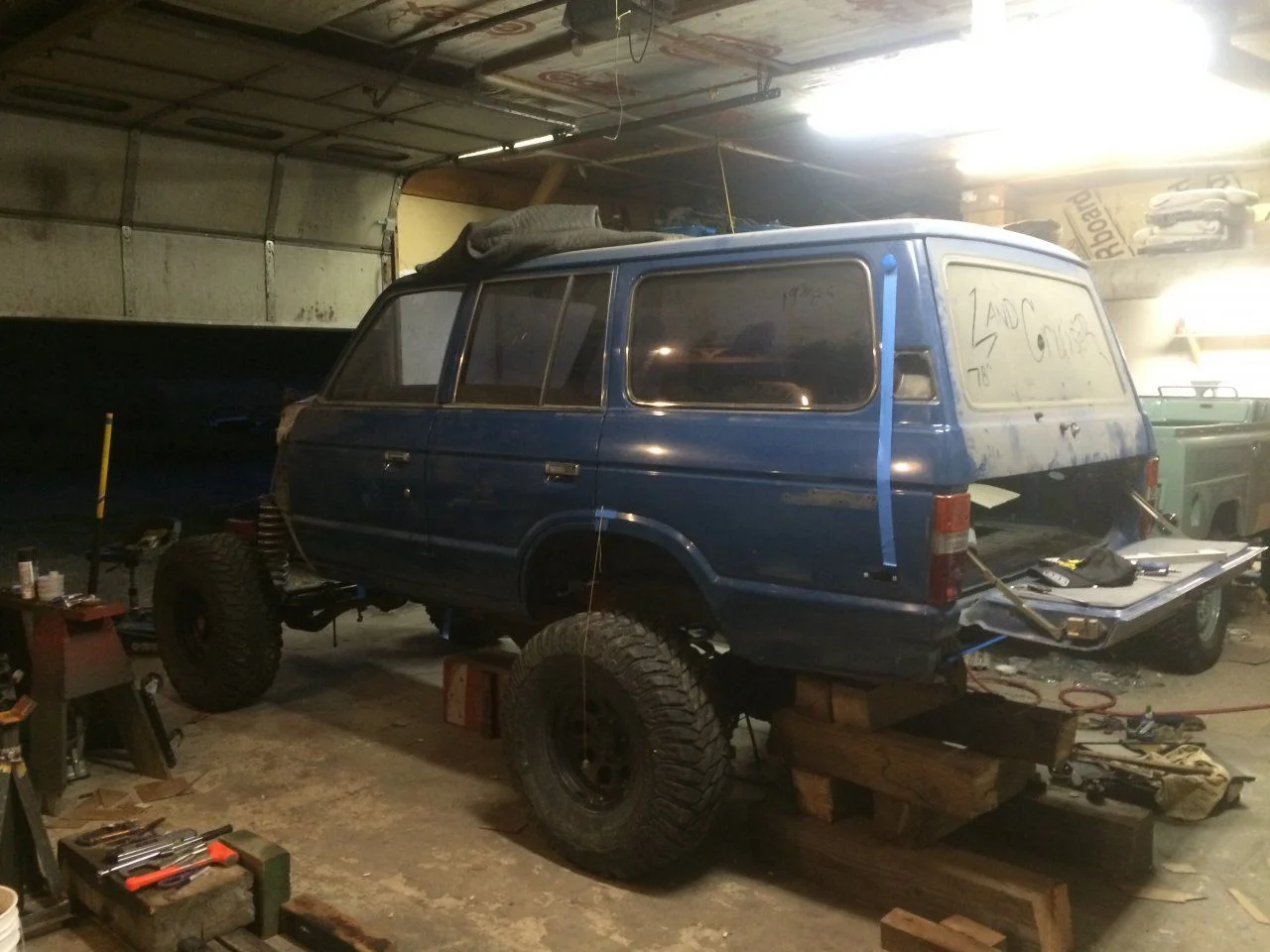

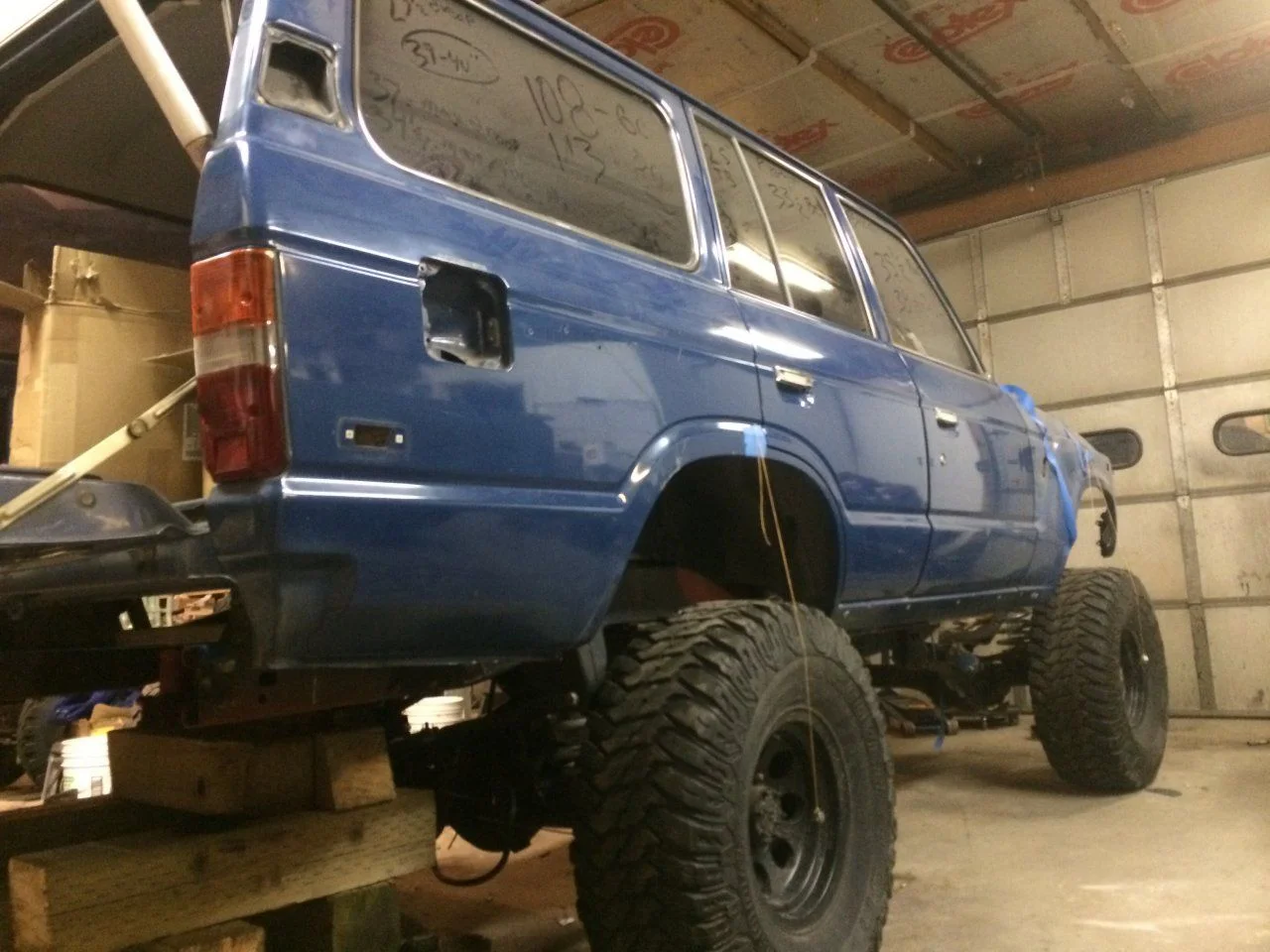

I got to say, when it comes to layout and setup on this swap there is one major defining factor. That is as pictured below. The rear wheel well pretty much determines everything and the rest is setup from there. Unless you are going to cut the body which I am not. The pinch weld or seam here is not going to change and so I started layout here and am squaring up the rest of it from this location.

After a lot of playing with set up I finally got it where I was happy how things are sitting. I went ahead and raised the body 1/2-3/4" from what is pictured above. My only reasons being; it was easiest for set up, it gives lot's more room for exhaust and makes things like installing rear shocks much easier. In the end it may also not need any spacers in the coil springs since I have added a small lift int the body mounts. All in all after much time spent on layout it is square, level and ready to build mounts. I already have the first set of mounts done and by the end of today I plan to have the truck sitting on wheels. I will need to pull out the chassis one time only to final weld up my body mounts and a few other things at the back of the frame.

looks real good, well done!!! So that seam in the rear wheel well is hanging above the frame?
Is the 8 frame wider than the 6 frame at this point?
Thank you! Yes you are correct, rear wheel well and yes the 80 frame is wider here. The body must sit above the frame rail.

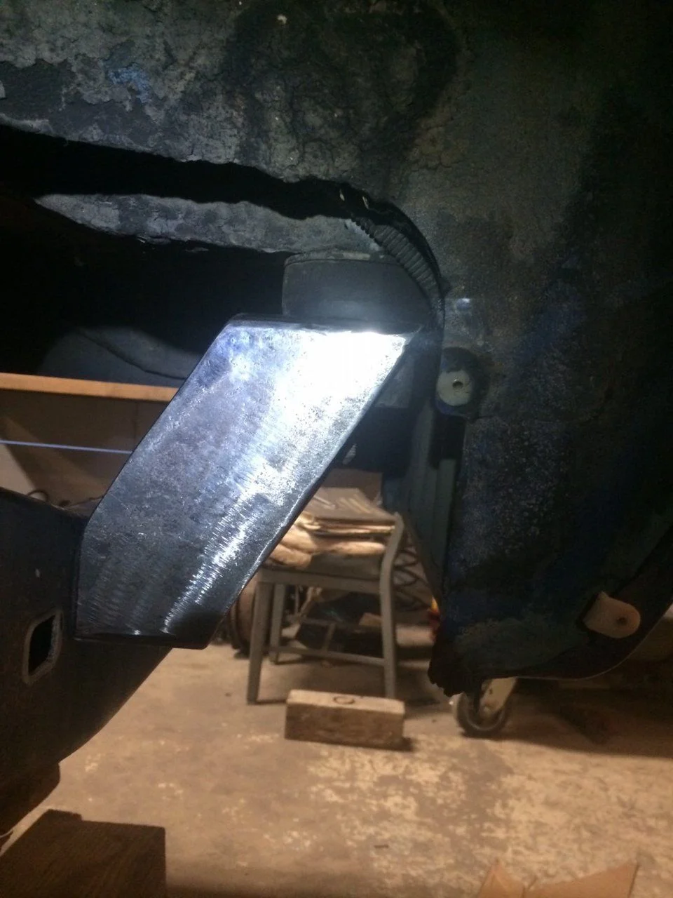

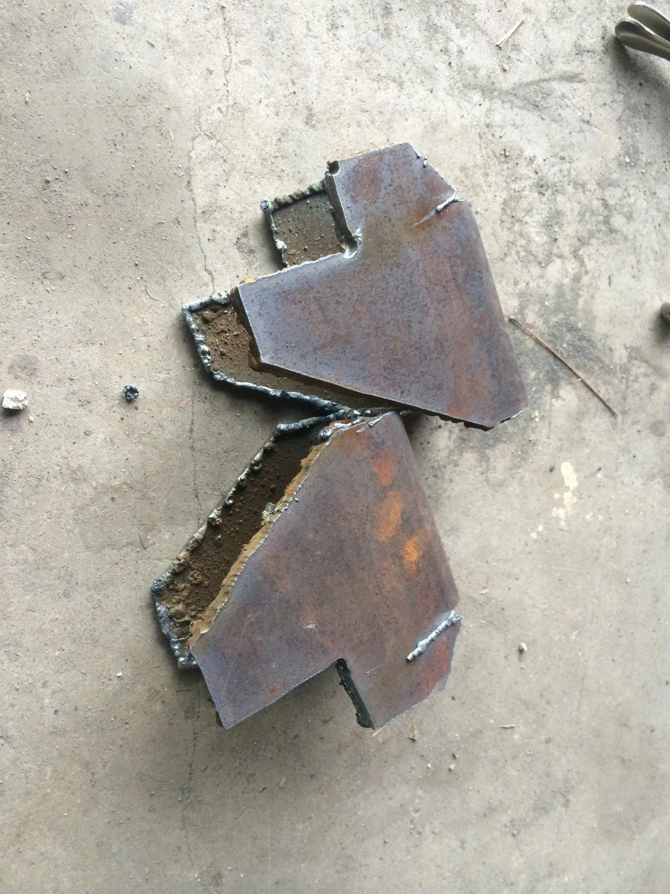

I just plasma'ed out the second set of body mounts, letting them cool before clean up on them. And yes I am using CAD to build these! ;)

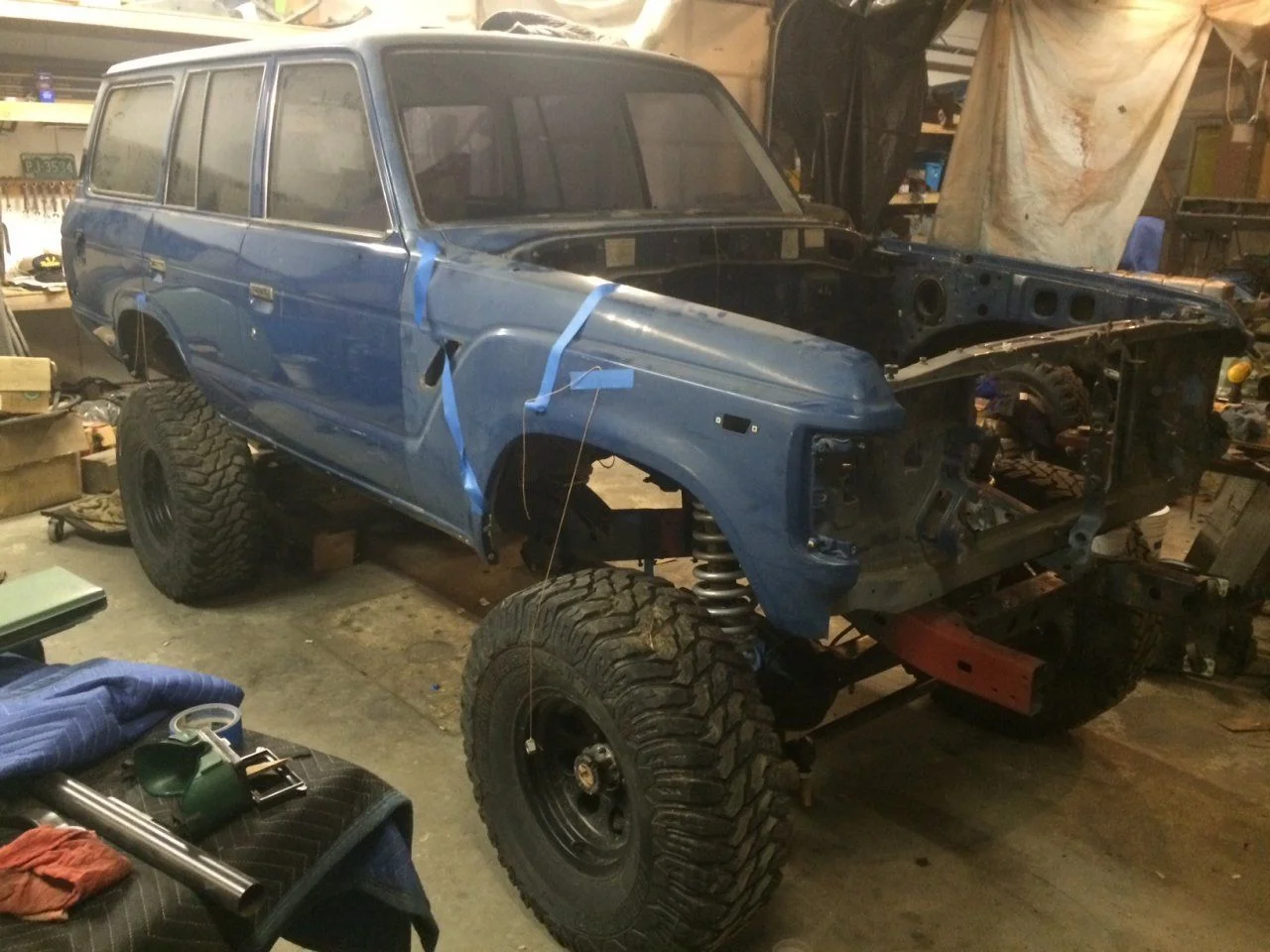

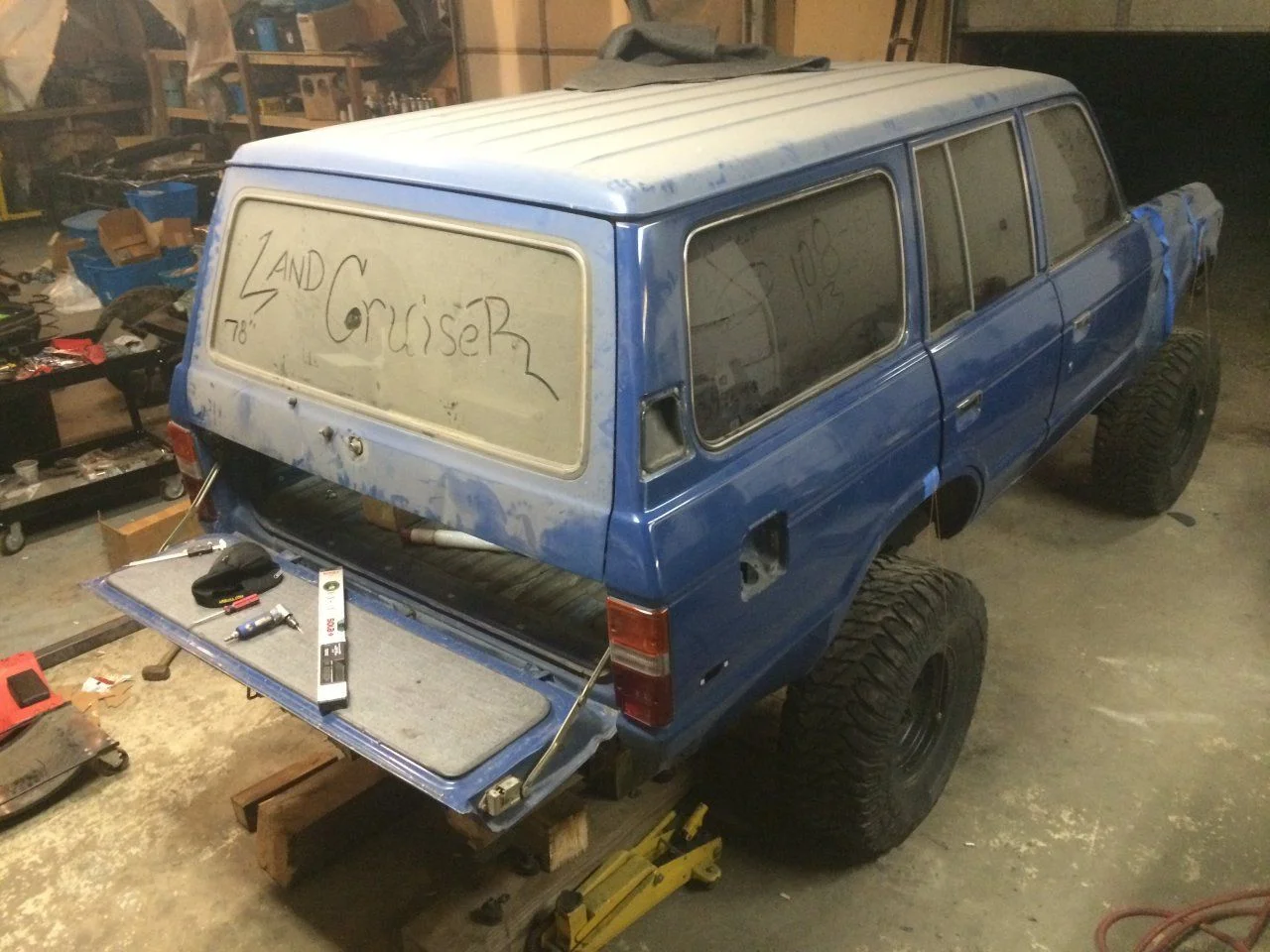

I am standing here after a 12 or so hour day in the shop just drinking a beer and staring at the new creation. So here is a few more pics!
Pretty friggin stoked!

Dude, looks awesome. The SLEE 4" look perfect for a set of fat 37s.. What size tank are you wanting to squeeze under there?

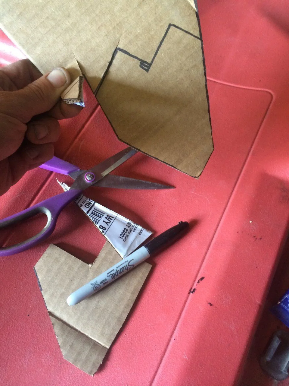

Wait...CAD? I thought you were using the same system I use - CSS?
You know - Cardboard, Sharpie and Scissors!

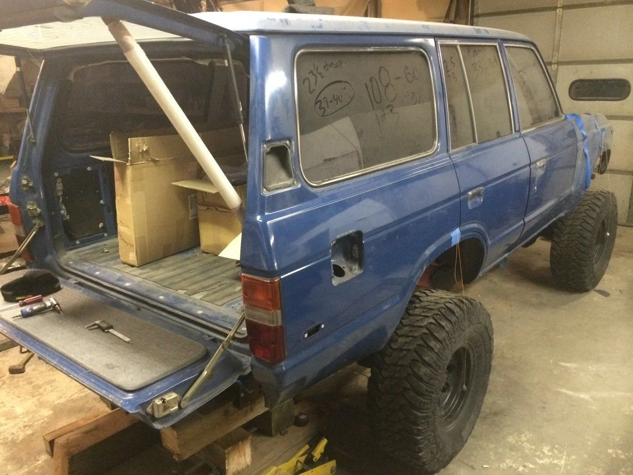

I did a little more last night so here is a couple pics. I need to build front body mounts, extend the frame in the back and build the farthest back body mounts. Otherwise it is a done deal. I plan to get that plotted and fabb'ed up the the body still on it so I only have to pull the body one last time.
Ya it would take 37's I think no probs. There is tons of room in the back for a fuel tank, easily 40+ gallons. Looks like you could fab up a lock box too or mount a safe right where the old fuel tank access hole is at.

Damn looks real good dude. So how high is the lift overall? Equivalent to SOA? Slightly lower?
Here is the thing, they are coil springs with no shocks right now. Only weight on it is the body and frame which really is not much. It is tall, real tall, the sill is 30" off the shop floor. It looks like a SoA 60 on 37s standing next to it. However, the coils are going to go way down, like probably 6-8". I am 165lbs and sitting on the tailgate it drops 2-3"! What is nice about coil springs is they are very easy to play with compared to say leaf springs. It it needs an extra inch in the rear just slap in a 1" spacer. If it is to tall overall, drop it down with an OME 2.5" lift, if a guy wanted it much much lower, fit stock coil springs. MetalTech makes spacers as well so there are a lot of combinations a guy can play with including air bags. I like coils a lot better than leaf springs for these reasons and a few others. ;)
It is currently about 3" outside the rear wheel wells with the tires. With a different tire & wheel combo you could easily shave 1-2" per side. Or leave it nice and wide and get some big flares or do some trick bar work that incorporates flares into them.

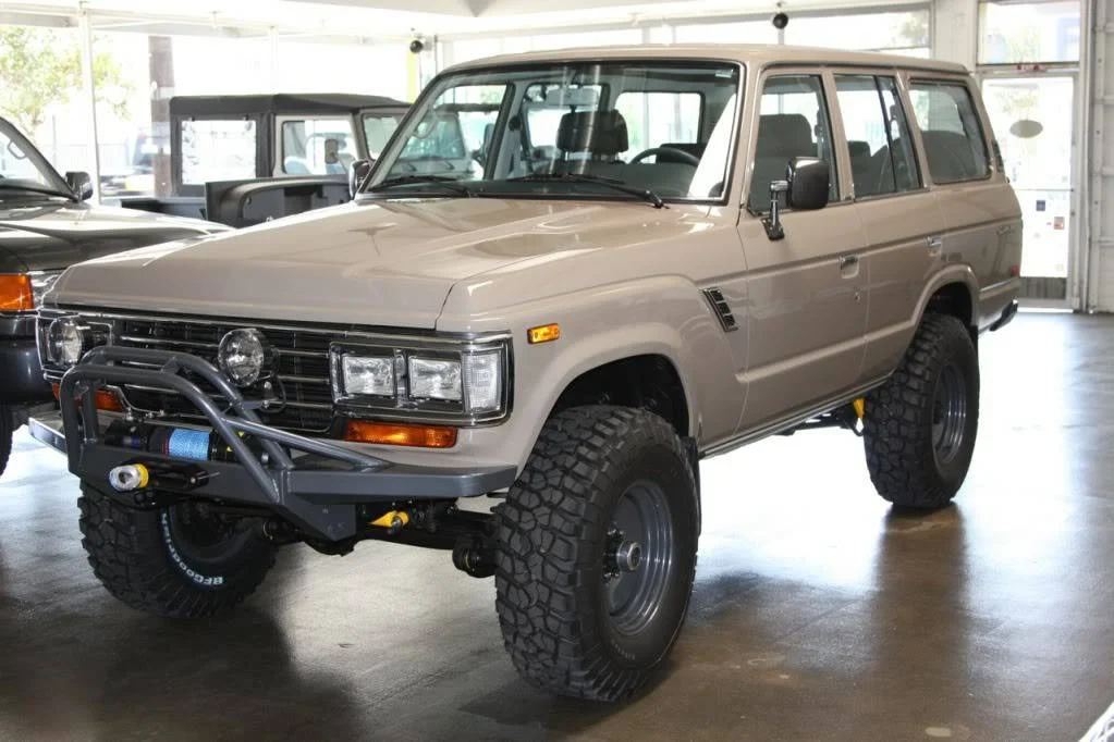

Just for reference, here is a 62-80 mash up TLC did that looks to be on OME 2.5" lift and has skinnier tires and wheels.

I am just happy I nailed it as far as level side to side, square and centered. It is on the money in this department which took me 2 days of playing with it to get it there and ready to build mounts.
