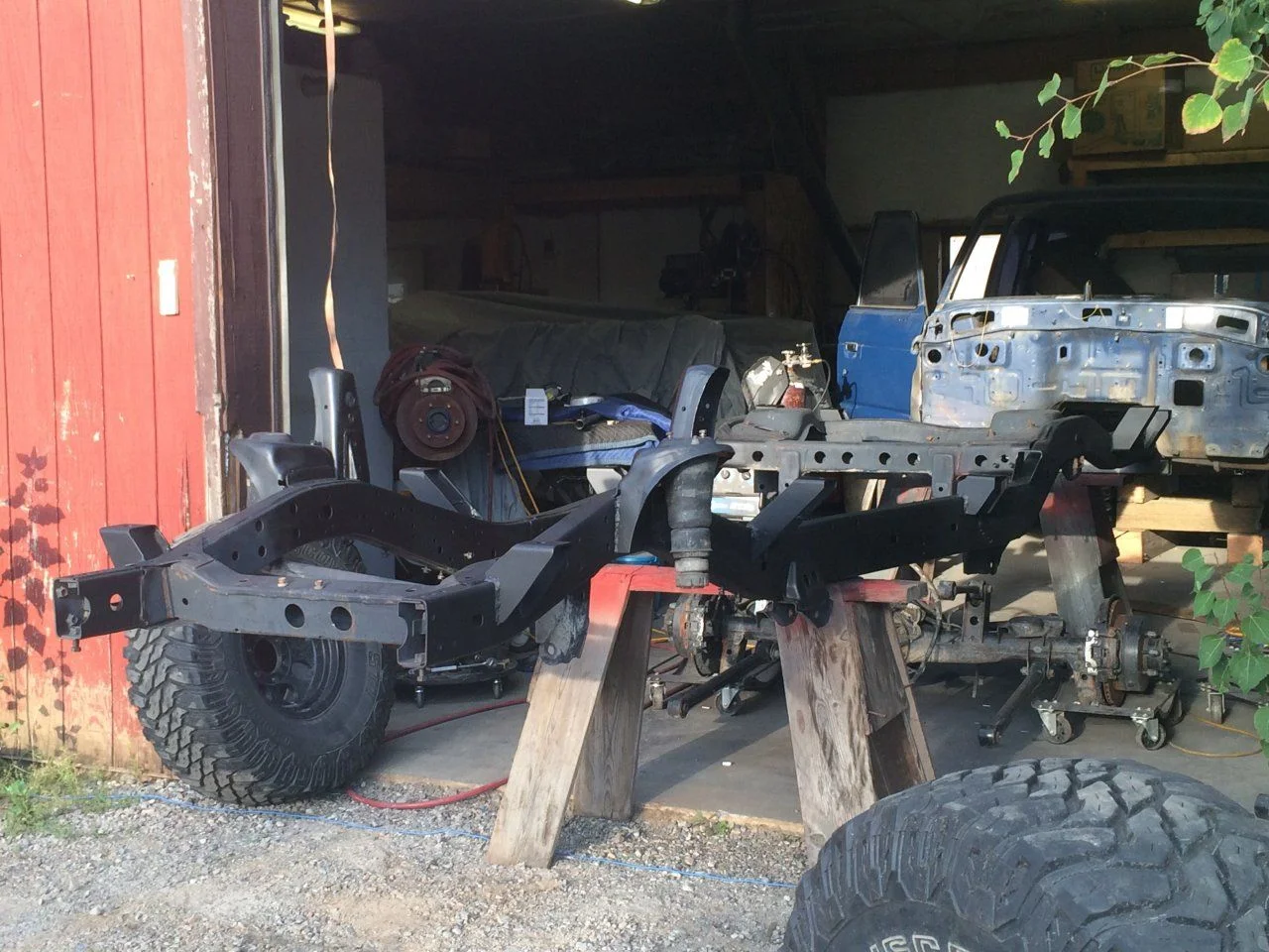

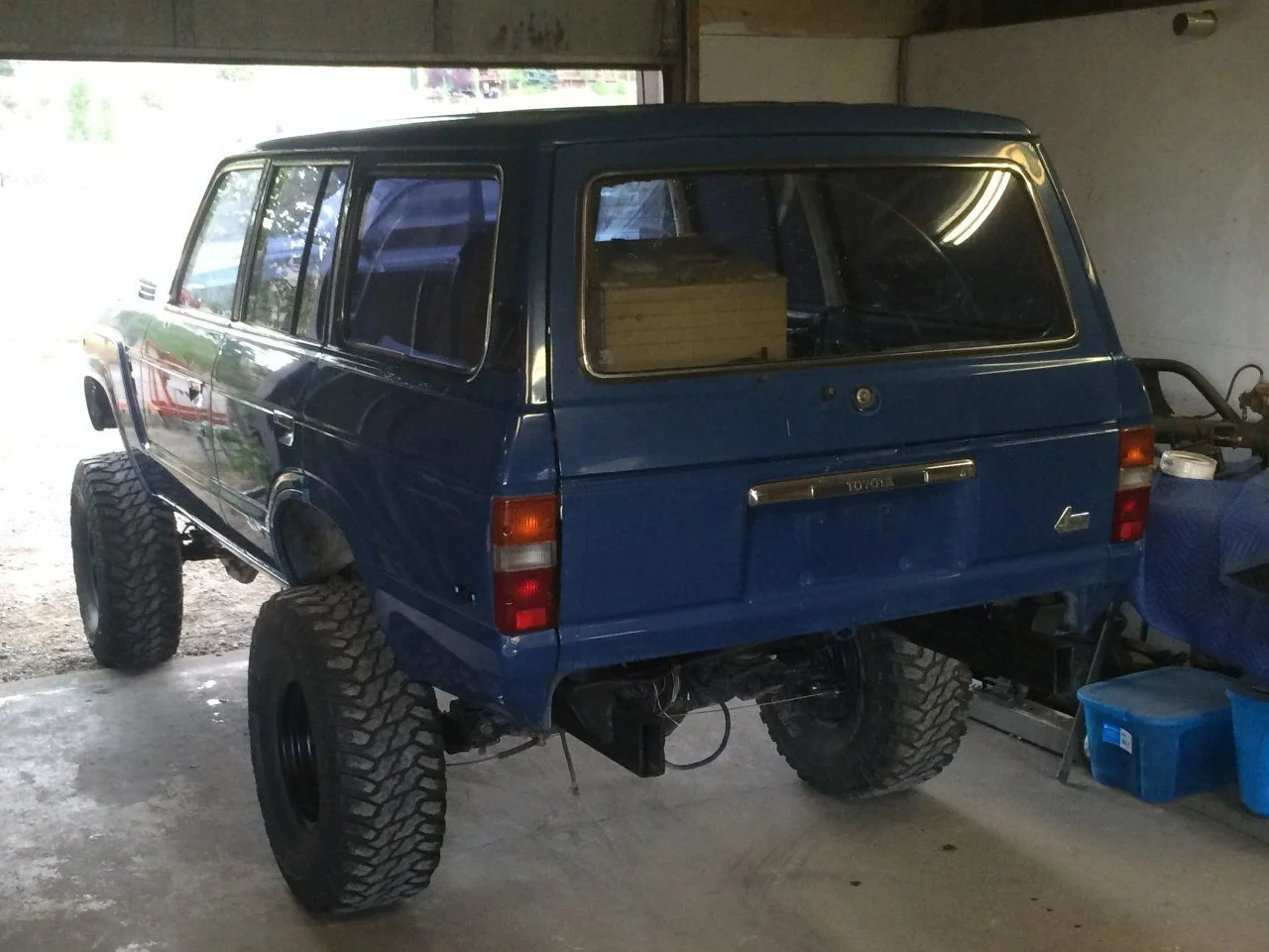

How far I made it last night. The front is mostly done just need to pull the chassis out a bit farther and finish the back.
Cheers

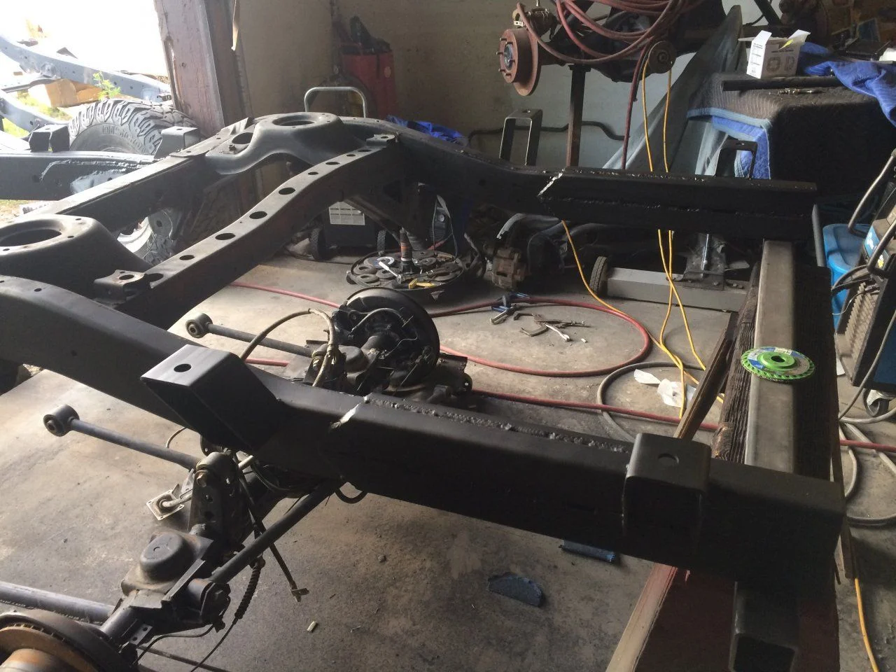

Just finished doing all my welding on the frame. Drinking a beer before a grinder session. :)
Cheers

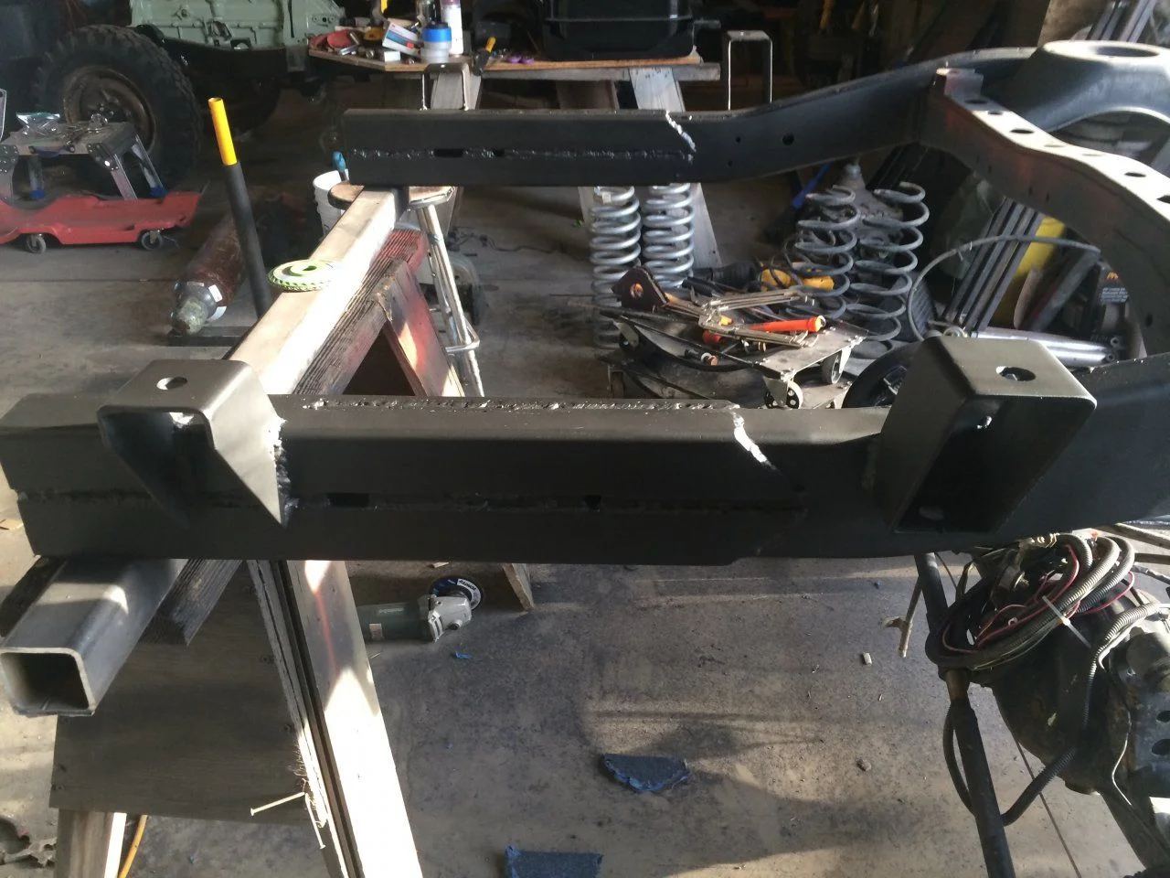

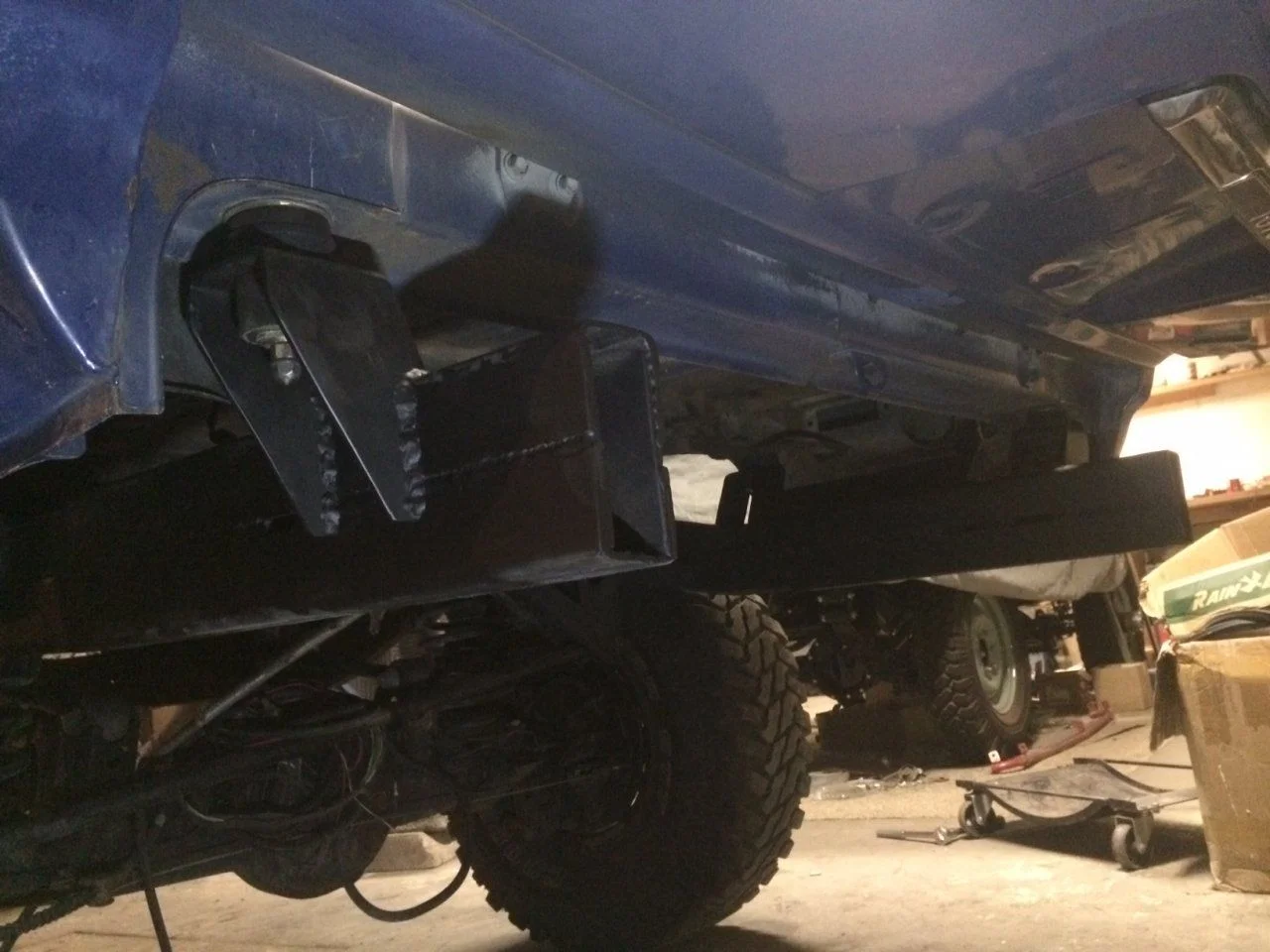

Just about done now, picture of frame rail extension and rear body mounts. Think I will build some mounts for a fuel tank before I do some painting and put the chassis back under it for good.
Cheers

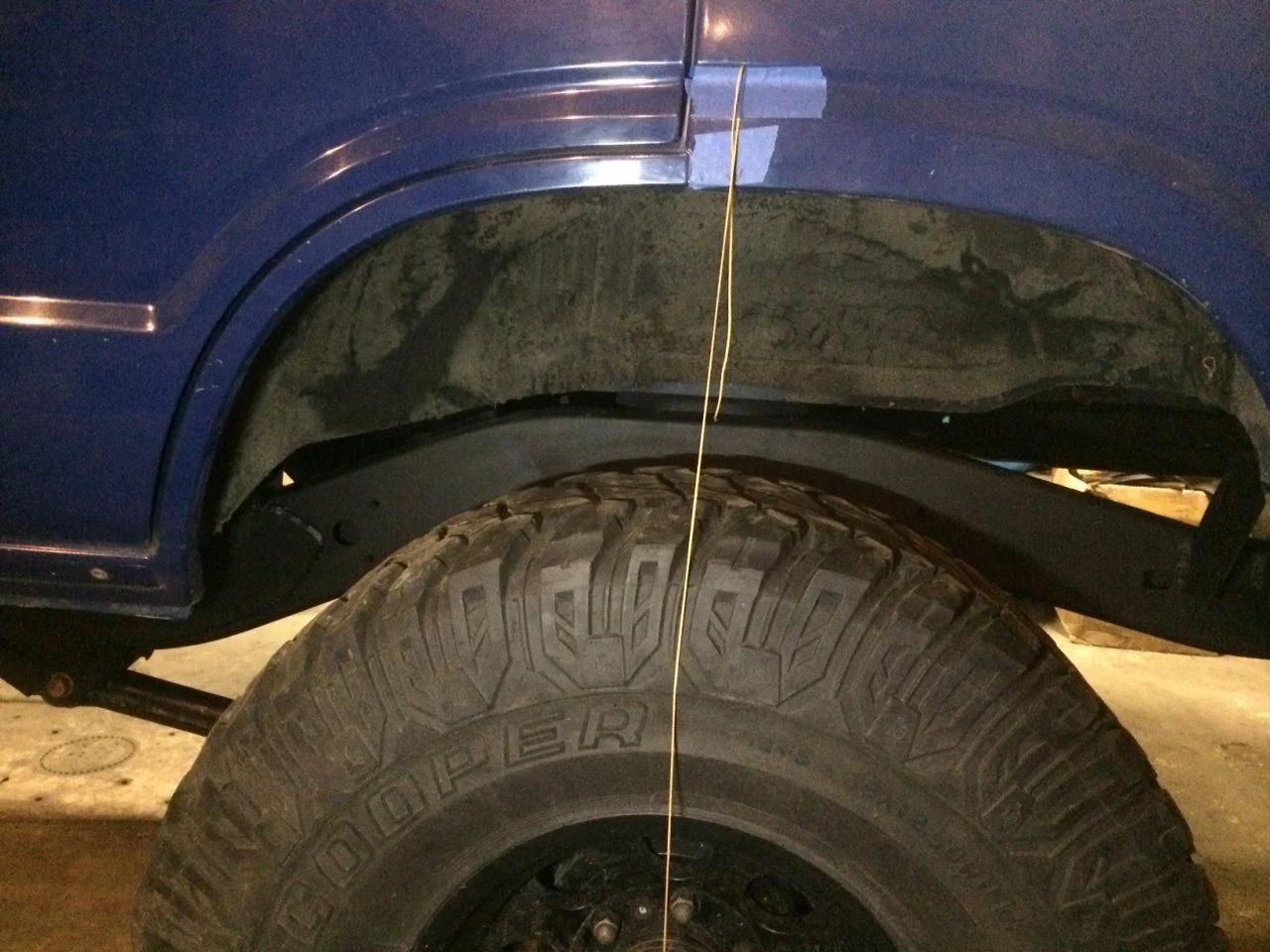

By the way, I triple checked everything at the end of my session tonight for square, level, straight, ect ect. I threw a lot of heat at it the last day or two. It is spot on, I am stoked! :)
Cheers

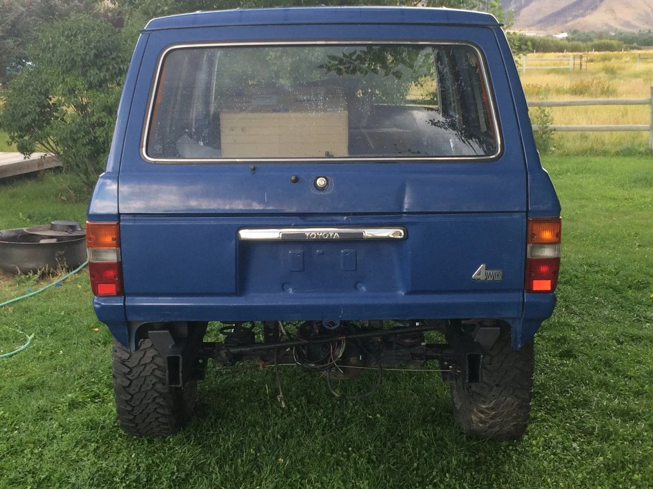

Not getting a wash today but it will get the chassis back under it for the last time.
Cheers

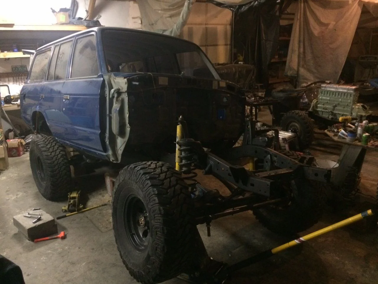

Well I thought I had stock front coils in it, my buddy gave them to me and he said they came out of an 80 he put a lift in. These are not stock coils though, obvious by sitting a REAL stock coil next to them which I unfortunately only have one of.
I do have stock rear coils so I put those in with a 1"spacer. Looks real nice and easily run 35's with no lift.
Getting the wheels on it got a cheesy flex test, haha just kidding! It is going to flex real nice though. ;)
I got some old OME shocks laying around, still somewhat good, so I tossed them in.
Tons of room up under the back for a fuel tank and room to sit up under there and work.
I did the frame rail extension with 3/16's and plated the inside with 1/4". Plenty strong in my opinion. All the body mounts are made from 3/16's except the #2 mounts, I buffed those up to 3/8s! I took all the original body mounts and cleaned them up in the parts washer, all are good and none are deformed or blown out so why not use them!?

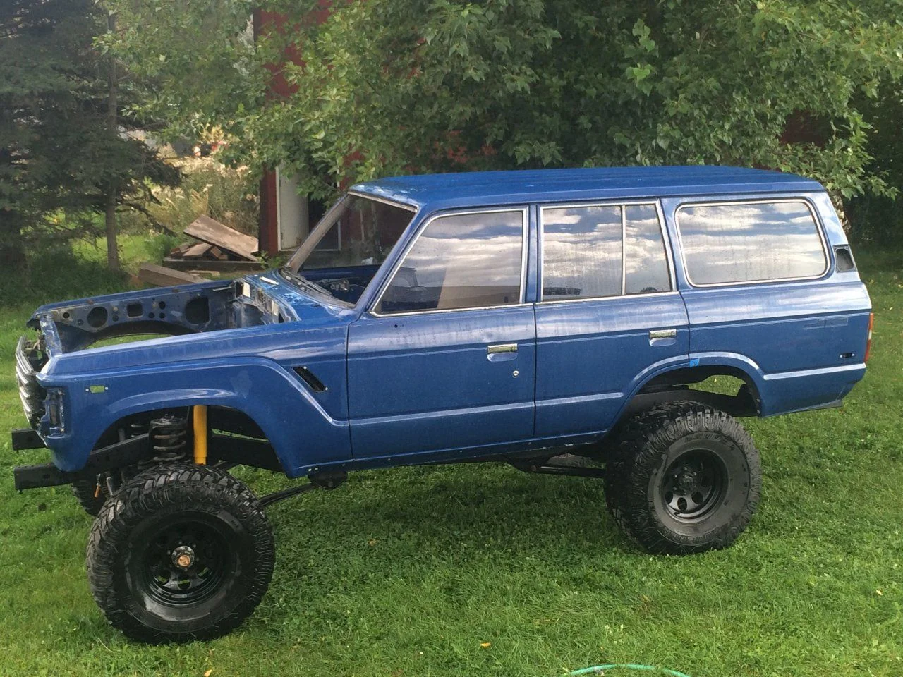

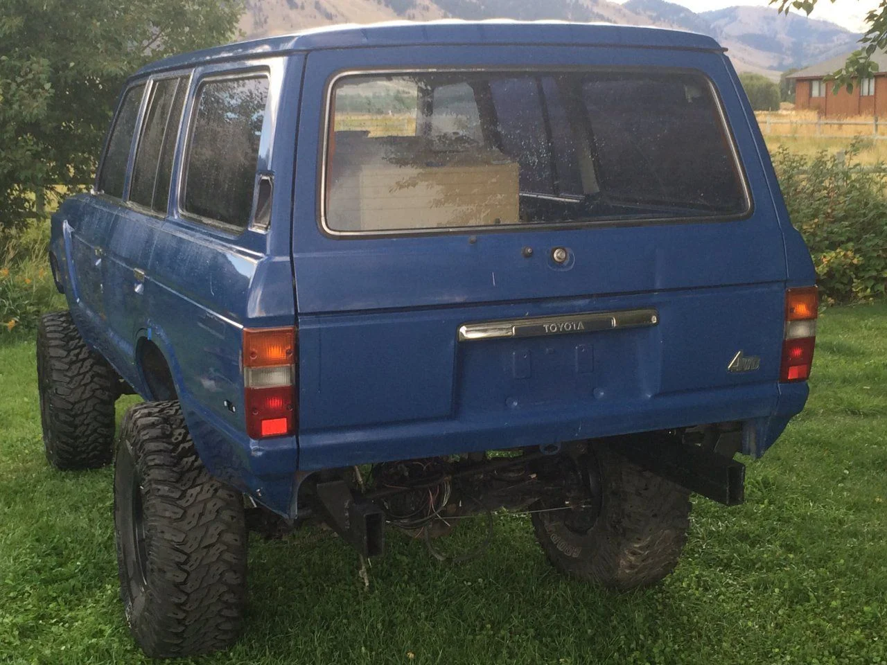

All washed up and back in the shop already! Looks like a storm blowing in and I don't want it outside for that.
Lookin' good!
