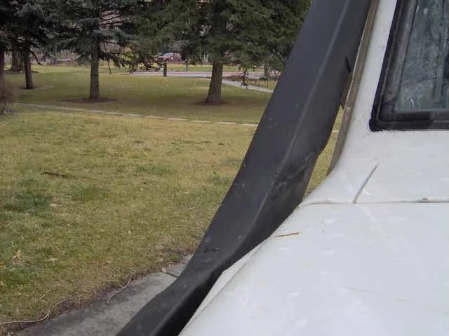

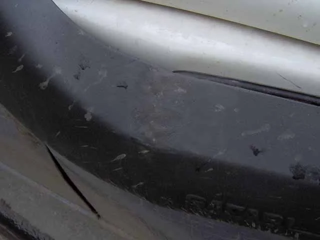

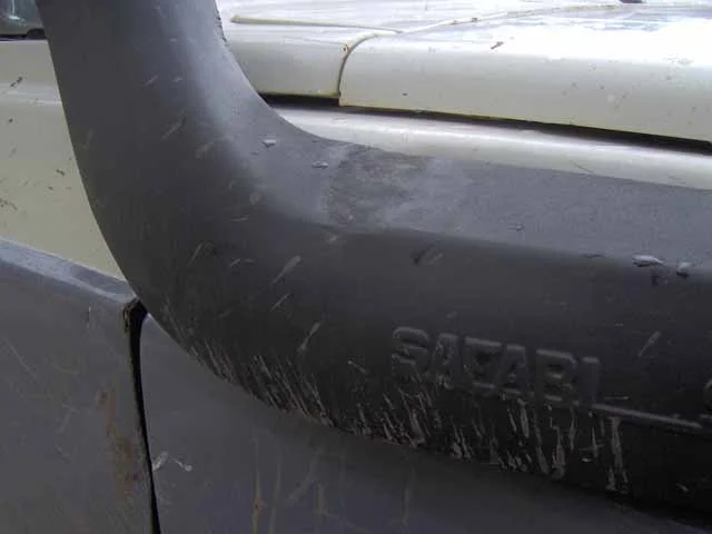

So I ordered up a BJ70 snorkel from Cruiseroutfitters.com
There are a couple mods you have to do, one is a cut because 70's dont have the flare where the fender vents are and the second is to push the snorkel out because it's slightly bent more inwards on 70 series.
I used a cutooff wheel on my grinder to make the cut, used a cheapo plastic welder from Harbor Frieght. This was actually really hard to use. I actually just reused excess material trimmed off the Safari Snorkel and this welded the best.
Then a mapp gas torch to heat and mold. The safari snorkels are very easy to heat and modify. If I were to do again though I would cut and tack and bring to a real plastic welder for good clean strong plastic welds IMO.
