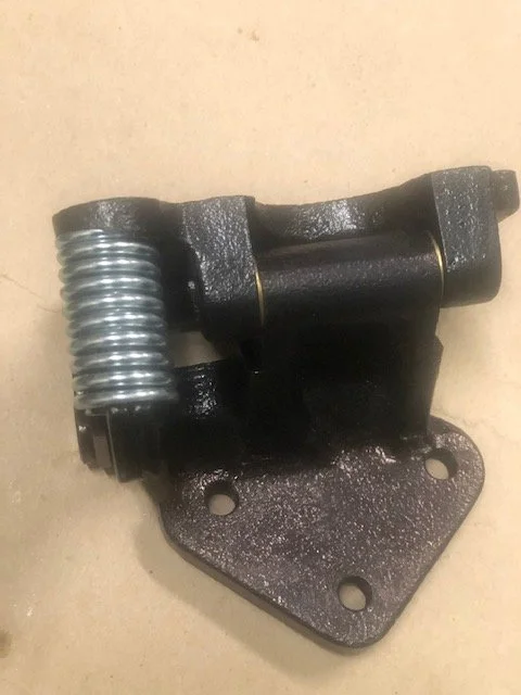

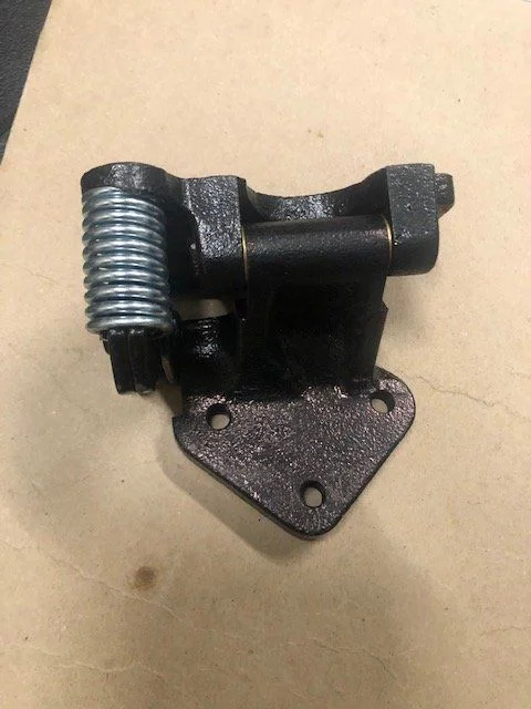

i had a guy in Alabama do mine($50 each i think) came out great

Yes, IIRC the shafts are splined on one end. I think I took pics when I rebuilt mine. I will see if I can find them...
The guy from Alabama doesn't rebuild them anymore, as far as I know. He was the only one that sourced the new springs. I used new Forty bushings and the Napa pins, I think.
