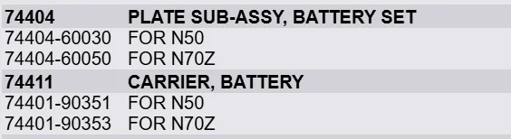

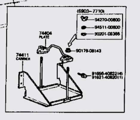

If it helps any, here is the information from the parts diagrams on the battery and tray for a 1969 FJ55. Actually it says this information applies to all years. What it unfortunately doesn't tell you is the actual size of the two different trays. I also looked up the information for a middle east FJ55 and got the exact same information, FWIW.

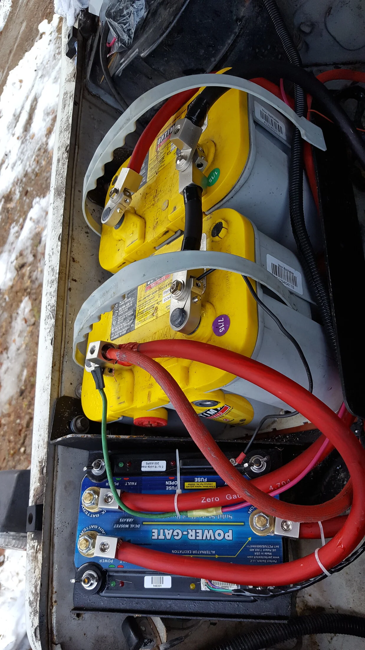

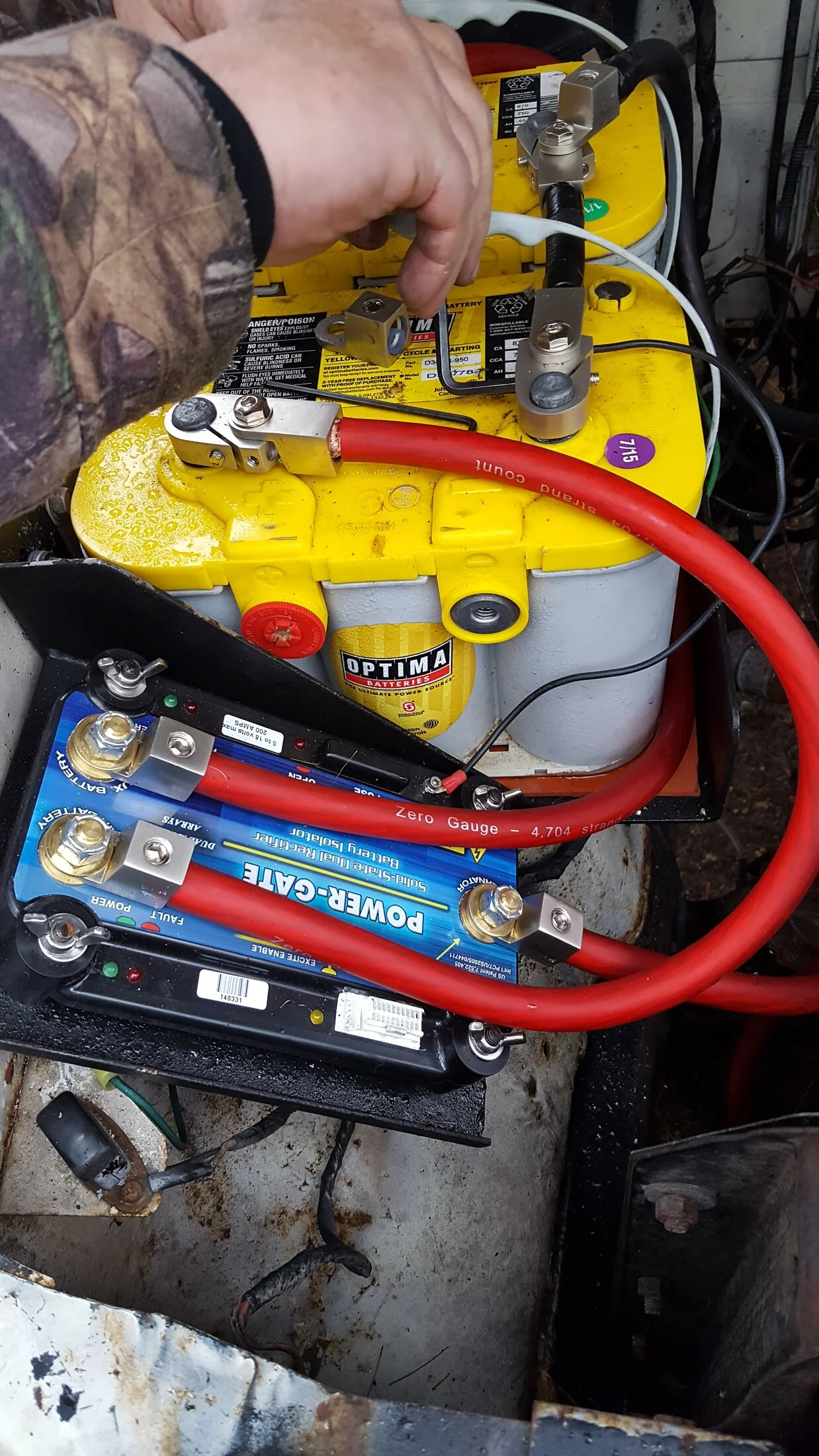

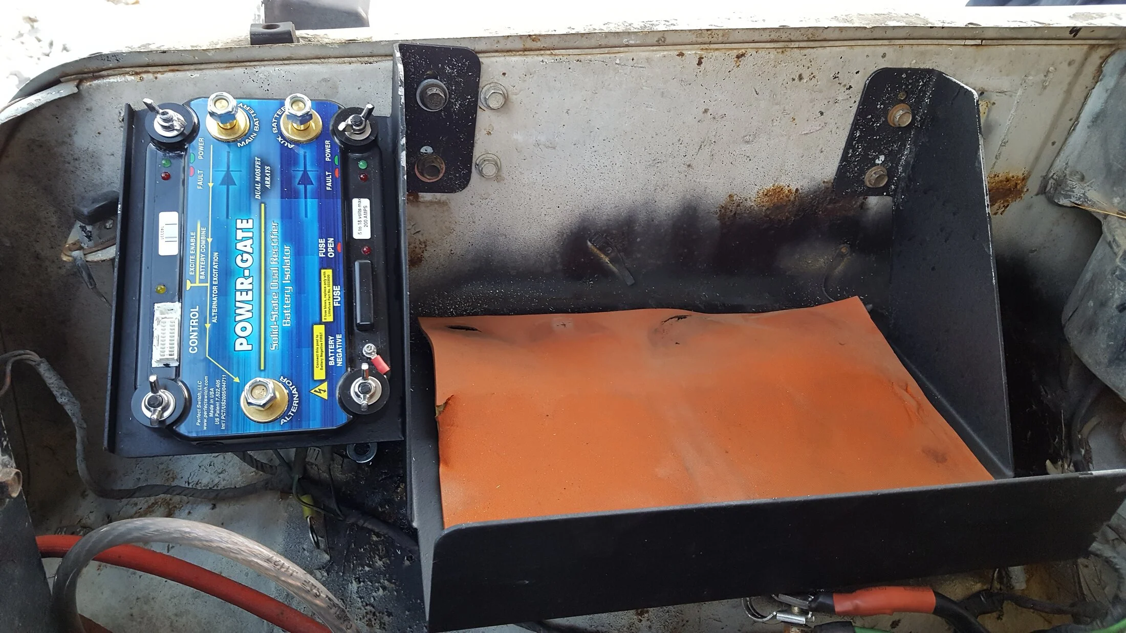

I make one similar to this..

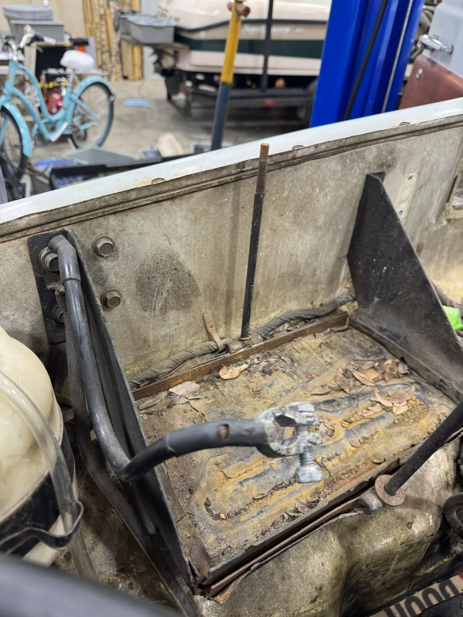

I measured mine and it looks like it will just hold a 12" long battery - maybe. The bolt holes are 13" center to center. If you look up those two original batteries, the N50 is ~10" long and the N70Z is ~12" long. They are about the same width.

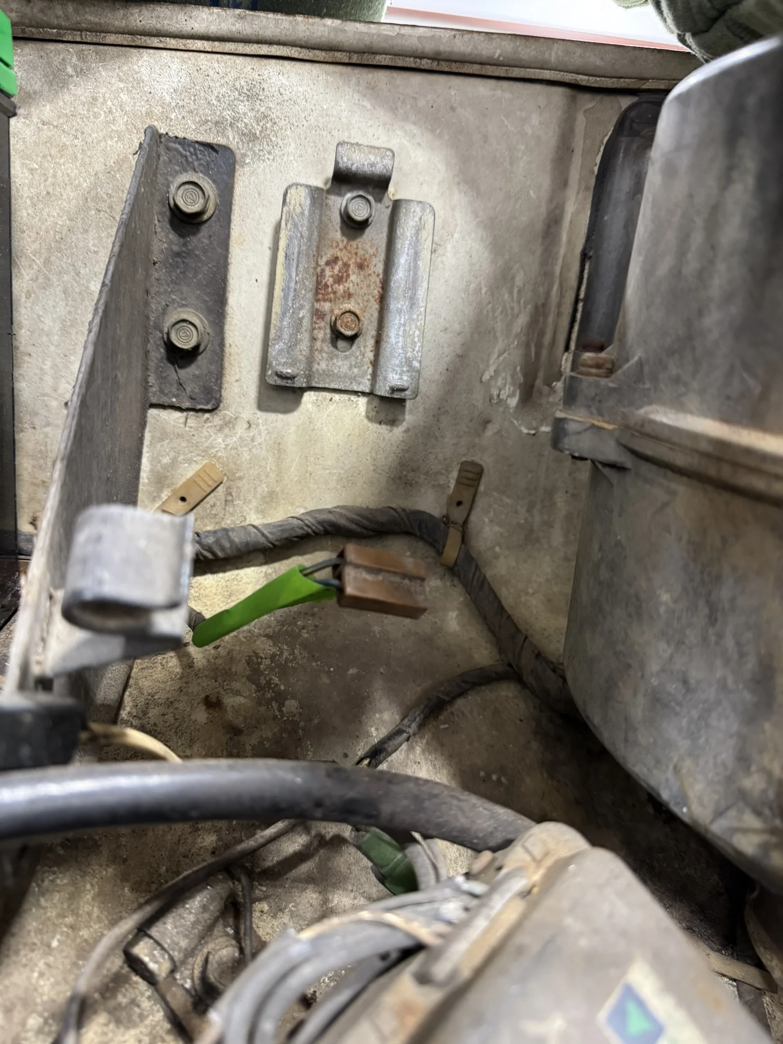

I also looked back through my disassembly photos. The two holes on the firewall side of the battery tray bracket hold the windshield reservoir bracket (first photo). They appear to be slightly different spacing and maybe one size smaller bolt. There are however two other bolt holes that are the correct size and spacing an inch or two inside one leg of the battery tray bracket (see second photo). These holes/bolts were unused in my pig and look like they would be used for a shorter battery tray. They are of course on the firewall side of the bracket leg furthest away from the firewall.

Interesting. I put the washer bottle in a different place as my pig came with a broken one in a parts box so I don’t know where it was supposed to go. Those pictures are super helpful! I will look again for more bolt holes. It do know after measuring I have the smaller size batter tray.

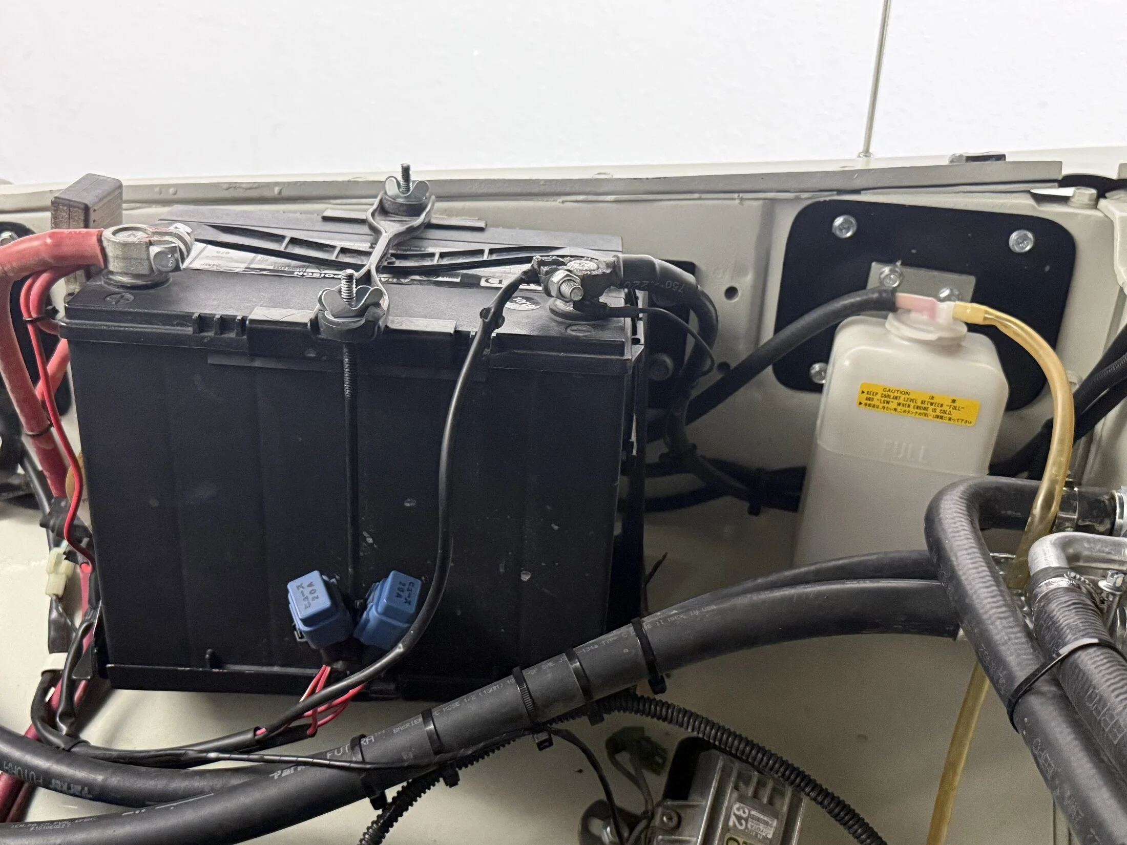

My setup is below. I added a coolant reservoir as 1969 simply dumped on to the road…simpler times. The two extra holes look to be the same size as the battery tray unlike on @WarDamnEagle setup that looks like smaller bolts/spacing. My washer fluid bottle is on the driver side. The block off plate that the coolant overflow bottle is attached to is where the vent used to be since I added an all in one Vintage Air unit.

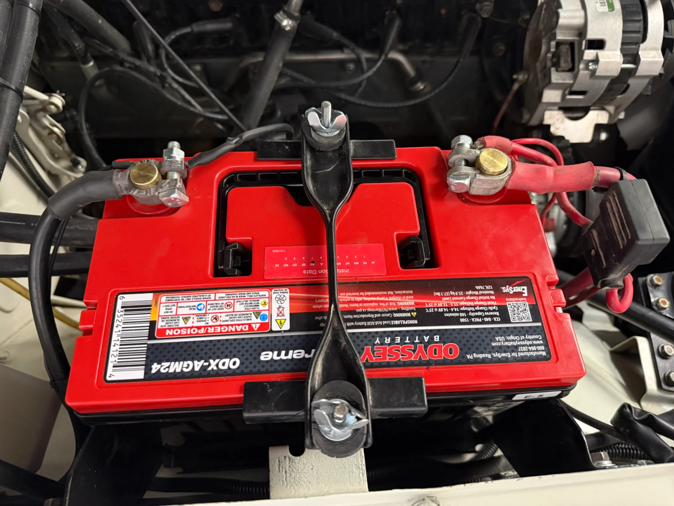

I’m sure you all were wondering what I decided to do…not! LOL. Anyway, I decided to go the easy route and just get a group 24 size battery. I went with the Odyssey ODX AGM24. I got Napa to give me 20% off so it was “only” $322 rather than over 400. It has 840 CCA and the X stands for extreme so hopefully good not only on the trails but also the Vegas heat. Man this thing is heavy at 57lbs. The only thing that I didn’t like during install was the depressions on the battery case around the two terminals. I have old school aka cheap terminal connectors and I had to flip them around just to get the connectors low enough on the terminal plus space enough to tighten the bolt. I have always hated the square head that is supposed to not slip on the connector…they always do slip with enough tightening force.
