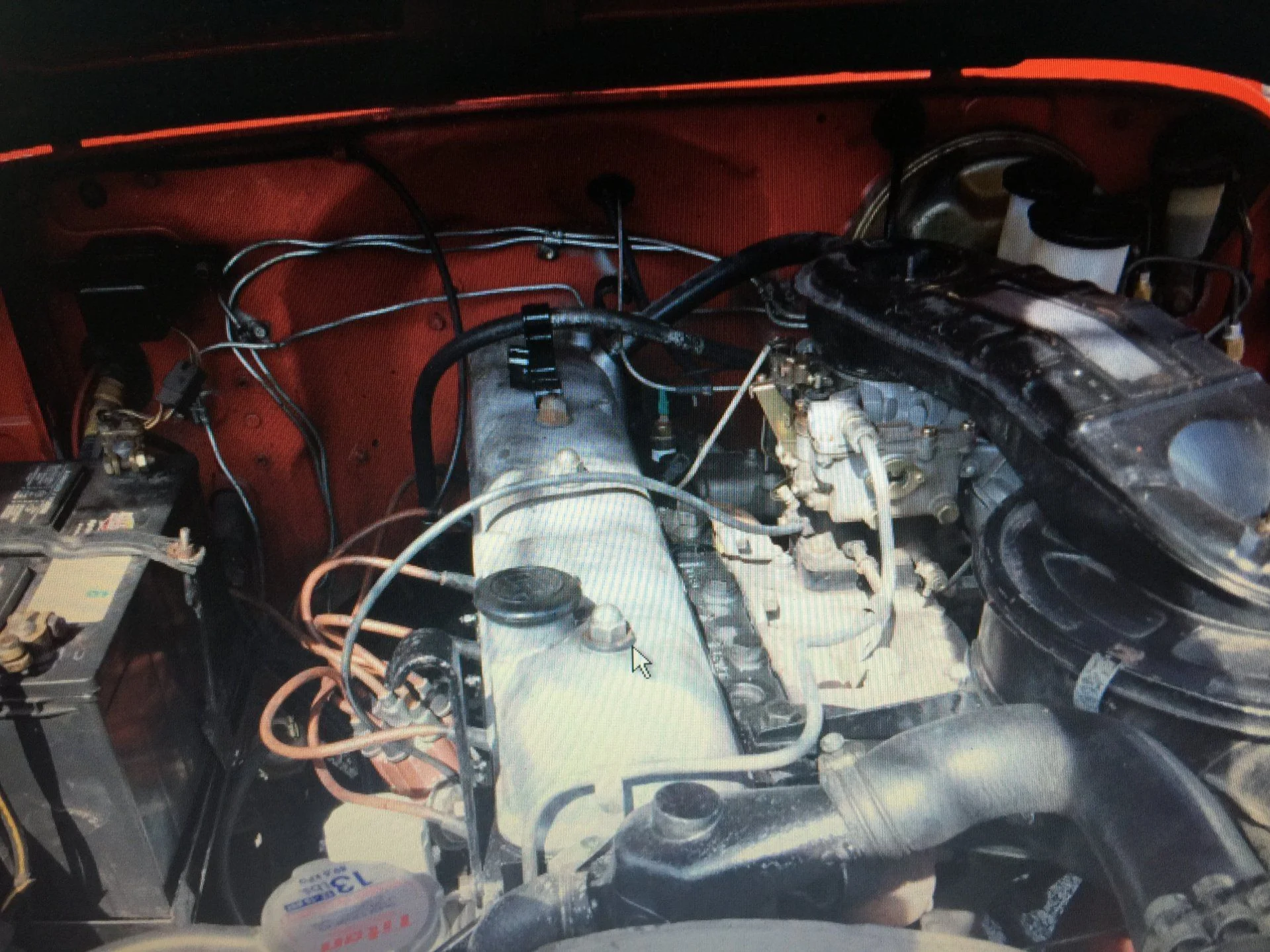

I had a '78 40 series a decade or so ago, so "just" have my '85 60. I miss the old girl and came across this ad (perhaps the Cruiser Gods were trying to tell me something) - Other than the 2x price of what I think it's worth - any thoughts? I'm not sure how much "premium" a 43 series brings. He sent me extra pictures that didn't reveal much, claims the engine is rebuilt, suspension "redone" and no leaks (fresh paint as well). It's a 2-hour drive to see it, so I was hoping for more pics from the seller. Interior looks nice and body appears rust free (but I know a fresh coat of paint can hide some cancer). Engine seems de-smogged. I question the suspension "re-do" - front springs look flat and front shackles don't look right....

Based on the info on the springs, I'd be somewhat concerned about their definition of a "Fresh Engine".
I'd want to see some pictures from before the paint job and to know how it was done.
Engine likely never had Smog as it has come from Costa Rica or some other country... Not North American Spec. It likely has had a hard life and will need a lot of work to make it a solid & reliable rig.

The engine looks clean, not fresh. Was it visited by the degreaser fairy?
