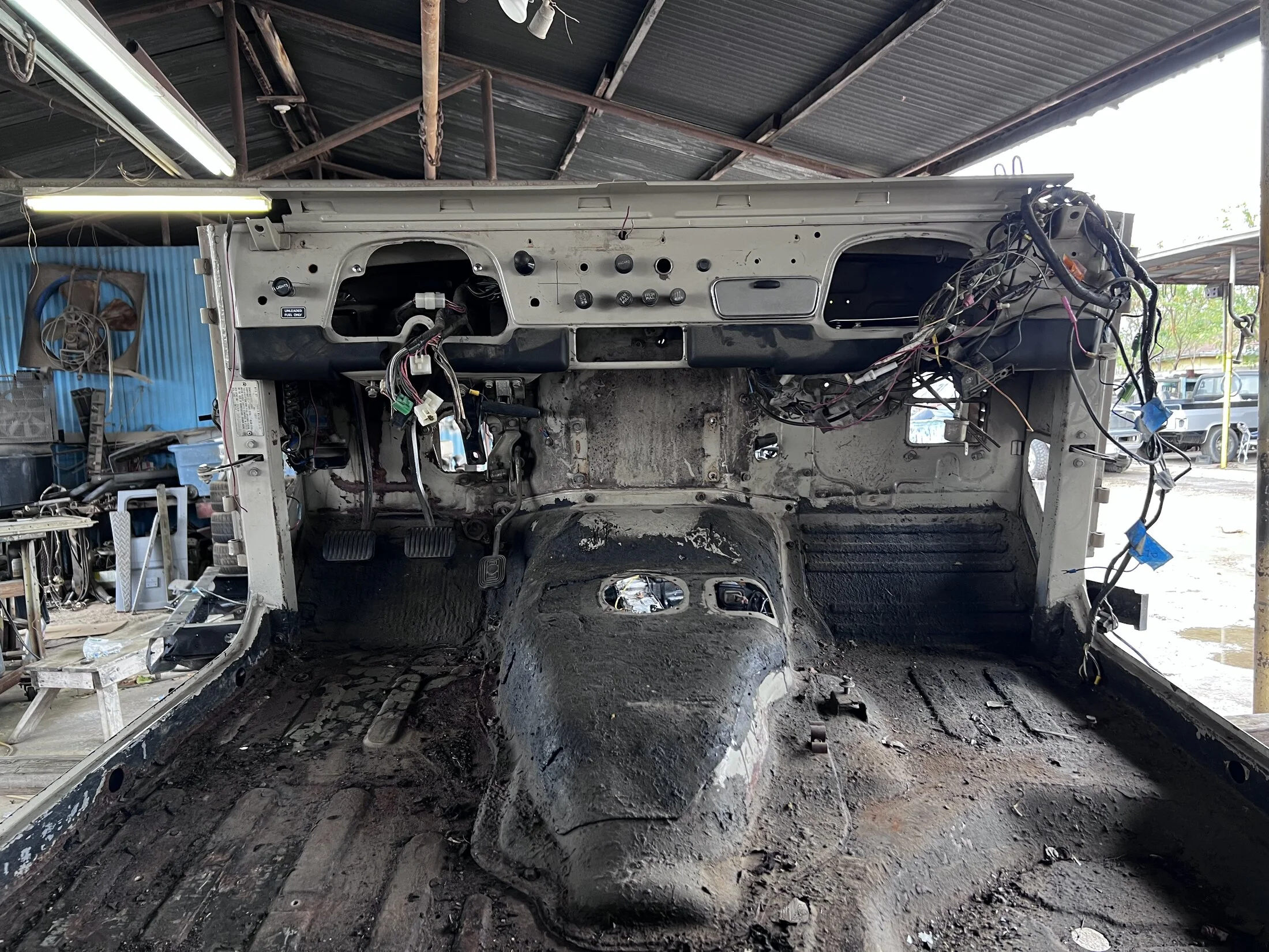

Where can I send my wire harness to be rebuilt?
I’m doing a frame off resto/mod on my 1977 FJ40, removing the stock heater and adding Vintage Air A/C.
I’m in Texas.

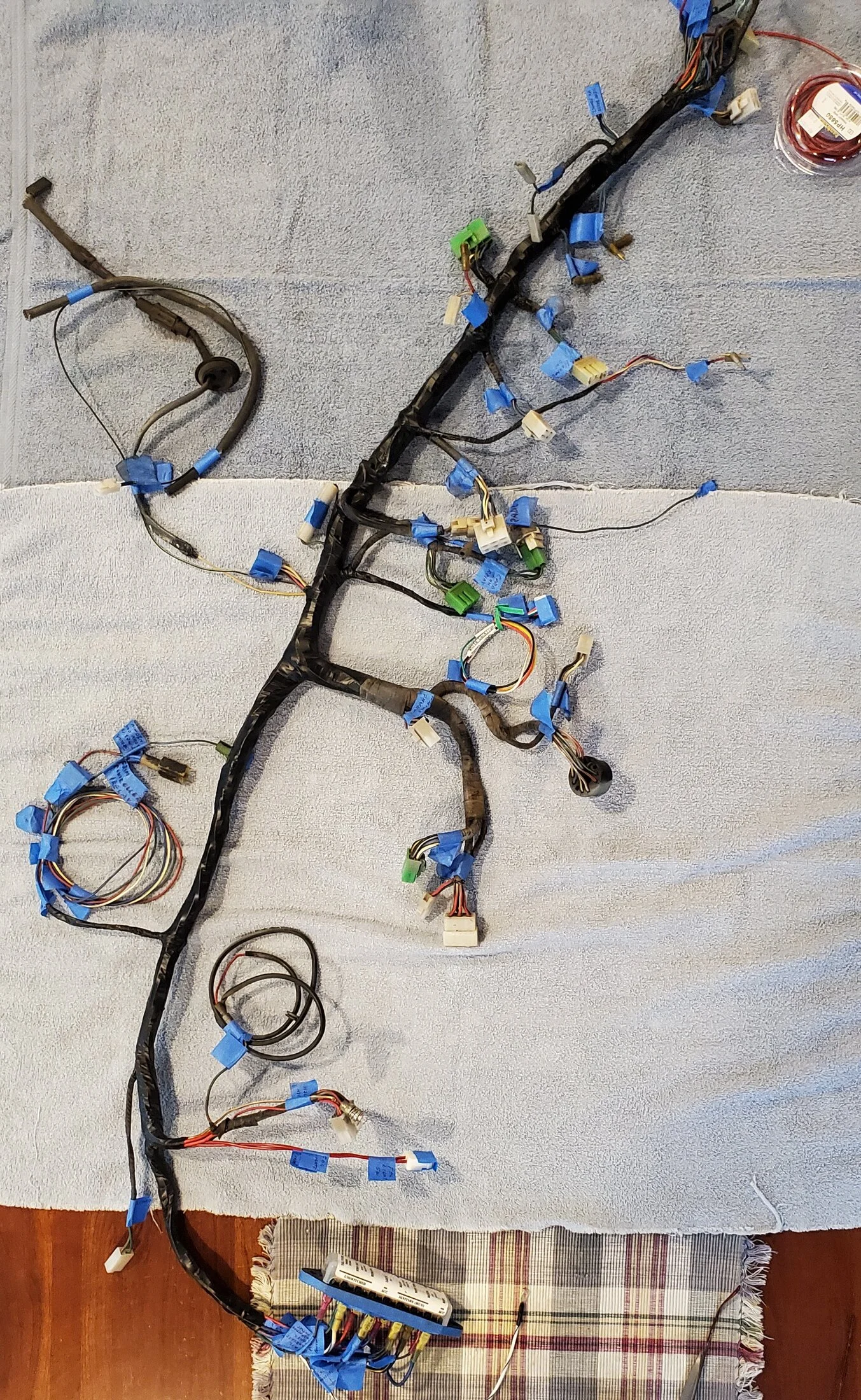

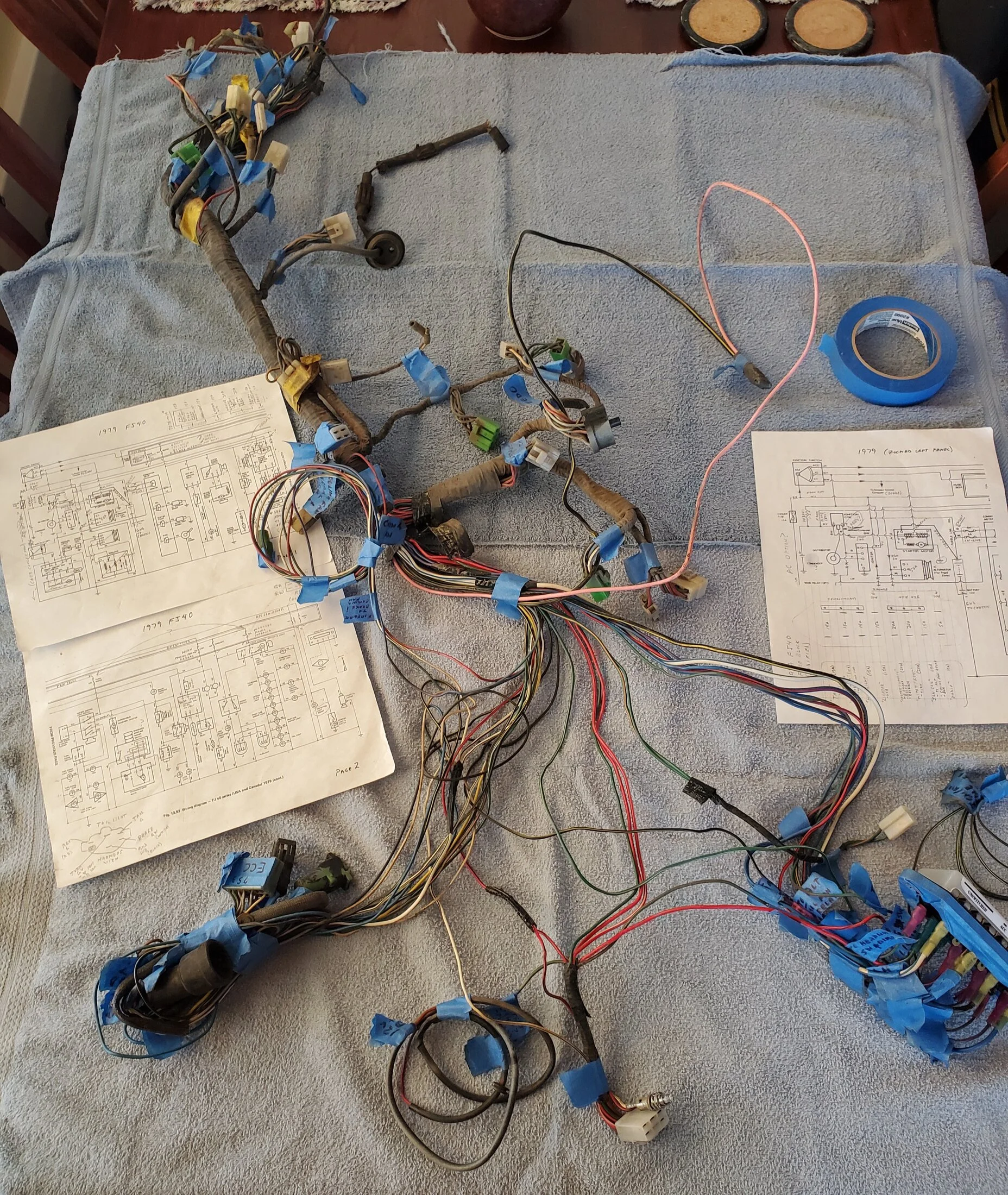

I just cleaned up the harness on my abused 79, removing ECC-related wiring, factory AC option, resistor wire and adding some upgrades.
It was a little tedious, but after studying the wiring diagram and color codes, and picking up the right tools and supplies (@Coolerman was a big help), it seems to actually work.
Nice to have my dining room table back!
