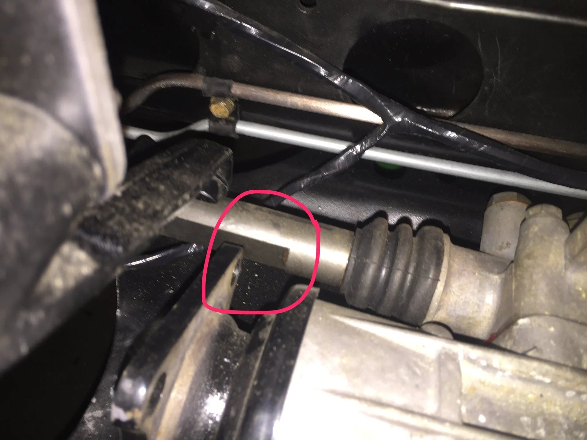

I had the trans and t-case rebuilt on my 5/1977 FJ40. Upon reassemble I am finding that the transfer case shift lever does not clear the shift guide bracket when attempting to put it in neutral and L4. I can disconnect the shaft from the linkage and manually move the t-case through all gears(H2,H4, neutral and L4). Is there an adjustment I am missing or something wrong?
Here is a picture with the lever in H4. It will not go to the right enough to even get into neutral.

It looks like the bracket in the first pic is in the way of the shift lever and would interfere with it's movement.
Sorry if this is stating the obvious but it looks like that ear on the bracket is the problem.

It looks like it is not fully engaging in H4. The shift shaft plunger is not extending out far enough thus the lever is not clearing the guide bracket. What would prevent the shift shaft plunger from extending out further?
Below is a picture of the shift shaft plunger when I attempt to put it in H4.
I disconnected the tcase linkage from the shifter. I can manually move the tcase through all the gears (H4,N,L4) by hand using the linkage. It appears I cannot get the lever to go into H4 even with the linkage disconnected.

I have tried that. The problem is the shift lever is not coming back far enough to clear the shift guide and engage H4.

I generally don’t reinstall them either. But the plate could not be the source of interference for front to back motion.
Without the guide plate it seems to move great through all gears. I did remove the Fairey OD but don't think that would have any impact.
Is the any adjustment on the shift shaft? Could something have shifted internally to cause the shift shaft to not come out as far?
With the high / low selector disconnected and the guide plate removed, can you hear / feel a positive engagement when shifting between 4wd and 2wd ?.......The mechanism works on a detent system and is either in or out.
