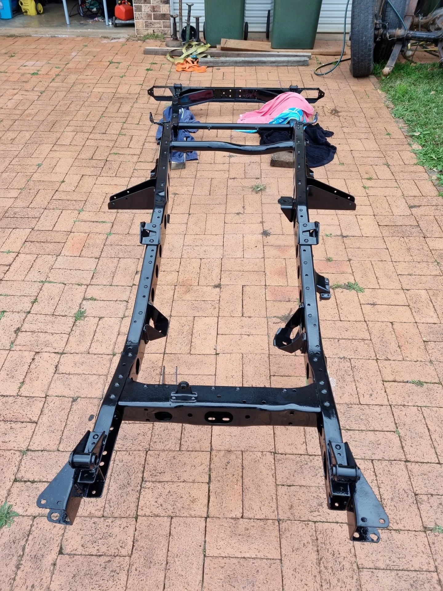

Not sure what the best answer is but I had mine powder coated, and I am very happy with the result. The powder coater did miss a few spots inside the rail. So long as they take their time coating the rail, then it should be ok. The 4 or 5 small spots, I hit with a quick spray of high gloss black.
I believe the most practical is sand blast and POR15. Powder coating looks nice but as others have mentioned when the frame flexes the powder doesn't react well and it also chips somewhat easily.
That looks really nice. Good job.
