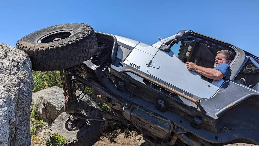

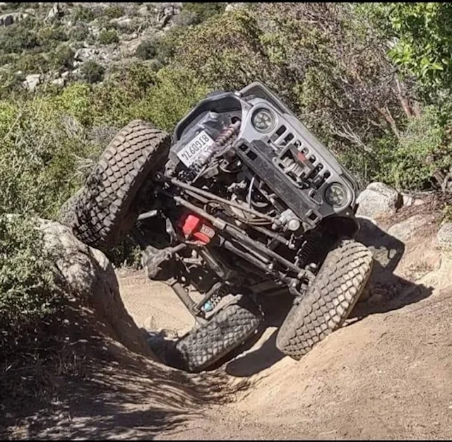

I told my fabricator that I had 14" King Shocks and he said I would be able to get approximately 30" of articulation with those shocks and the 4 link suspension. I asked him what that meant and he sent me these pics. That is his personal rock crawler with the same setup. I guess that says it all...
View attachment 3035930View attachment 3035931View attachment 3035932View attachment 3035933
Note to self: never volunteer to follow Brian…or his fabricator!😱

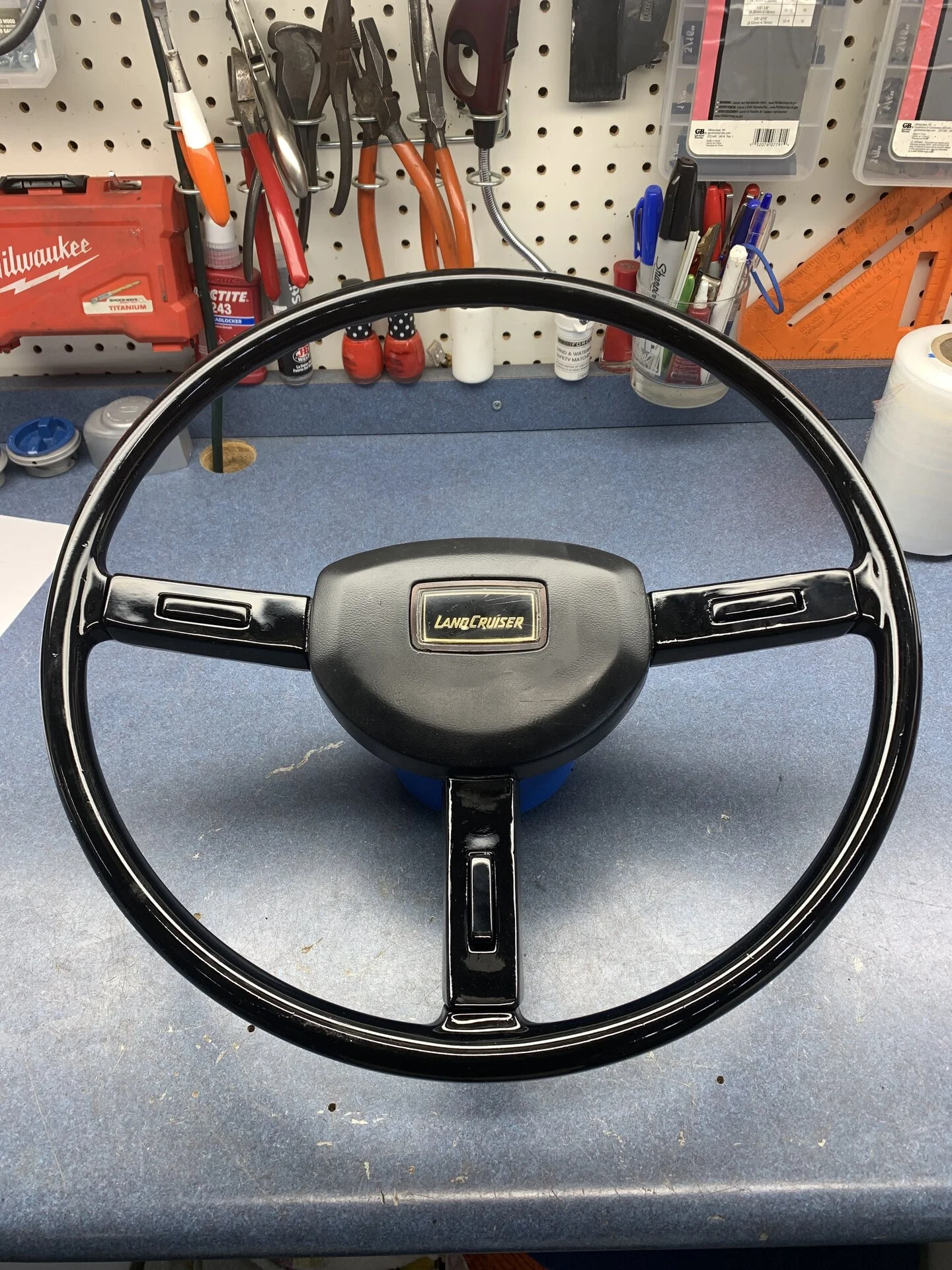

Purchased the 5 speed shift plate instructions, media blasted the door and painted, made new cable, and had the foam from somewhere else, can't remember where. I use a white grease pen for the lettering.
Like the Plate Install!! I would have thought you would have removed the masking after installing but seeing where your at with the build I can understand leaving the masking on to protect the plate.
