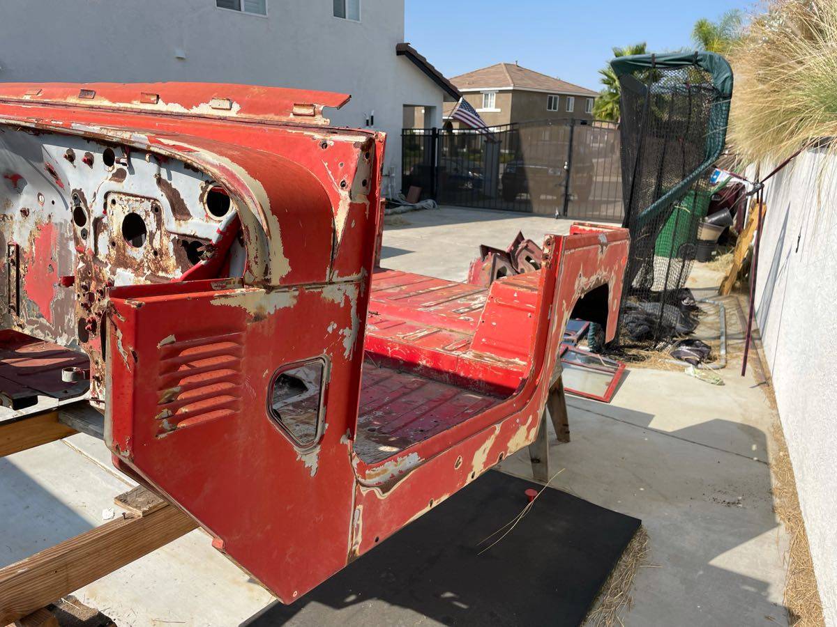

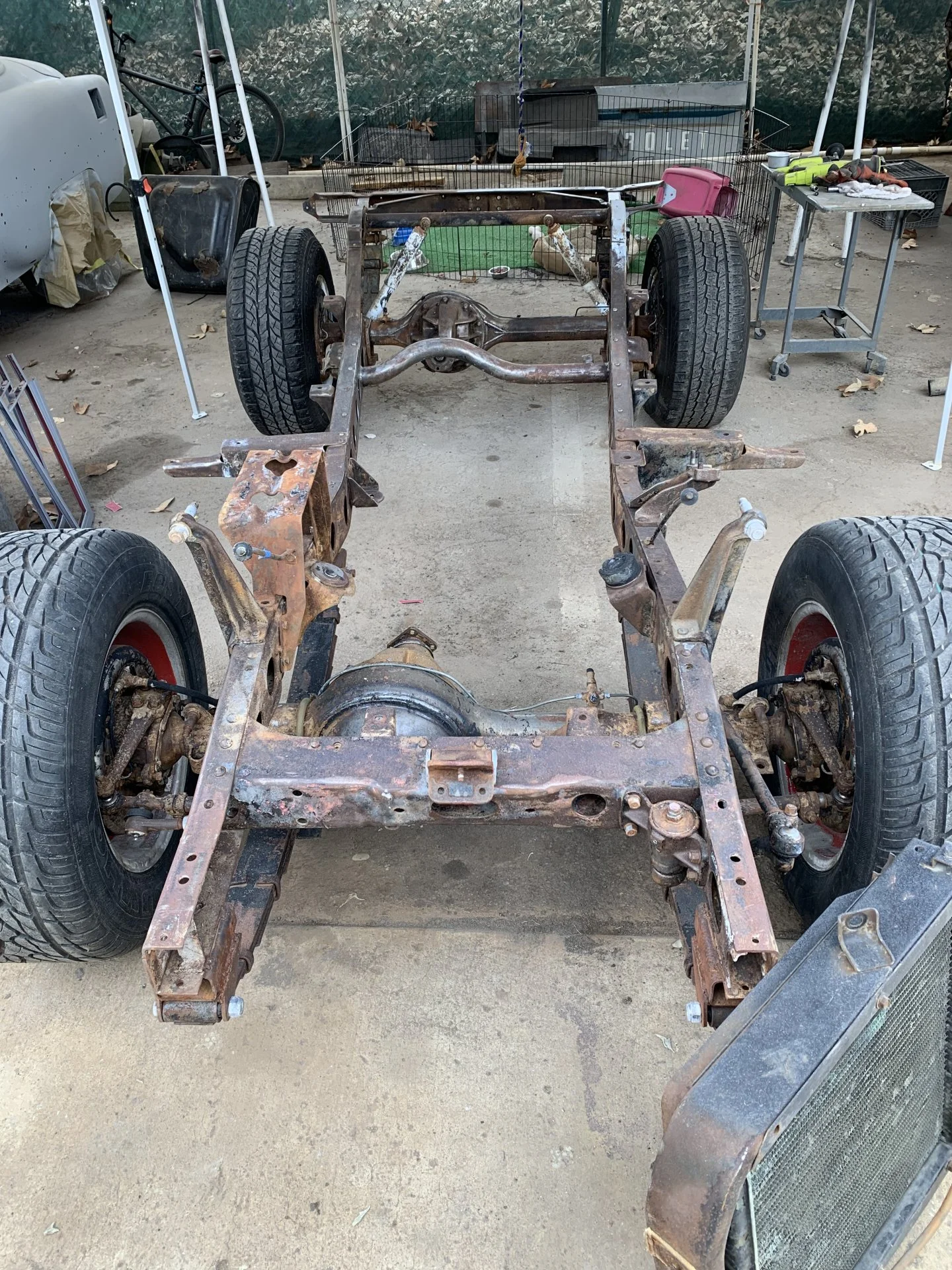

Starting another build, as if the first one isn't going slow already. I must be a glutton for punishment.
Started with a pretty clean 1973 FJ40 that i picked up for $2500

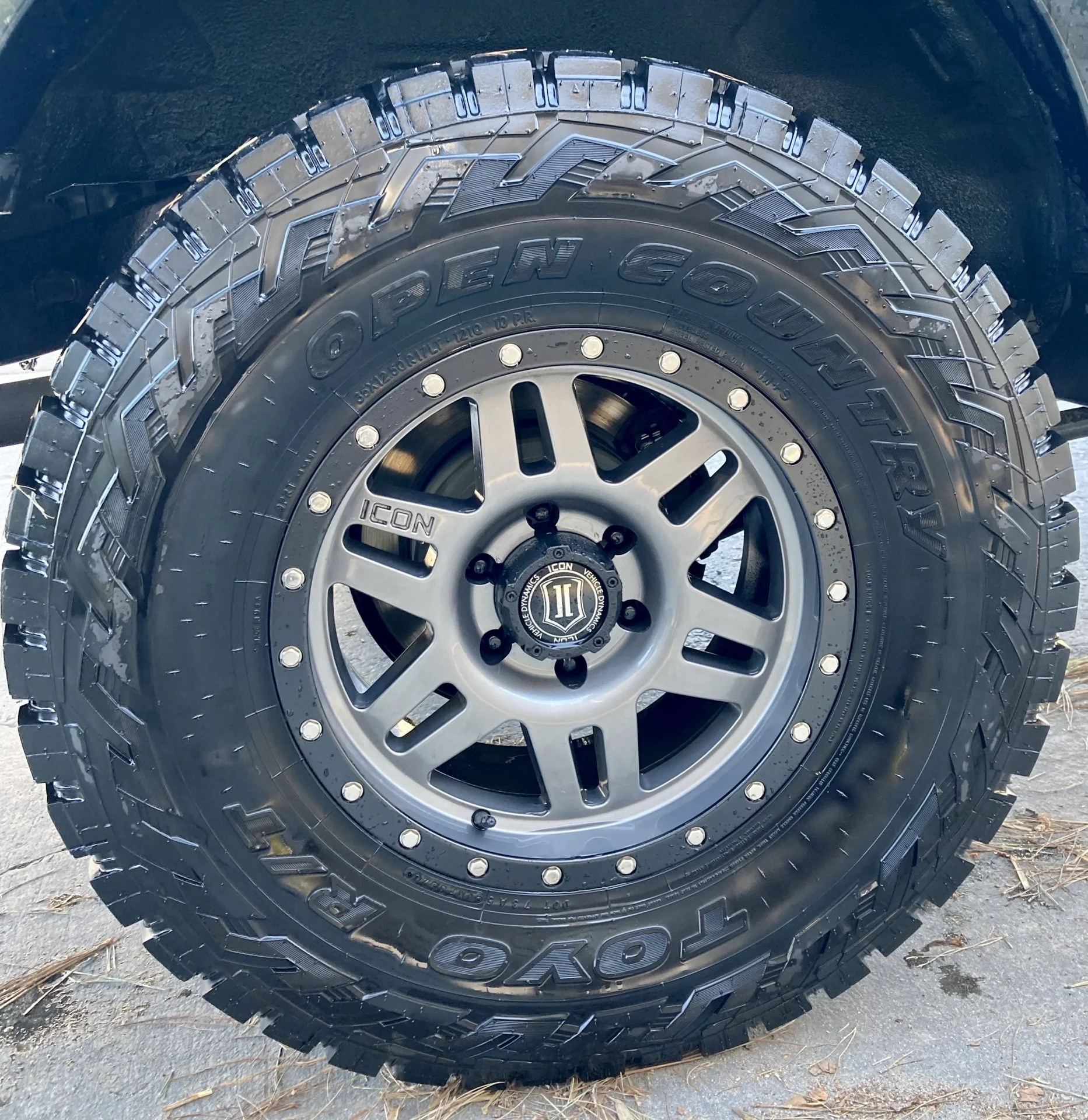

As for color I like the color on the ICON Dynamic Wheels I purchased from @Surfdc or something similar too them. A gunmetal gray.

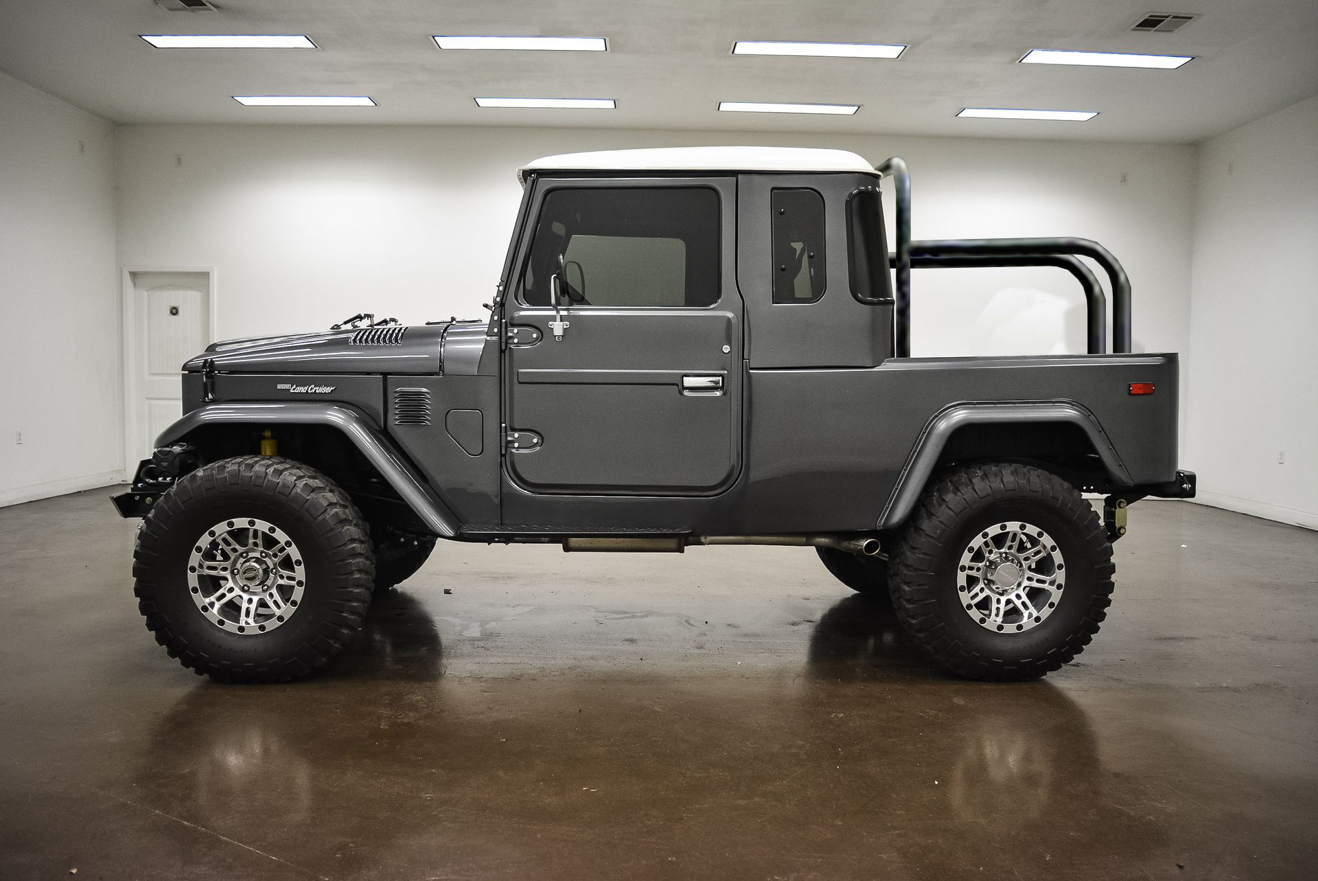

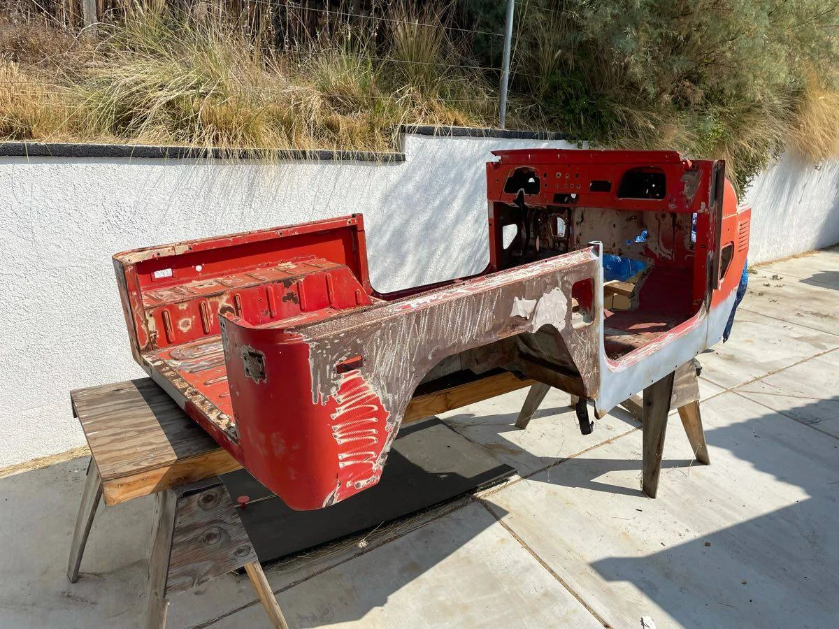

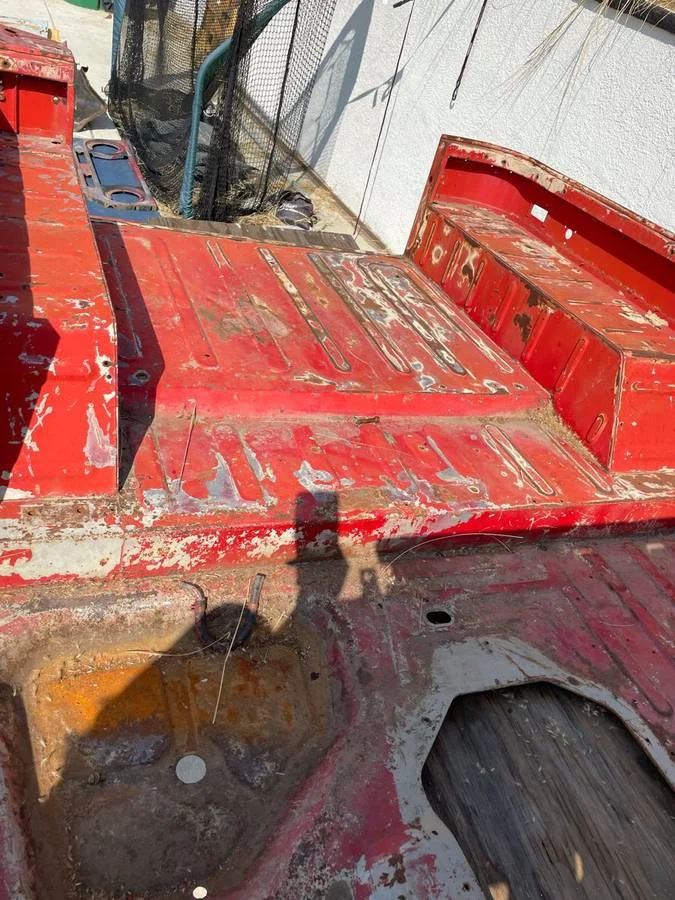

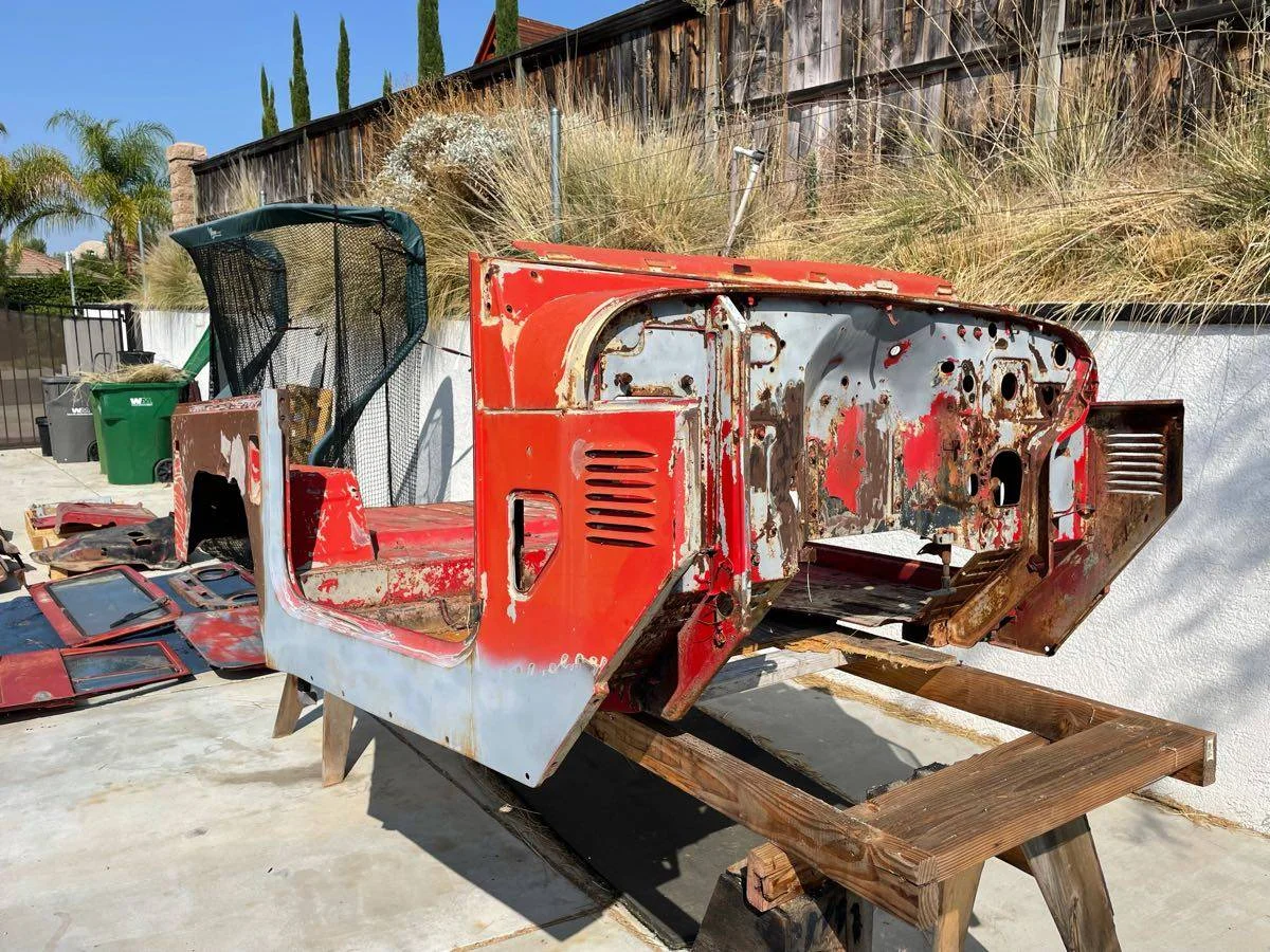

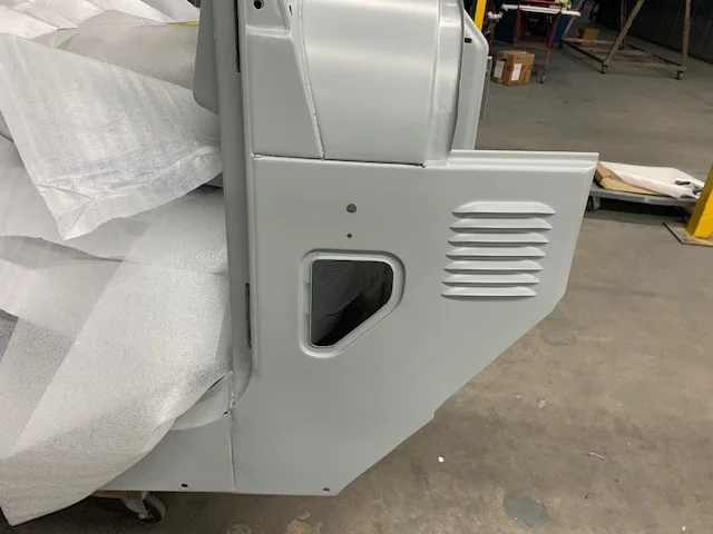

The top I have is a perfect donor for shot cab and longer bed similar to the one pictured below. My top needs a lot of work and has a really bad section in it, and I have always liked the look of these shortened cabs. My bed will get extended 12"-18" behind the B pillar as well.
It will have a L92 that I picked up with super low mileage and a Tremec TR-4050 with a Atlas Trans Case. The lengthened body will help the the short wheel base as well as the rear drive shaft length.

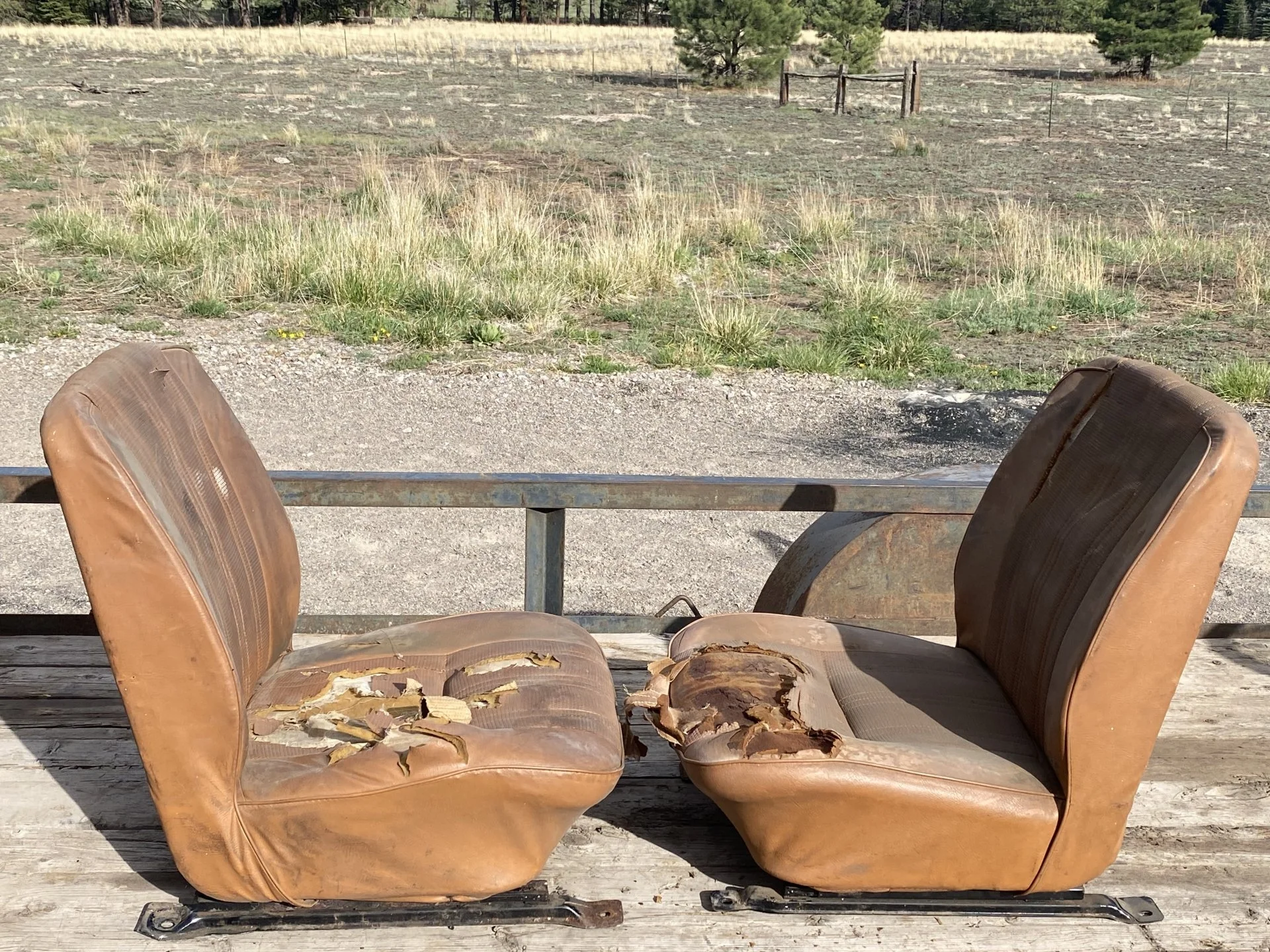

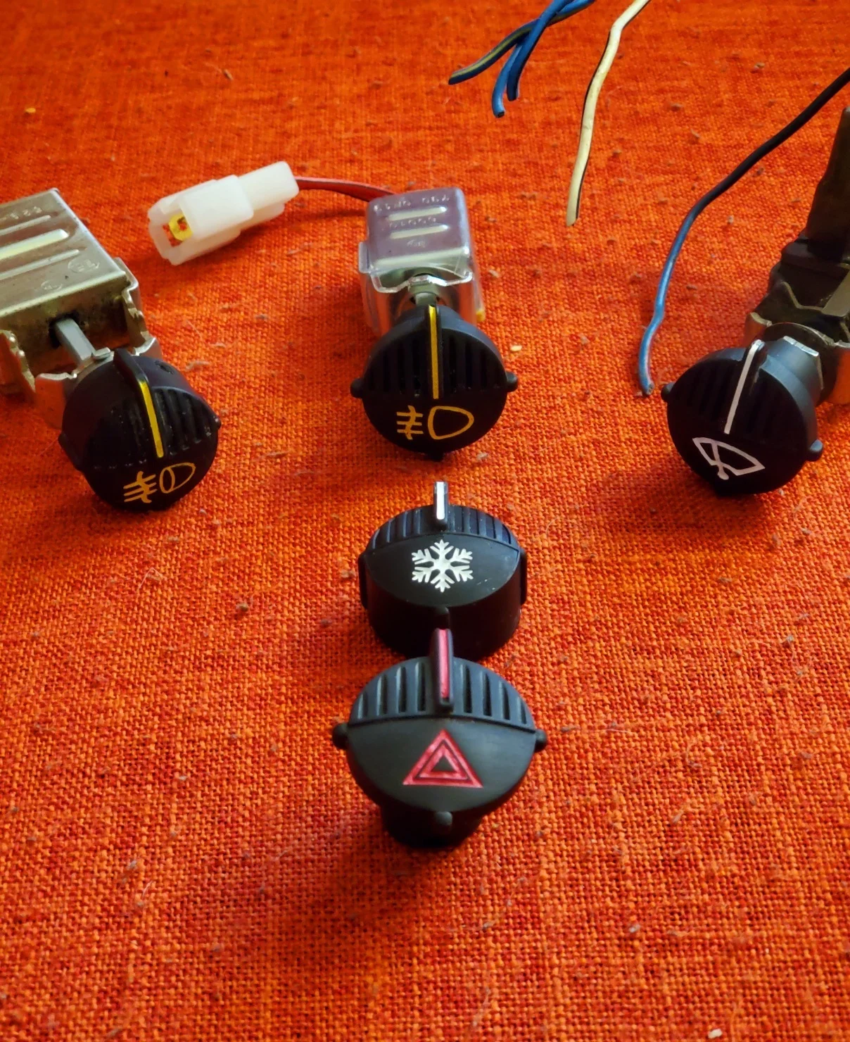

As for the interior, I am going to keep it looking fairly original to certain versions of FJ40 LC's, meaning I am taking parts from several different eras that I like and Frankenstein-ing them together to get the look I want.

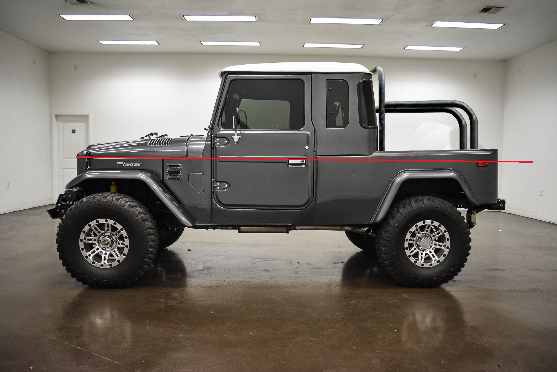

Thats a really cool truck. Hopefully your body guy owns a level, it may just be the camera lens though.
A guy showed up at the 45 run ten or so years ago with a half cab 40. The coolest thing was that he kept the hatch functioning, and could open it from inside the cab and reach his ice chest in the bed for a frosty adult beverage.😉
:popcorn:🥃🥃
That is cool. I was thinking about putting the two ambulance door windows you sold me back there for a little split windows action but I could make the whole thing operable fairly easily.
Ah. Either way, it would definitely be unique.
