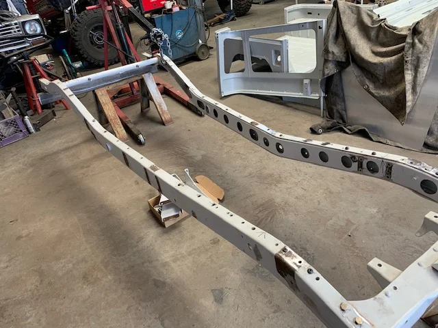

Yep. I’m stupid. But 4 link in rear is nearly impossible unless you make some drastic moves like stretching the frame.
You should really only need to push the axle back. It's been done plenty of times. Unless you are going for a ton of travel, the links can be pretty short.
I’m lengthening the frame and body for better proportions, so I’m there is an added bonus.
…and you’ll still be able to run an aux tank in the back, which was one of the things that turned me off from trying it.😉

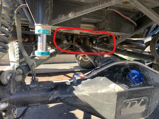

Yep, As we talked about Mark, the four link with the Aux Tank was the goal. Although my suspension guy showed me an FJ40 he did that was not stretched and only had a 2" lift with a four link and the Aux Tank looks like it would still work. He did end up building a major bracket to make it work, but he pulled it off. Since there is no good four link setup on the market (that I know of) for FJ40's he is looking to make a kit. I strolled into his shop the other day and he had the initial CAD design on his monitor. You can kind of see a version of this he did if you zoom in on the circled area of this pic. Of course this one had a much more aggressive lift. More to come...
It’s more work doing your original plan, but personally I think you should stick with your plan.
Half the draw of the linked suspensions to me wasn’t the flexibility, it was and is the extended wheelbase. I have spent too much time on the end of a winch cable, trying to keep my rig from rolling over backwards because of all the rear overhang 😱 Even so, I resisted even flipping the rear springs around because of not wanting to lose the aux tank.
I think your original plan is the ‘best’ solution for a 40 that can overland and rock crawl. The other ‘best’ was @DHONDAGOD, who kept the stock length, stretched the wheelbase with a four link, and built a custom tank under both front seats, which helped the weight distribution for the steep climbs even more.
The custom tank under the seats was another option from my builder. Still have time to make that decision.
