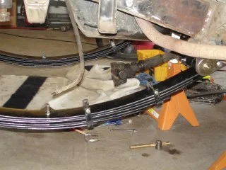

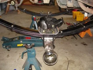

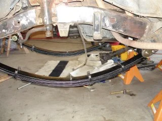

Just to update!
Got my spring packs re assembled, and got the springs, shackles etc bolted back up under the rig, and started set the perches up...This has turned out to be A LOT tougher of a task than I originally thought, actually, the perch on the pass side that nestles into the pumpkin is the main culprit! After a day and a half of chasing my tail, trying to get everything square, Ive decided to PUSS OUT and take in to get the perches set and the c and t done. I just dont trust myself to do it exactly right, how I want it, so Im going to leave it to professionals.
Anyway, here are some pics of what Ive done thus far.
Man I feel like a WIMP for doing this, but Id rather be safe in the long run, that stroke my ego and be sorry later.
BTW, I discovered on my rig, that the stock angles WILL NOT work and a cut and turn is NECESSARY. At full droop of the suspension, the x fer u joint binds with the x fer output flange. Just FYI!

If you rotate the pinion to point directly at the transfercase output you should run a double cardan shaft. that is a main reason for doing a c+t to the front axle along with caster. A DC shaft will insure a no-vibration drivetrain and is best. It's problably good you are doing the c+t I just thought that it wasn't needed as much on a 62 because of the added length of the auto vs. h42.

Thanks D!
I only just learned about a DC drive shaft on another post I had up...Where do you get those? How much are they. Damn, the expenses just SNOW BALL for this project!:crybaby:

You can get a custom one from a driveline shop or you can source one from a pre-85 FJ60. You will have to get the pre-85 driveshaft lengthened though. You might be better off gettting a custom one because the double cardon cruiser drivshafts usually costs about $100 and then you have to pay to have it lengthened.
> a pre-85 FJ60
Bingo.. Or a mini truck shaft with a double cardon same u-joint. I found a double cardon and all they had to do was add it to my existing front driveshaft, worked great, about $70 out the door balanced. Hope it helps.. Andre
Or you could just buy a DS from High Angle. Thats where I got my DC rear.
So, the mini trucks have the same bolt patterns as the LC'S?
You were able to use your stock DS too?
Chicago
I did the mini cv on my 40 too, I found two of em in good shape for $50. I had to drill my flanges at the t-case, both front and on the e-brake drum. no problems so far. you're on the right track chicago, keep it up. :cool:

I think he is in So-Cal. I don't have my receipts here at work. I spent so much money on my 40 I have pproblems remembering how much I spent where. :rolleyes: I know it wasen't cheap, nothing was.
The thing is Jessie at High Angle will talk you through the whole process and knows what to ask to get you the right thing first time. I had to send him my rear outout flange (e-brake drum in my case) to get re-drilled to accept the double cardon from a mini truck.
High Angle has a very good reputation in the LC community.
