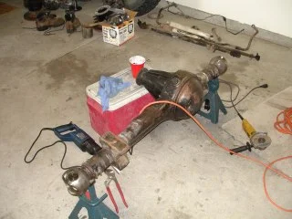

Today, just finished cleaning the spring packs, so when I get the pads and rear spring pins, I can re-assemble and start with the actual spring over process! Cleaned and painted the knuckles, and started HACKING off the old perches...
Lemme say this...When everyone tells you that you need to take off all of the steer stops, sway bar mounts etc, they mean it. I was thinking that I could save some labor later by maintaining the sway bar mounts....NO FRICKIN WAY! Youve GOTTA take all the crap off of the housing ends. This is taking quite a bit of time, in fact, longer than I thought.

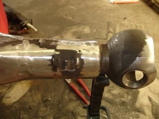

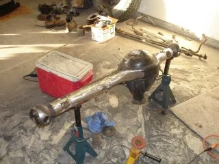

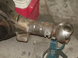

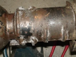

The axel is ready for the TRANSFORMATION PROCESS!
What a PITA it was grinding everything off. I used a cut off wheel for my 4.5 in angle grinder, and a saw zall. I cut off the steer stops and sway mounts on an angle in toward the housing ( like this /), so I might be able to re use them again. My theory was, that Id be able to salvage more of the original length to re attach em later without as much hassle...Well see how that goes.
Here's a few pics of the housing!

Chicago,
I've been keeping an eye on your progress and it's looking good. While I have never done a SOA on a 60 series, I'm not sure why you cut the turn stops off. Do you end up doing something different to stop the knuckle from turning too far? Or is it because when you do the cut-n-turn, you have to move them to get everything lined up again? Again if I can help, let me know.

Hey Jack,
I AM going to do a C and T to the housing, and Ill be using a 6 in pipe cutter to do so. I use em (pipe cutter) on the job all the time, and you cant beat the nice STRAIGHT, CLEAN cut that they make...Also, you have a lot better control of the depth you cut. With that being the case, I HAD to remove the steer stops to be able to get the roll cutter in to do its THANG! I didnt trust my self using the angle grinder...It seemed to me, that going too deep into the sleeve wouldnt be a good thing, not to mention a crooked cut.
In all honesty, Im not quite sure what im gonna do about re attaching the steer stops, but ill deal with that when the time comes!

Well that makes sense. I've seen people make their own, should be able to come up with something.
Jack
I would hope so! Probably gonna have to fab something up, but I have a BUCH O SCRAP to screw with. I would think that all I have to do is reposition where the old ones were, and Ill be good to go...I would think!
Right now, Im more concerned with the setting of the perches and grinding the short side to fit nicely against the diff! I DONT wanna screw that. I have to wait till I get my leaf spring pads from C dan, so I can re-assemble the spring packs and get to work. I just got my greasable pins from MAF...NICE!
