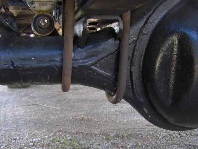

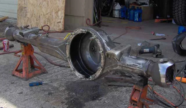

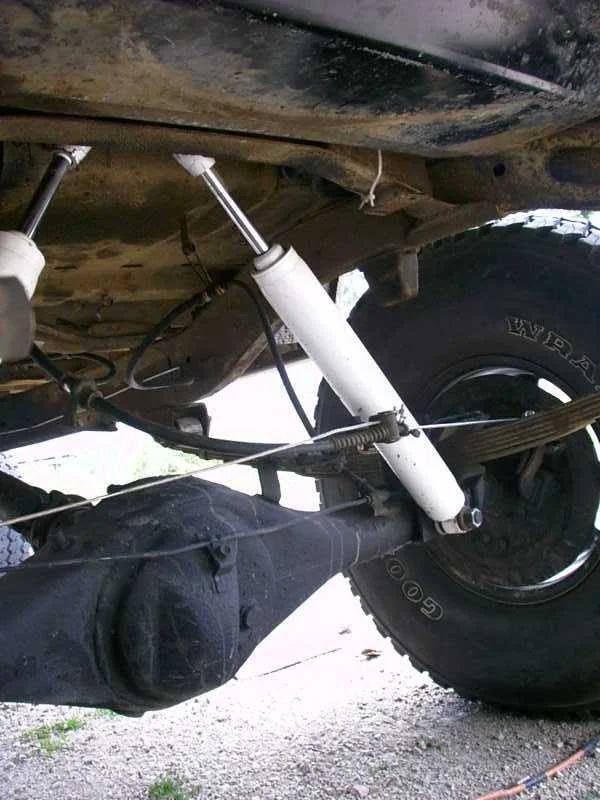

Here's a photo of the 40 tab on the 60 axle.. Mark is right on the money.. I put 14" travel shocks front and rear last time. Next time I would probably do 12" travel in the rear with the shock more vertical. I couldn't say for sure whether you'd lose articulation but it would probably ride better and the shock would work a little. You would probably still have to weld on new pins a hair narrower than stock... Here are some photos.. The front axle, with the 40 tabs on it. Look very closely at the ends of the axle.
Diesel cruiser head,
YOU RULE!!!! Thanks for showing hooking me up with those pics! that really helps A LOT!!!

Then the rear axle shocks, which I think have angles that are too extreme if you ask me. Again, I would use shorter shocks more vertically if I had the choice again...
When I first started putting the rear shocks in the rigs at similar angles I too felt that it was kinda steep. But I have had no complaints abpout the ride, handling or performance of the shocks mounted like this, so...
Mark...
