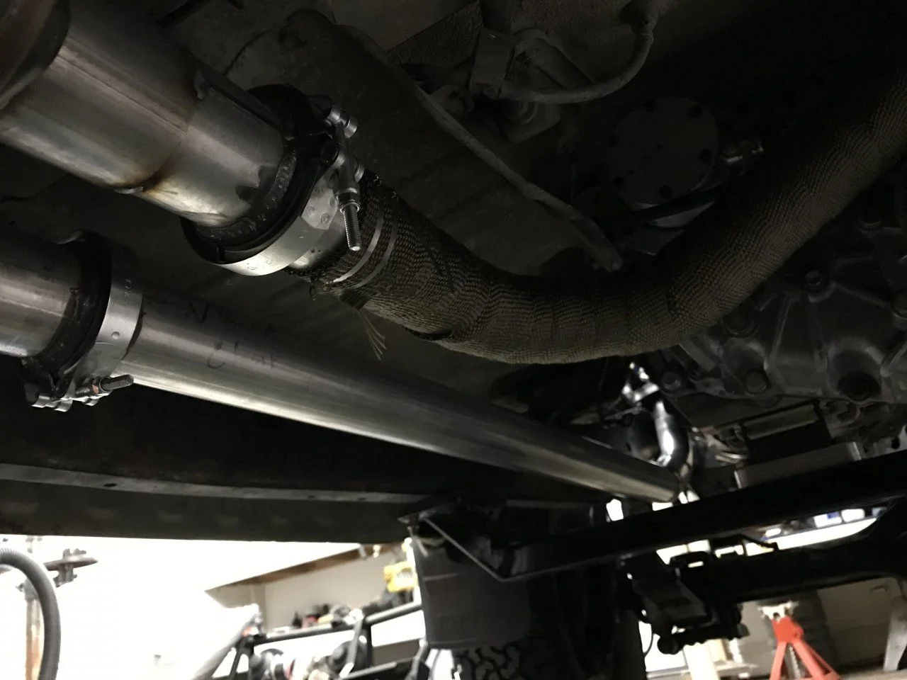

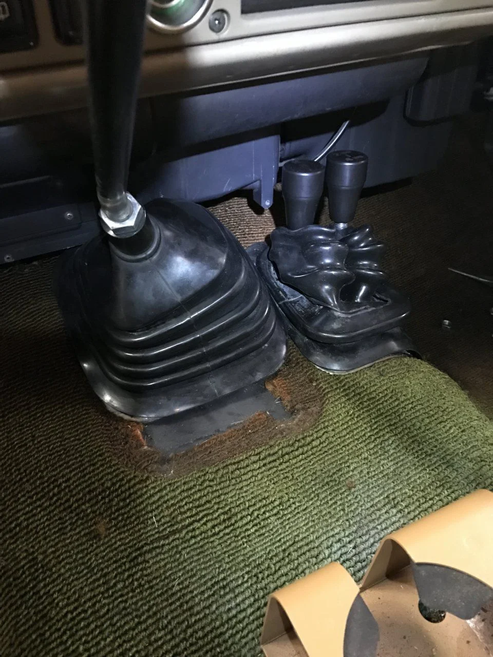

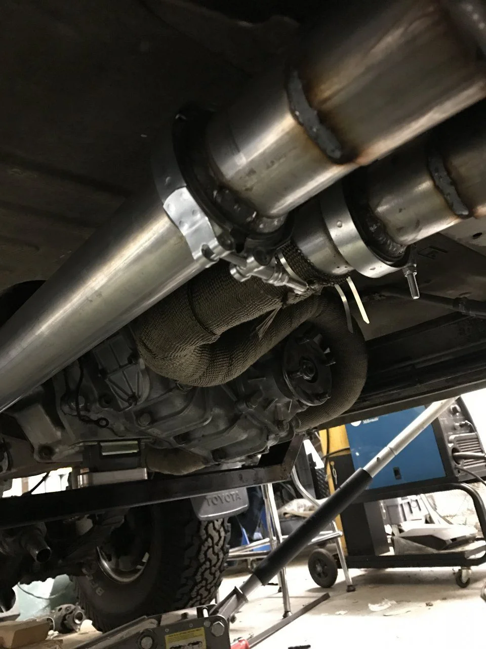

Made some progress on be exhaust. Got the pipes bolted up to the headers and run to the magnaflow (model #12558) for those curious. Tacked in the stubby v band clamp pipes and bolted them to the rest of the exhaust. Got my shifter boots back on and the floor sealed up.

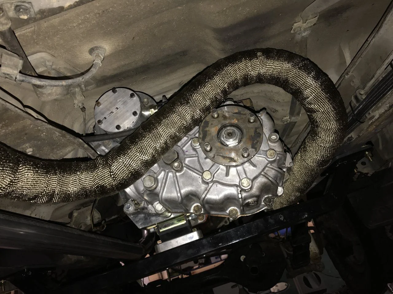

I wrapped from the flange at the manifold to the muffler strictly for heat reasons. My fuel lines, brake lines, power wiring to fuel pump run along the inside of the frame rail. I wrapped around the t-case to keep the heat off the floor since there is no heat shield and keep the temp on the t-case down.
I always wonder if having one pipe almost straight and the other one with more turns and bends, does not affect the engine exhaust flow, backpressure, exhaust valves, scavenging etc .. ?
I talked to a race car buddy if mine and he said that since the x pipe would only combine the exhaust together 18" before it comes together inside the muffler it probably wouldn't help the situation. There would a a difference probably in friction pressure but it's neglidlbe when it comes to damagin the motor.
Not sure what muffler you have but some of them have an x inside the muffler is yours two into one or dual in dual out.
my exhaust is similar around the transfercase, I plan to wrap the exhaust there....to reduce heat radiation on the floorboard.
Mine is a dual 2-1/2" inlet and a single 3" outlet. It has a y pipe inside the muffler where it goes to the 3" outlet.
What brand muffler did you use
So why not go under the front of the trans, in front of the pan on auto conversions to get the pipes together on the drivers side. There's room, it's high enough, and you don't need to go up and around the transfer case and driveshaft. Virtually every SBC in the late 60's and 70's had the exhaust routed that way from the factory
I used magnaflow 12558. There is not room on an auto conversion between the front axle and the pan either. It either gets in the way of the axle or the front driveshaft when the suspension travels.
