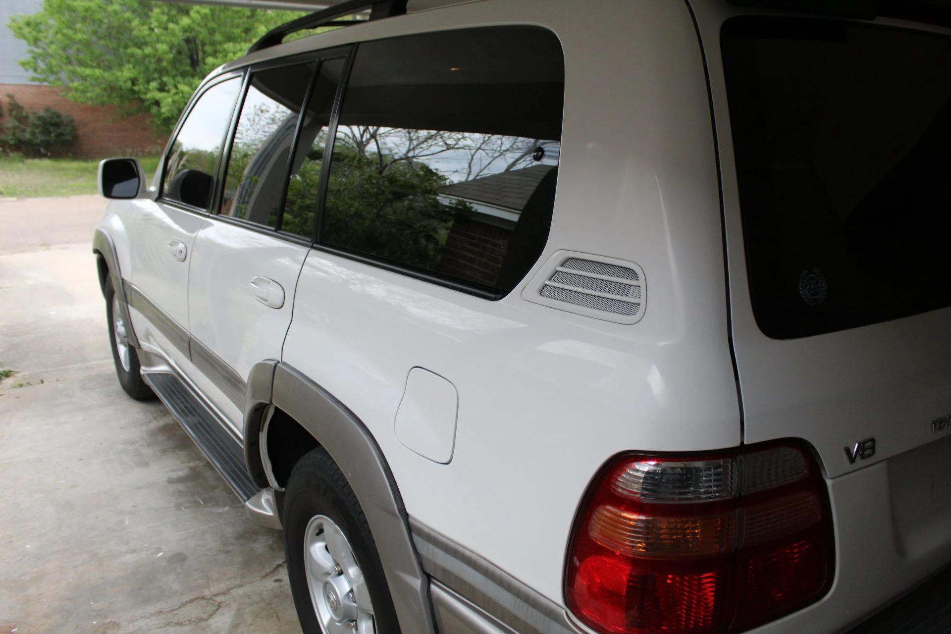

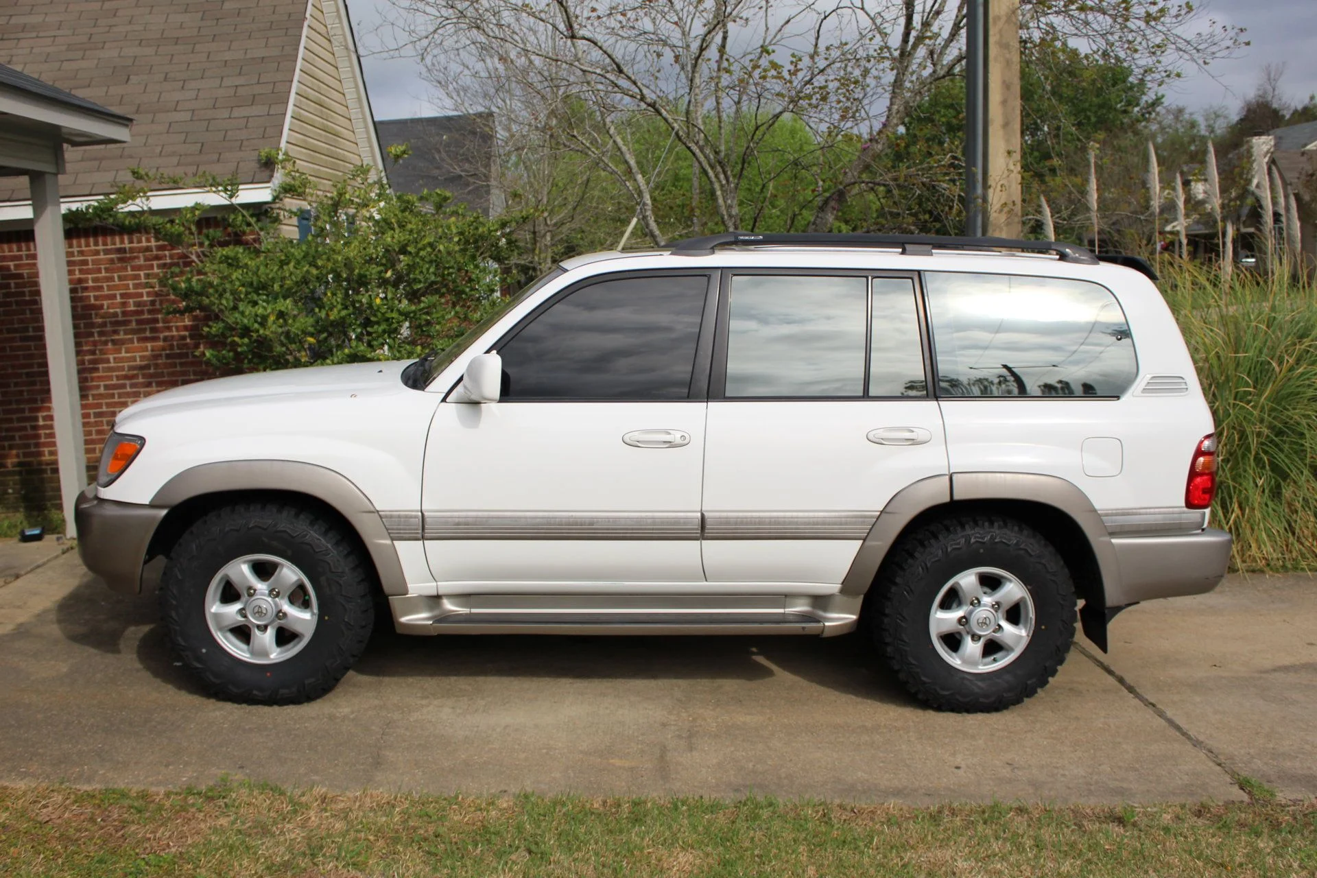

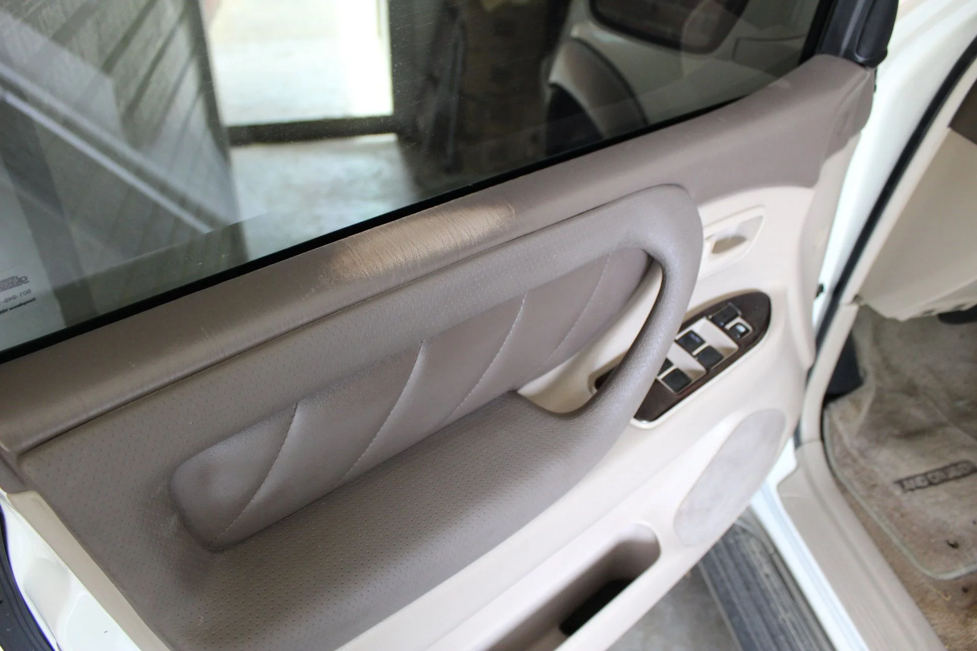

I had the entire vehicle tinted with 3M ceramic. There's 20% on the front two, the sides are 5% over factory, and the back glass has 20% over factory. I toyed with the idea of have a light layer of mirror tint put on the front glass in an attempt to make is similar to the factory tint. I ultimately decided against it. If I can find a high quality tint that would match it I'm going to have the front windows stripped, tint with mirror (maybe 40% or so) and then put a layer of 35% 3M ceramic over that. It'll probably make the front windows darker than was I really want but I'll feel better about it's appearance.

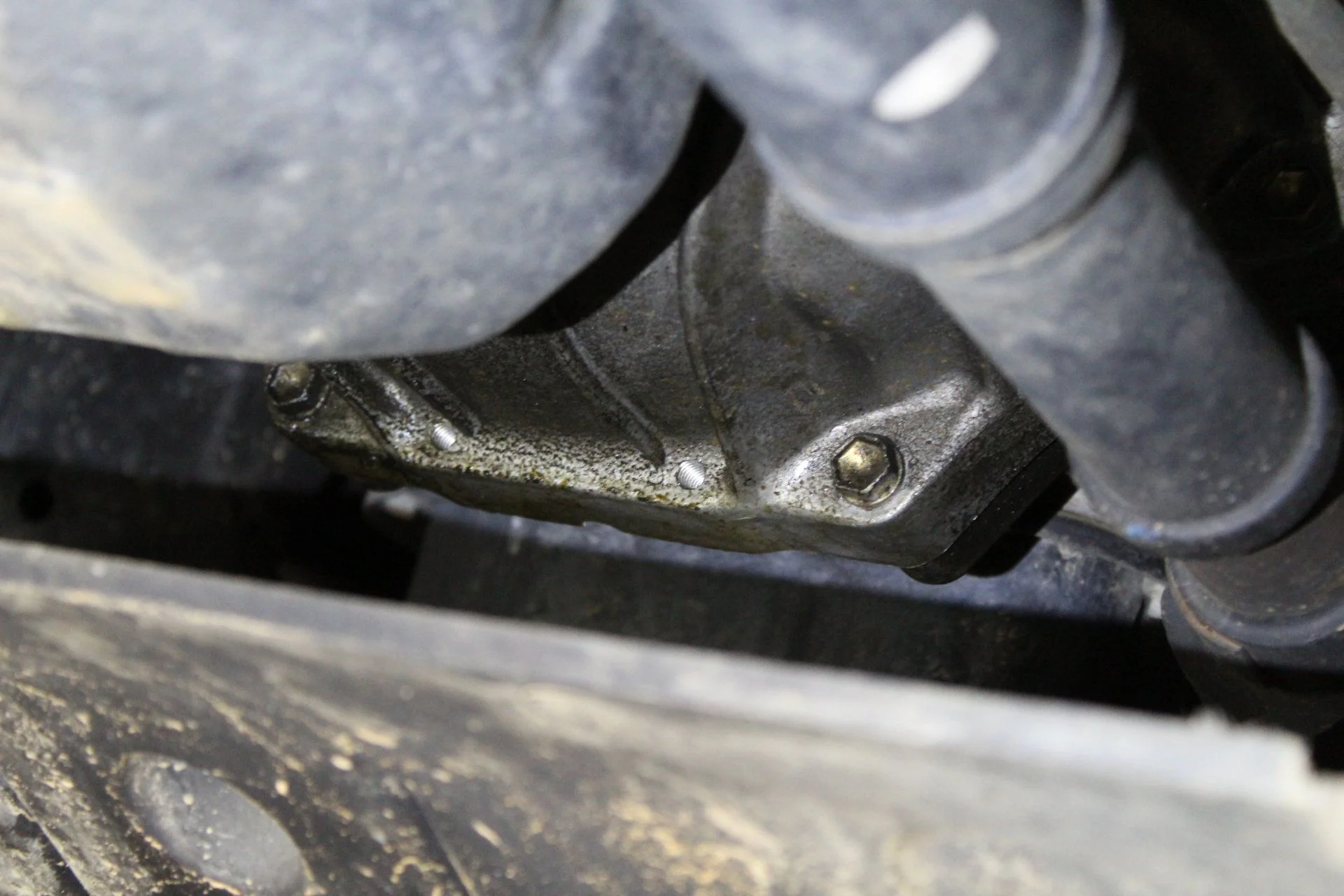

I took the running boards off today, and while I was underneath I noticed what appears to be two bolts missing from the transfer case(?). See picture.

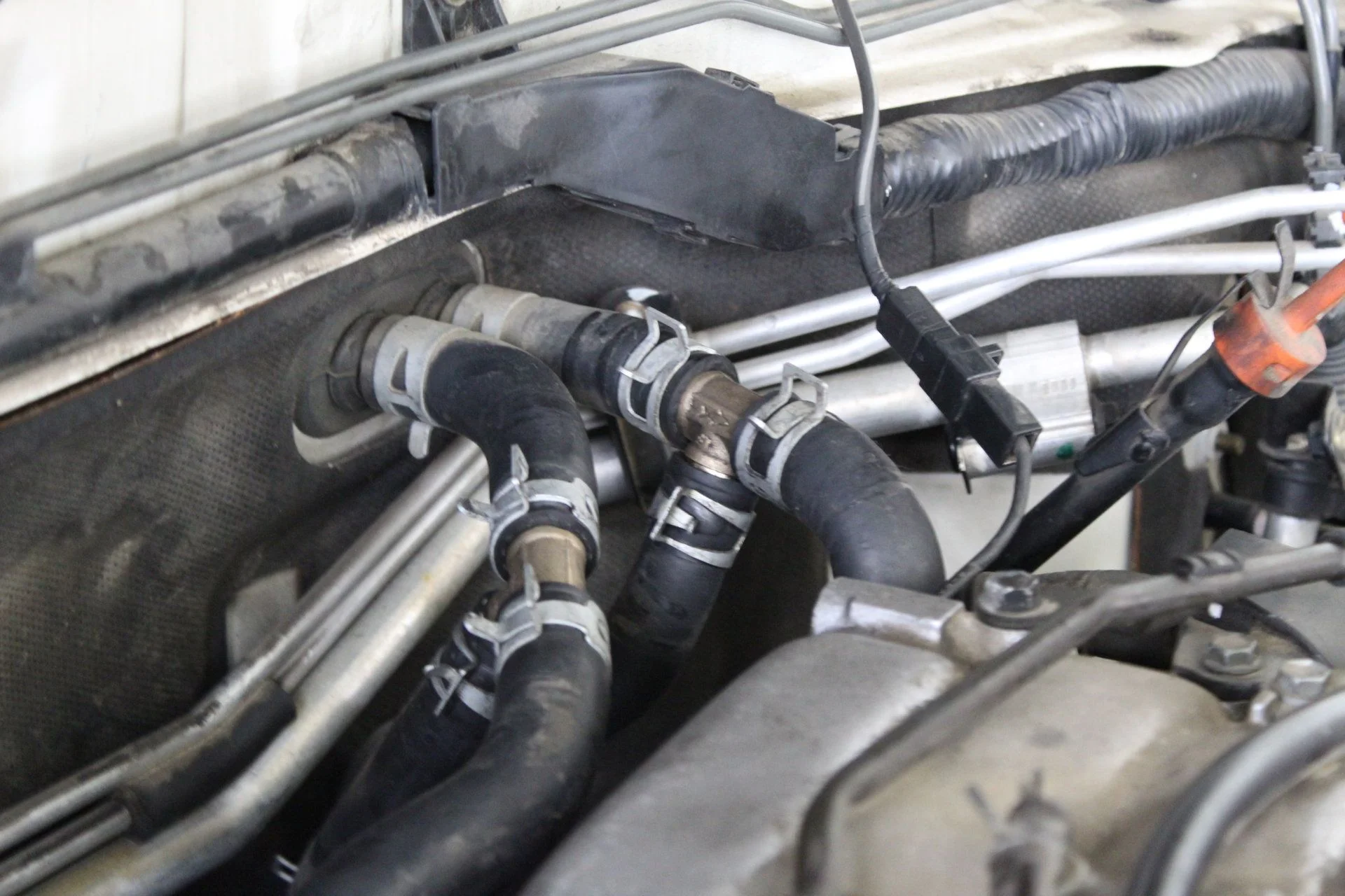

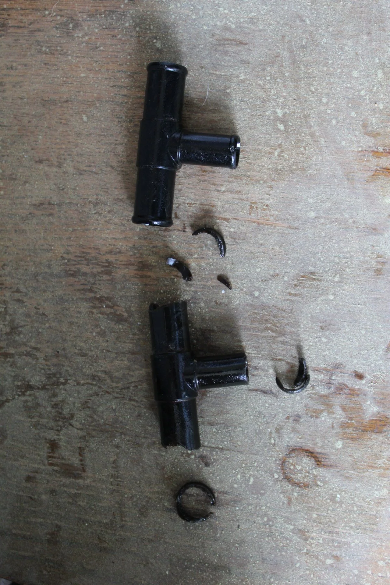

Swapped out the heater t's today. The hot side broke but the cold was in great shape. I don't know when they were changed but definitely not originals. The hot side was a bit tricky to get out (probably took me 15 mins with it compared to 5 for the cold). I found that a small pair of channel locks worked better than needle nose pliers to get the clamps loose. Below are pictures of the OEM t's out and the 3/4 in brass ones installed with the LC running at operating temp. No leaks but I'm going to keep a close eye on them.

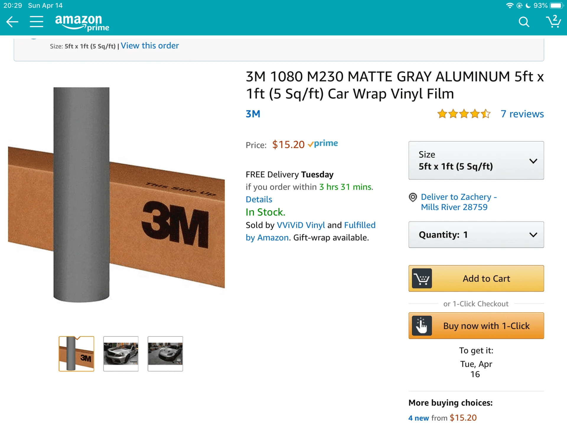

Also you can do wonders with an exacto knife, good straight edge and 3M vinyl off of Amazon.
After flare removal mine had some faded spots too, took care of it for under 30 bucks and about two hours of time.
This is the vinyl I used and comparison shot, it’s a great and easy update. I basically covered all the 1” wide sections on all the moulding.
