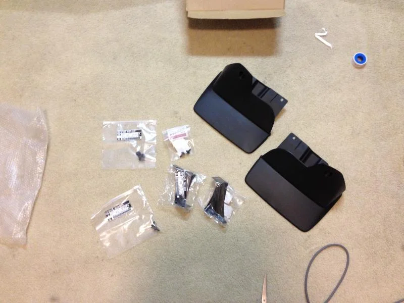

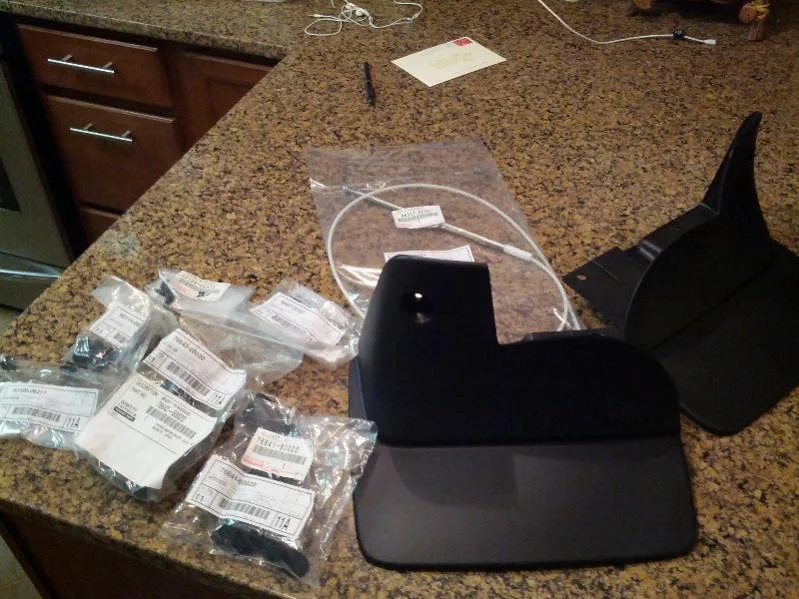

Got my mudflaps in and installed. Took a whole 20 minutes to install both. I had a bit of a tough time trying to find the part numbers for them so I figured I'd put them up here for those of you who need them.
Drivers flap (1): 76622 - 60060
Passenger flap (1): 76621 - 60070
Drivers Bracket (1): 76642 - 60020
Passenger bracket (1): 76641 - 60020
Bolts (6): 90119 - 06779
Screws (2): 90159 - 60576
Clips/Grommets (2): 90189 - 06211
I can confirm that these parts numbers fit the 2005 model year cruiser. However I believe that these will fit all LC years.

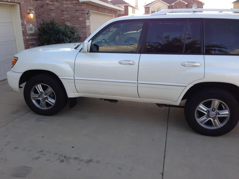

Here are the part numbers for my '07 LX 470. The flaps and clips are different part numbers. Are they actually different from Toyota parts I have no clue.
Drivers flap (1): 76622 - 60070
Passenger flap (1): 76621 - 60080
Clips (2): 90467-10187

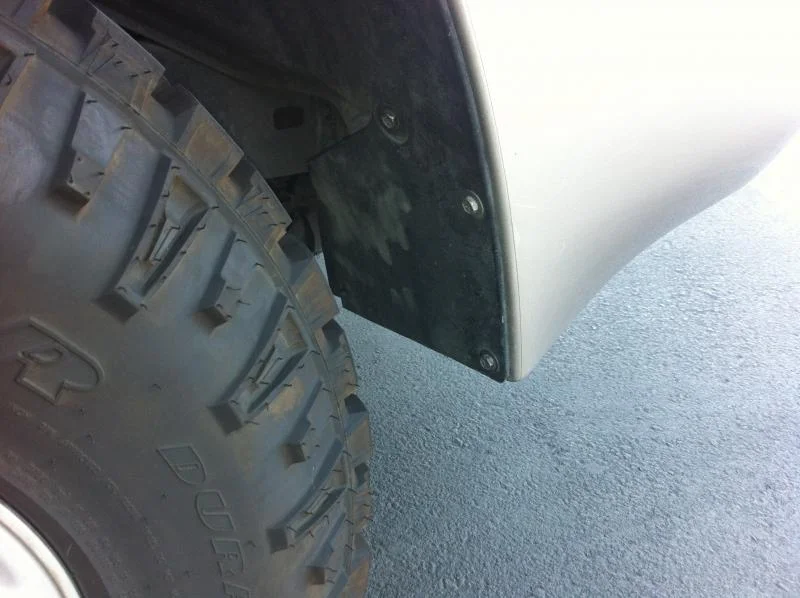

I'm assuming these don't work with sliders. Also, prone to get ripped off on rocks? I was debating on getting some, but they could self-detach on the first wheeling event.
I've seen a couple members who've trimmed the mudflaps to work with various sliders.
I'm personally not too concernced about damaging them during general wheeling or trail use. They attach to the body with two screws and one bolt, so they're decently secure. I'd be leery of thick mud though.
I broke rear ones on my 60 and my 100 while off road - once on a rock, once on a branch. It doesn't take much to break them.

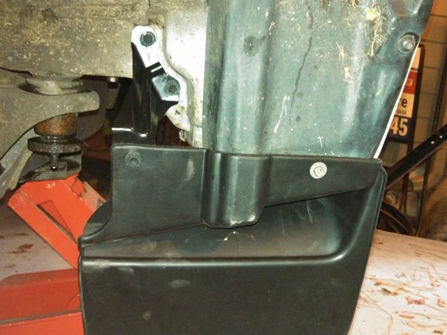

Toyotalandy,
A couple tips as I just did this a while back. Photo shows left (Driver's Side) wheel well w/ wheel/tire removed (which I do recommend). There are 2 threaded holes already there where you see my bracket attached to the wheel well.
I recommend cleaning out the holes & lubricating the 2 bolts, as I broke one when it was only about halfway tightened. Fortunately I had a couple extras and it drilled out pretty easy.
Note the upside-down "L" stamped in the DS bracket, just below the top bolt.
I also took the time, prior to installing the mudflaps, to pull back the bottom of the fender liners & vacuum and hose out the interior of the front fenders, between the wheel wells and front doors. You'll need a Torx driver for the bolt you see at the top right in the photo. There is a drain hole down at the bottom but mine had sand, pine needles, leaves, etc., collected in there. Helps prevent future rust opportunities.
Passenger side was a little bit trickier as mine had rear A/C lines somewhat in the way. Your '98 probably won't have 'em though.
Hope this helps.

Thank you so much Mark SR! Picture explains it perfectly. Having the tire off would have been a whole lot easier, but I am a chick & I don't like going under cars on jacks. =) Just installed both flaps with no problems!
