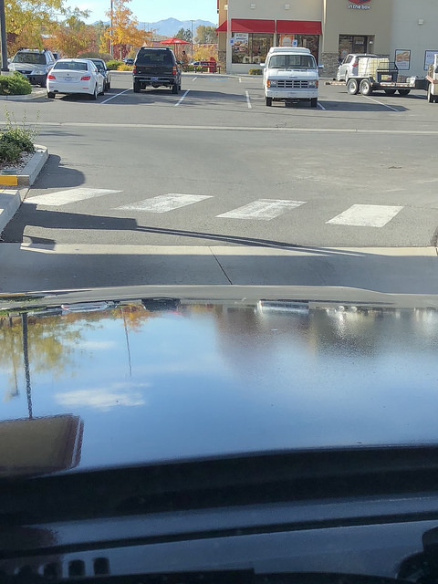

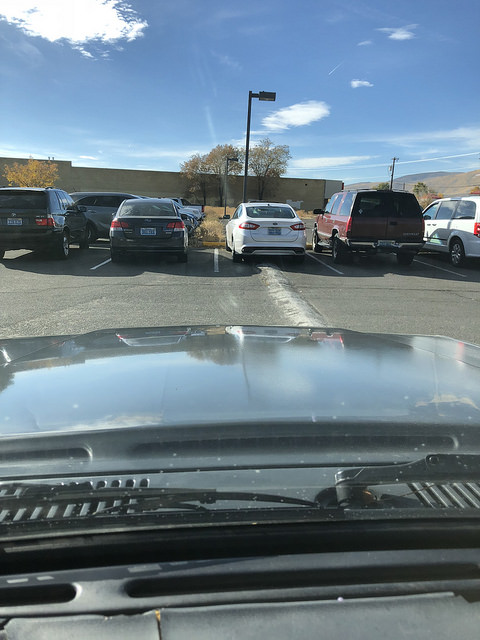

This is the rest of the drivers side half of the hood. However, this time I went at it with my DA sander connected to my compressor. Did 1500, 2000, Compound, Fine Cut... About same amount of time spent and was using a spray bottle with a small amount of Simple Green added (my normal bike wash bottle that was almost empty) to water to spray down for a psuedo wet sand. Previous wetsanding was done by hand with a small handmade sanding block.
Look at the difference between the two sides of the hood looking at the cars, building and trees. Not bad for maybe an hours worth of work? Not really keeping track at this point.

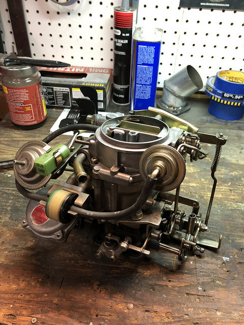

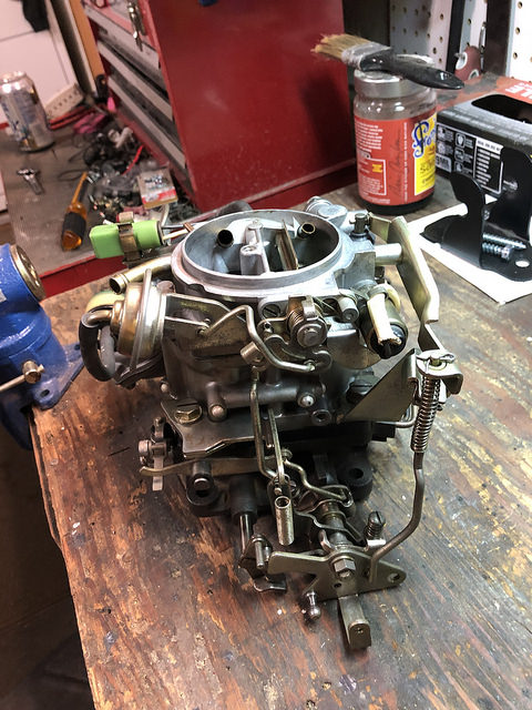

So got an email from Jim over the weekend. Newly rebuilt and desmogged carb should be heading home today! He said that it was an exemplary example of a carb that has never been touched, molested, or rebuilt. He said that after a little cleaning off it was in great shape!

So the @FJ40Jim rebuilt/desmogged carb will probably be going on tonight!! So excited to finally get this and get rid of this damn finnicky original carb. Seems like as it has gotten colder the throttle is wanting to keep higher in the rpm range. Thinking I may send it off to @NeverGiveUpYota guy that redoes the bushings and everything. I highly doubt I will ever need this carb again but would like to have it as a back-up/loaner should an issue ever arise.
So after installing the JimC carb last night and taking it out for a test run all I can say is DAMN so that is how these trucks are supposed to run. Super smooth, accelerates (if you can say a cruiser does that with the 2F) like no other and I was able to stick my foot in it on the freeway and feel instant response!!
Idle is nice and smooth and quiet and dear god does it feel good to not have to tap the gas pedal to keep the rpms down. Neat thing was that on the back of my invoice from Jim he gave what looks to be the date stamp on the truck and translates.

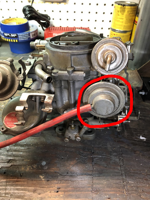

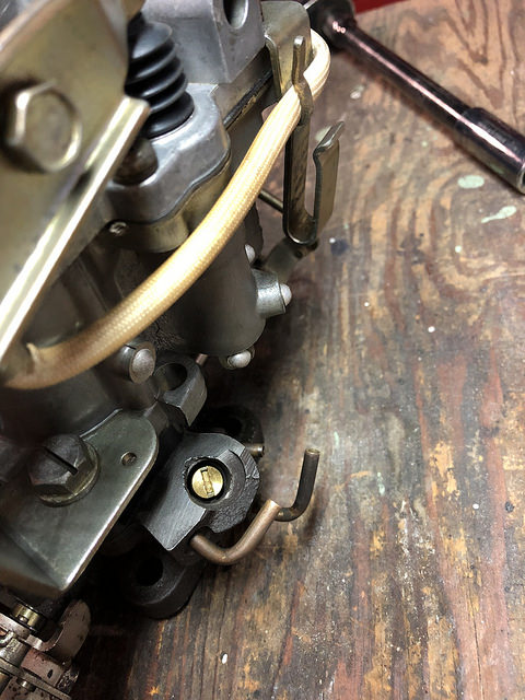

After seeing this I realized that my stock carb that came with the truck is actually a 21100-61141 carb and has an extra actuator/break pump on the idle set screw side.
Believe this is attached to the choke breaker circuit but not really sure, regardless it just went to one of the ports on the air cleaner.

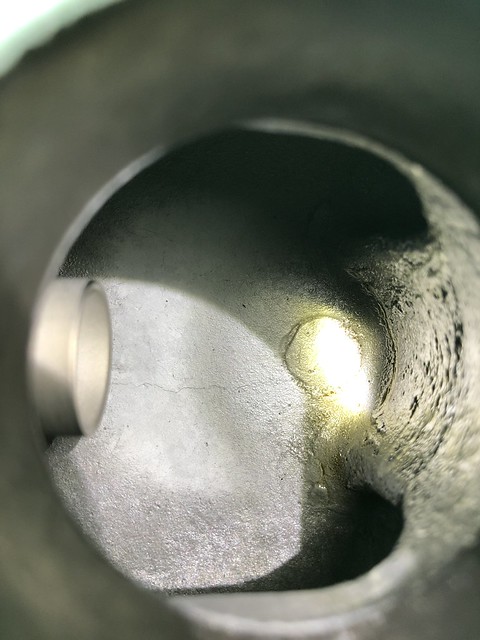

Was looking through the pics I had taken while I was doing that swap and found this one... Looks like the spring will entail some downtime to take the intake to a shop and have them repair a small, hairline crack in the bottom of the intake. At that point since everything will be off I will probably order new exhaust horn springs and have the shop replace those as well.

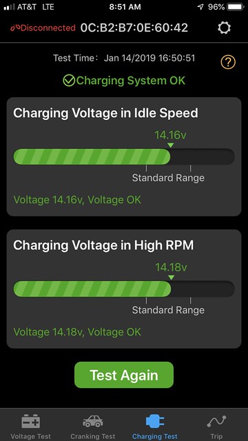

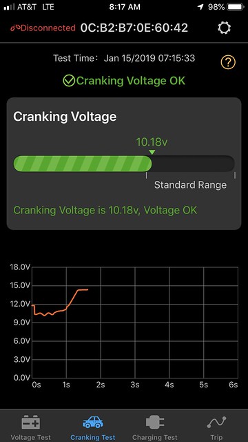

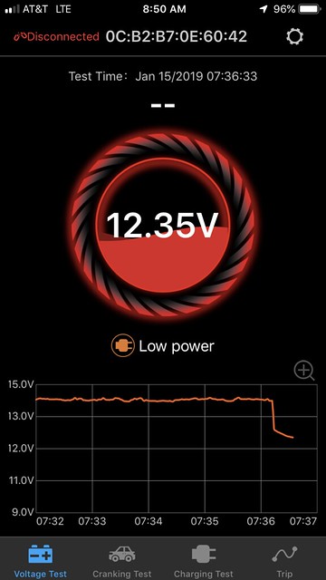

So I have been having some occasional issues with starting, nothing bad but on days where the temps drop below 40* the battery seems to have a real hard time turning the engine over. This isn't limited to nights where the truck has sat for more than 8hrs or less than 8hrs, really seems to be temp related and is something that has been prevalent this year.
After talking with @HemiAlex he turned me on to those little bluetooth battery monitoring systems. So I found one on Amazon for $33 and got it installed last night. Simple install, then go to your phones App Store and download their app, sync via bluetooth and BAM you are ready to go. System starts providing information right away and has a pretty decent range (maybe 30ft) to be able to sync to the module. Once you get the connection, the system then downloads all the "tracking" it has done since your last sync and updates the screens. Here is what you see, real simple and efficient and it updates as you drive the vehicle.

Looking at the info, my battery is getting towards the low end of the "good" cranking power so it may be time to replace it sooner than later (which is actually what Batteries PLUS said was my issue, battery was healthy otherwise just cranking output was on the low side). I will keep monitoring it for a while and see what this comes back with but for $33, this is definitely something that everyone should have if nothing else than for piece of mind.
Yeah I saw something like this at one point and thought about pulling the trigger on it but was not sure how legit it was. Good to know its right on. I am having a similar issue as you with startups and slow cranking on colder days (colder being relative for Texas). My truck generally has had a rough time starting because of some dumb vacuum stuff on my part and required significant cranking time before I got it sorted. Now the truck just seems to not have enough cranking to turn the engine over quickly anymore. I think I may have worn the battery out. But would be great to be able to tell if that's the case on the fly with one of these. Thanks for the link.
