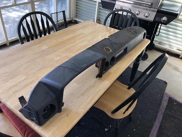

So this FINALLY happened... Thanks at Cruiser Corps for the dash cap, only took me like 4 months to finally have the time to install.

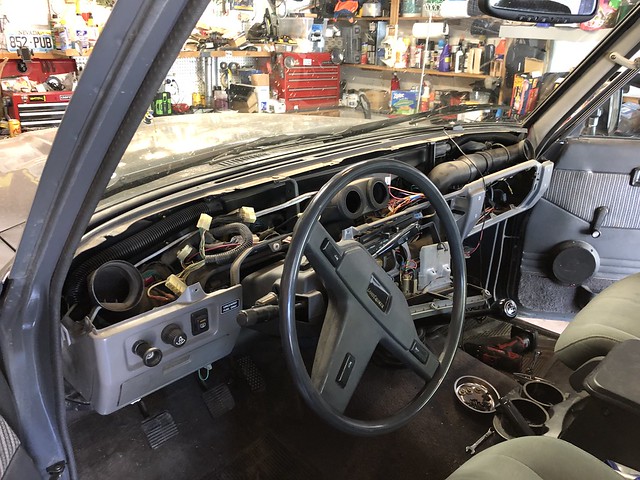

Dash is back in but not everything installed (other than necessities to get around). Waiting on my @NLXTACY Wits' End glove box to be powdered.

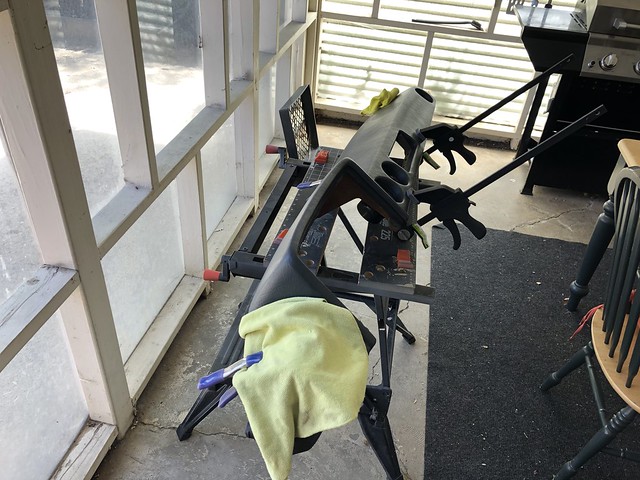

This is what I did to mine, One Issue that has come up, in the heat this summer, I had a corner bubble and then harden, so in the left corner of the gauge cluster I ended up with a bump. I am thinking a heat gun will fix it but will require removal of the cap.
Now the only thing I did different was use industrial glue to seal the cap to the pad.
Other than that I have been super happy with mine.
See the front of mine "clicked" into place however the rear side did not... seems like it is a bit short compared to stock dash which has caused it to not want to sit flush. I attempted to use some of the black rtv that was sent with mine to adhere it in certain points but that did not even stick. I think I am going to have to pull it out to redo at some point.
