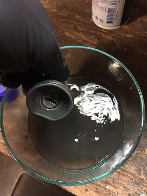

Anyways, as I was TRYING to turn the key to start her I watch in horror as the shank started to twist instead of the cylinder. Well, after a minute of turning a little, turning back, turning a little further, turning back, almost like cutting threads into bar stock I finally got her to turn enough to fire the ignition. When I got to work I found a small window of time on a break and started doing some research to pull the ignition cylinder to at least clean it.
Here is all the nasty guuk that came out when I was spraying it out with brake cleaner (all I had).
Untitled by Greg Fisicaro, on Flickr

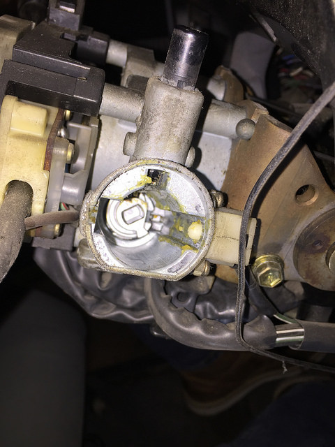

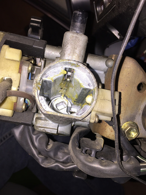

Gave her a thorough cleaning with the brake cleaner then put her with the face down, on a towel and let it all seep in and drain out. Got enough coming out after the cleaning that the paper towel turned dark from all the graphite and crap in there. Looking inside the column, there is some sort of waxy paste/grease in there that I am sure is used as lube but at 5pm at night it was already below 50 in my insulated garage and all of 35* outside so the stuff was starting to setup. I cleaned some out, not all but some. You can somewhat see it, it is a pale yellow color.

After the cylinder had some time to dry and drain I sprayed it with lube, forcing more graphite and crap out, and then let it sit and drain again for another 20 minutes before wiping everything down. Everything went back together easily and she fired right up after reattaching the battery. So tomorrow will be the test to see if this "helps". Ultimately, I know that I need new keys as mine are dull enough and worn enough that all of them can slip out of the ignition whenever. That means I will be spending money on a new driver door cylinder (since mine has been toast since I purchased the truck, a botched break-in attempt at some point prior to me) and then some new key blanks.
interesting effort. I need to pull mine apart - it doesn't return to "run/on" from "start". From what I've read I'll need to open it up for that fix.
Well cleaning the cylinder helped some but not a huge difference. It did turn slightly easier this morning but it was all of 19* instead of the normal 15* or lower, that could have played a part. Wondering if I should go get some of that aerosol electrical contact cleaner and see about cleaning up the steering column some?
