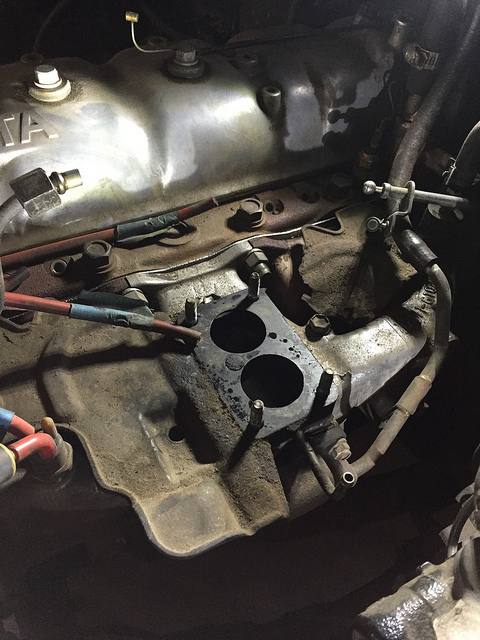

Think I may also need to replace my carb base plate. Does this look like it has been "fixed" before? Really all I have left is the base plate, shield is almost non-existent.

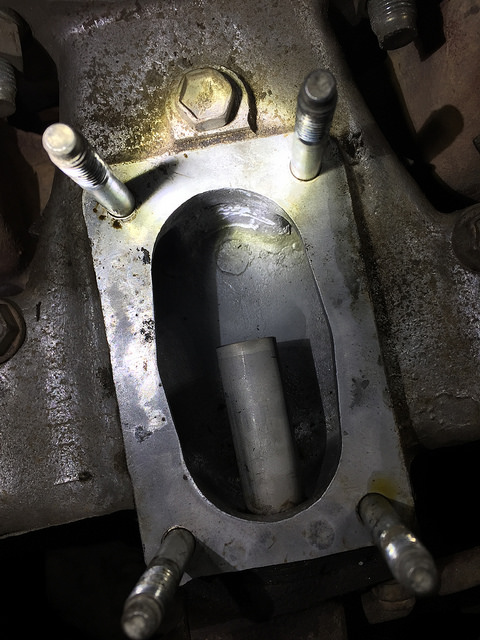

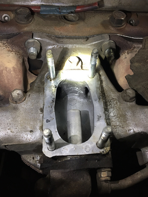

Looking down the intake I did not see anything that looked like a crack, so I am happy about that!!

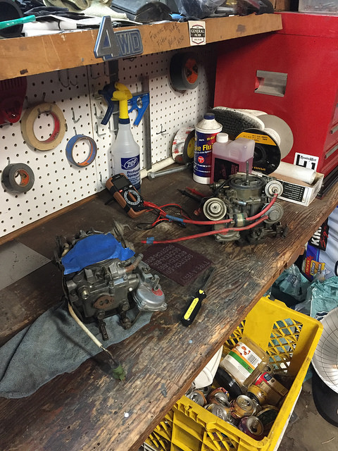

Alex's carb and my carb sniffing butts.. Had to swap over a few things, capped off the AC Idle up since his did not have the linkage.

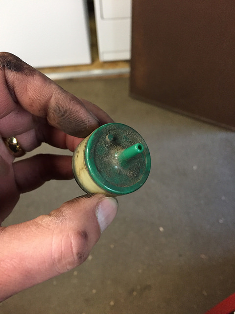

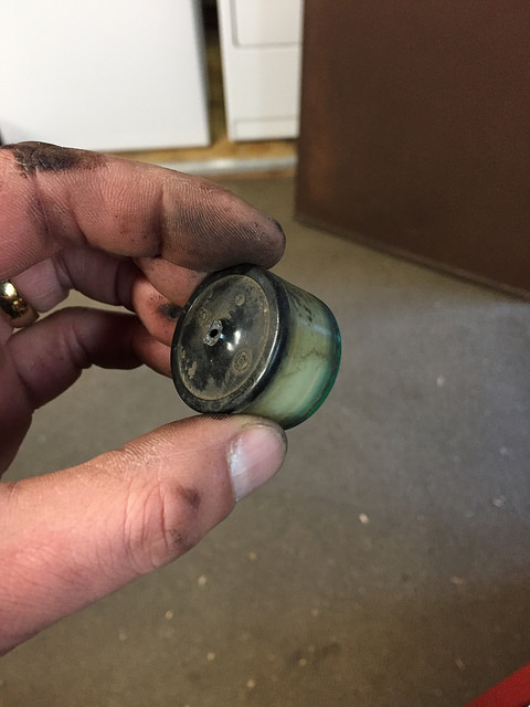

And then I had ONE casualty. Was trying to put the choke breaker back together and one of the nipples snapped off. Not a huge deal as I am normally right there when running the truck with the choke pulled and normally walk out after a couple minutes and push it in completely.

Anyone know where I can get this green/black valve or something to replace?
90925-01029
Part Description VALVE, VACUUM TRANSMITTING
Replaced By 90925-01079
Yippee Kay Yay - until you see the price!
Also ignore me if I am wrong but you don't want to use simple green on aluminum, I think it eats into it or etches it? And your base plate.. I was told that that was how they come from the factory. Ugly. Mine was cracked and was pulling air so I chipped off what I could and jiggled some JB Weld in and on it and let it sit overnight sitting upright. Its solid now.

I'd probably try to fix that choke breaker. Either epoxy/jb weld the nipple back on and clear the passage with a drill after it's hardened or drill and thread the plastic for a thread in barbed fitting.
Yeah I was thinking about trying that since it was a fairly clean break.

Currently have the plastic epoxy drying on the little VTV. Luckily it was a pretty clean break and it was clean itself so used a large paper clip to hold the piece in place and then coated the mating surfaces with a small amount (trying not to get it to squeeze into the orifice. After it setup for a few I then went around the outside of the break with a layer of the epoxy, will probably put a second layer just for good measure.
Was finally able to reinstall the VTV, broke it again the first time but I think that was more because of the fact that I did not let it cure long enough as it broke in the exact same spot and the epoxy pretty much just chipped off like no actual bonding happened. Went at it again and did a better job cleaning it, sanding down the surfaces lightly, etc. and then let it sit for a day and a half. Installed last night without breaking it again... whew.
This morning I used the choke to warm her up even though it was a little warmer (where system in right now where we are getting a lot of rain with lows in the mid-40s) and she started right up. Left the choke fully pulled out for a good 5 mins (normally I got back out and push the choke in a couple clicks after I hear the fan clutch kick down) and it seemed like the VTV and choke breaker were working properly. Crazy how badly I can tell my carb was running with Alex's installed now. It holds a nice, smooth idle at about 700rpm with the fuel screw turned out about 3.5 turns. No more weird sticking accelerator issue where SOMETHING would stick and cause the idle to hold at like 2k rpm at stop lights and in between shifts.
