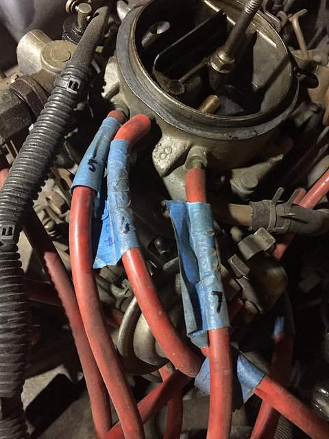

Got to take some pics of the vac lines so that I can hook everything back up quickly once I swap with @HemiAlex 's spare. Believe his has been rebuilt by JimC so that will take the carb out of the equation for the time being. When I have a little more time I will retrace all my vac lines to ensure they are hooked properly. After that will have to be going deeper into things and replacing the manifold gasket and possibly doubling if the vac leak at the manifold still exists.

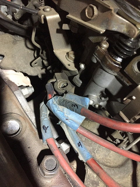

Checked all the vacuum lines to the carb and both ends were in good condition, not brittle or broken, nothing that would cause leaks and all were connected securely. Marked them to pull possibly tonight.

Couple things I did notice was that there was wetness and "grease" around the AC Pump arm, and the primary throttle shaft, rest of the carb was pretty clean so wondering if as the carb heats up the bushings in the throttle shaft become loose and are causing a leak. Is that possible? Might have to send it off to @NeverGiveUpYota rebuild guy in Oregon.

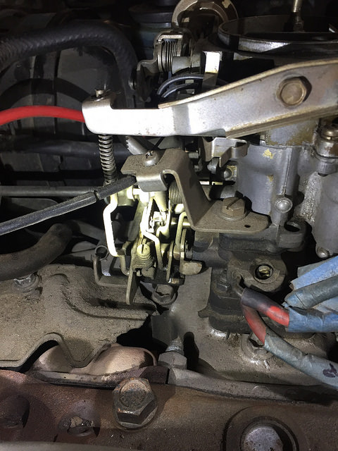

Took some pictures of the linkage side thinking maybe someone like @FJ40Jim, @Spike Strip, @OSS or @CaptClose might see something that I am not and find a bind point or something.

I'm thinking that the carb linkages somewhere are binding. Time too clean up that sucker. Your pic shows a grimy accel pump boot. That needs to be replaced. The boot will eventually rot and pieces of it and dirt will end up in the accel pump bore which can migrate to the float bowl - then get sucked into the main jet and cause blockage mayhem.
And Marks contact is in my signature line. IF it was your throttle shaft you only need to spray carb spray at the shaft and wiggle it while truck is running and see how it reacts. He’s a good guy too. Easy to talk too and willing to guide you on diagnostics over the phone.
Agreed w/ Fred. If your idle is high then it’s most likely something sticking in your linkages. If it improves when you tweak the pedal w/ your foot then try disconnecting it at the linkage and see what happens.

What about the bushings where the linkage hooks up high on the firewall near to the seam of the hood? I was under the impression they wear out and can cause sticking as well.
If I’m way off ignore me.
That's actually a good point F, wonder if that or the point where the linkage arm connects to the pedal at the firewall. I was looking last night and noticed there seems to be an adjuster on that long rod that goes from the pedal to the bracket you are talking about.
Yes you can loosen or tighten the rod. I’ve pulled all of that and cleaned every pivot point well... you could too. The balls in the sockets (all I can relate them to) tend to get very evident wear patterns. I think I had tightened mine just a smidge but Check those three bushings up high. I’ve read threads on all sorts of issues w/ high idle esp when my tach on very cold nights was climbing and sticking at 3k although I could hear and feel truck wasn’t actually revving that high.
