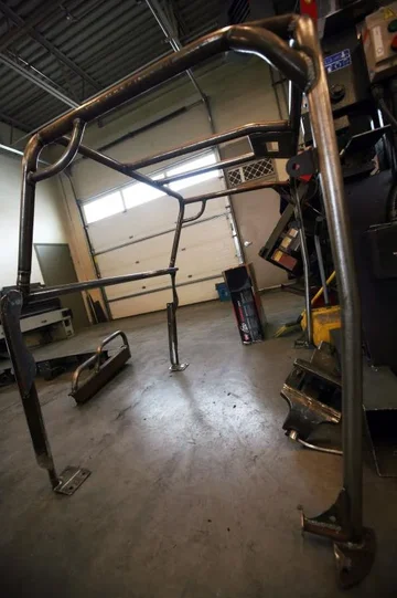

Roll Cage
I had to have a roll cage in the 45, which fitting one in the confined space of the cab isn't an easy task. Proffitts went with a 1.5" x .200" tubing for the cage (with exception of the lower 'A' pillar), small but strong.
Front View:
(Drivers) Side View:
Close up on the 'A' Pillar where it attaches to the dash/door frame. This design was chosen over tubing in order to allow a bit more leg room while still allowing for load transfer from the cage to the frame ties:

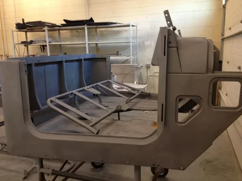

Body
Still a bit more work to do on the body before it is ready for paint. Seams to fill, holes to patch, but generally, it is in pretty good shape.

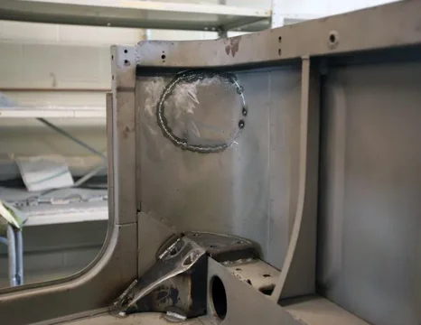

The patched-over fuel fill neck. Also note the roll cage 'B' Pillar mounting plate directly below:

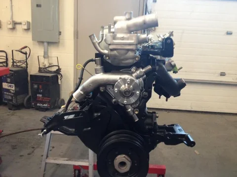

Next week the plan is for the engine to be rebuilt, and things getting ready for paint...

Body
A bit more work to do on the body, but is getting closer to paint, as well as well as the seat mount that ties to the roll cage (yes, it's currently sitting backwards):)
