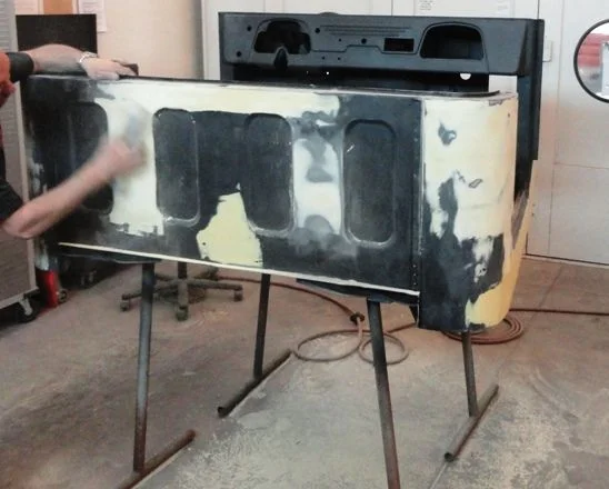

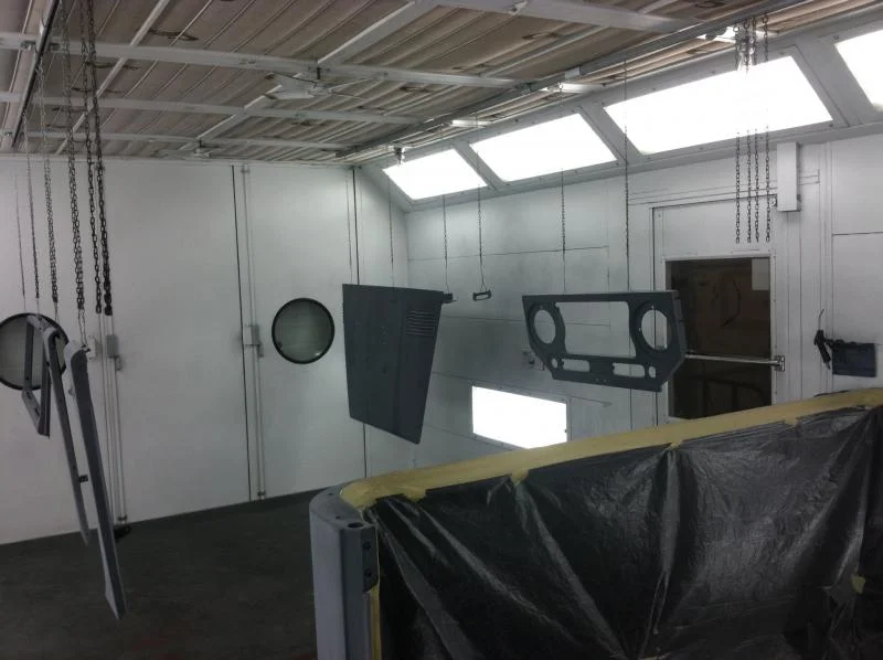

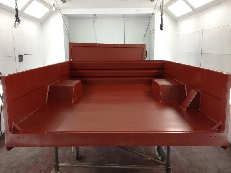

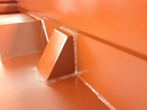

Other than the tub, all of the major body parts have been epoxied, and the bed/tailgate are currently in primer.
I didn't take a lot of pictures, as most of the work isn't very photogenic yet (wiring harnesses in the frame etc...).
I did get a few pictures of the bed in the paint booth...

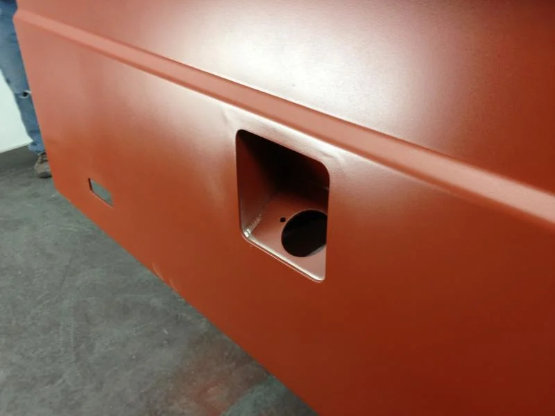

Close-up of the fuel fill cutout from the bed side
And the body side...
There will be an FJ40 - style fuel door that will be installed as well.
Body work is pretty much the name of the game for the next few weeks, hopefully everything will be in paint late next week or early the following week.

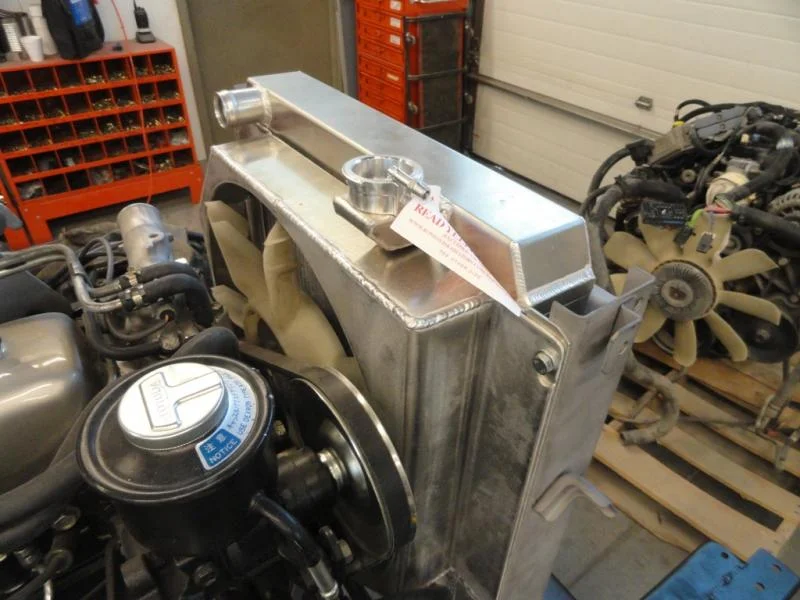

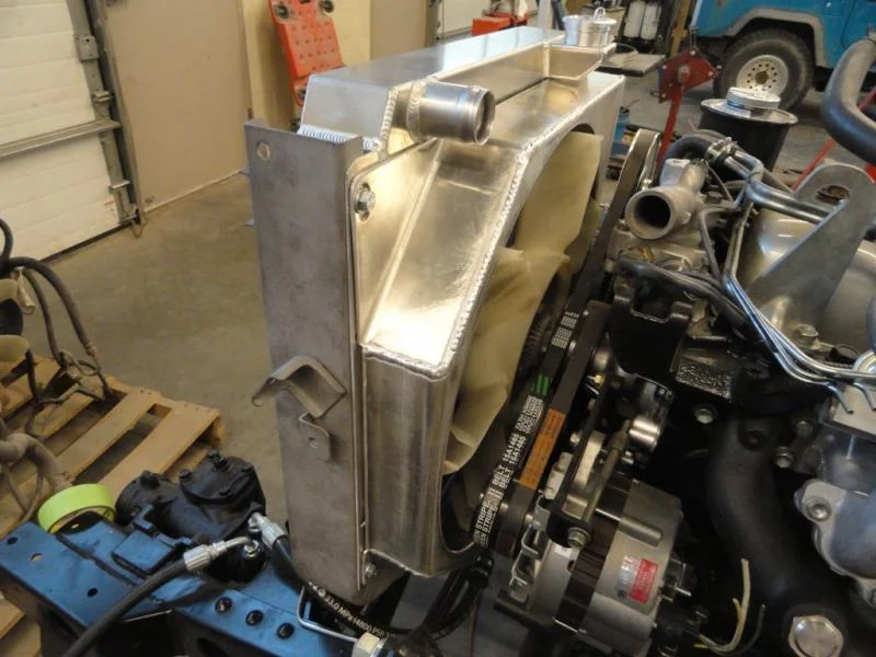

Another picture of the wheels on the rolling chassis, now complete with a radiator.

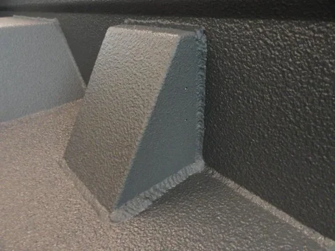

Vortex

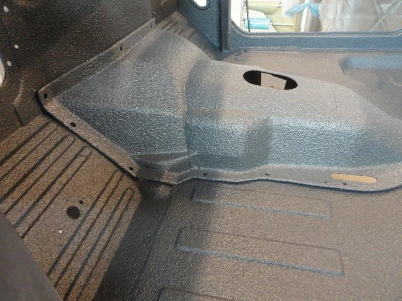

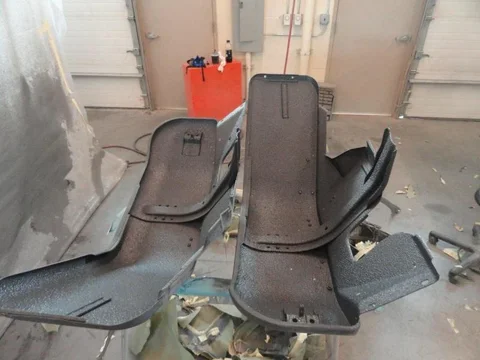

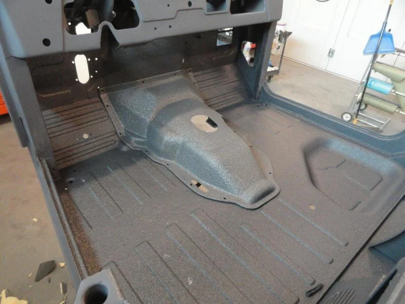

Vortex (Bedliner) is all done. Almost ready for some paint! Items that recieved Vortex are:
Interior of tub (with exception of dash and door jams).
Underside of tub (not firewall).
Underside of fenders
Underside of bed
Inside of bed (to the rails)
Fuel Tank
Everything else will get painted either Fashion Green #2, White (I forgot what the correct shade is for the bezel and top), or pewter for the dash insets.
The Tub:
Close up of floor:
Looking through the kick vent:

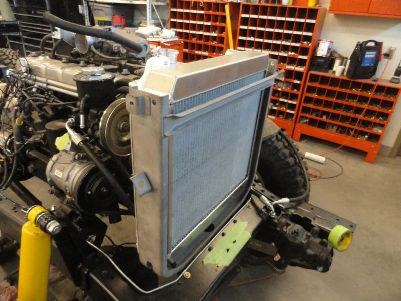

Radiator/Fan Shroud
Other than plumbing, the radiator is in, complete with a custom fan shroud:
Looks like someone found an original decal for the power steering fluid reservoir. Cool!

Bravo..Bravo....Excellent work....I like the VORTEX.....Oh Yah....my 45 will have the same coatings....Makes for a nice finish.
I'm sure I'll be happy with it. It should be pretty durable, and give some insulation as well. I know paint would look better, but not for long when using the 45 as intended :)
