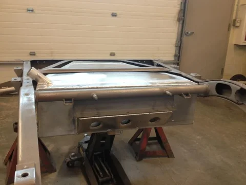

Fuel Tank
Fabrication is complete on the fuel tank. Filler/breather necks are welded in, as well as the mounting tabs.
The fuel tank should fit +- 30gal, which ought to give her pretty good range.

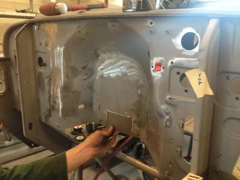

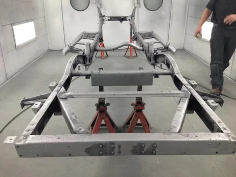

Paint!
There was a bit of a backlog in the paint booth, but the painting process is now full on. Frame and axle housings get paint first to get the rolling chassis put together.

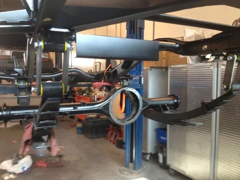

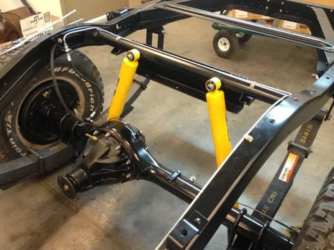

Rolling Chassis
The rolling chassis is starting to get put together. OME 2.5" springs and axle housings hung. The springs are heavy duty, thanks to all of the extras I just HAD to have (bumpers, grille guard, winch, roll cage, BIG fuel tank).
Interesting offset front shackles for the wider 60 housing. Why not outboard the shackle hanger like the front hanger, especially as nice as their outboard spacers look?
That's a good question that I can't answer. I do know that this is a very standard setup for Proffitt's, they do a lot of 60 series axle upgrades. This SUA with shackle reversal is supposed to give a much, much better ride than OEM. As far as outboarding the rear hanger, I don't know if it would be an improvement or not.

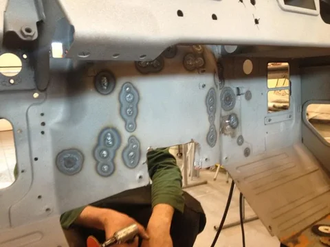

Update

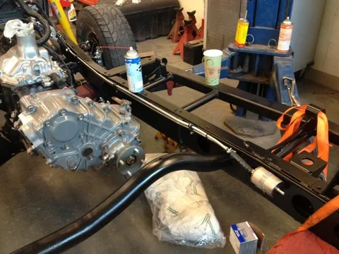

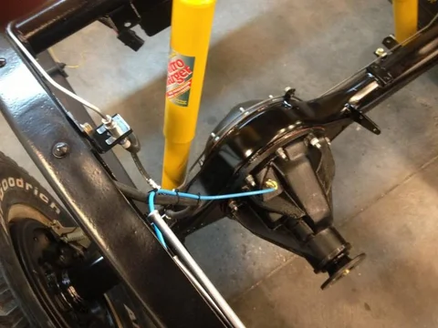

So the build has been progressing quite a bit this week. The project is now a rolling chassis, complete with engine and drivetrain. Fuel, brake and ARB lines are pretty much complete. Electrical is getting going, and the final body work has started. So we'll catch up with some pictures:
Engine, transfer case and transmission on frame:
