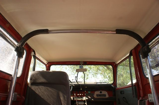

Used DAP. Sorry for the low quality pic. It's the only shot I have on the computer and I'm 500 miles from the truck, but this is how the CC headliner looks installed.

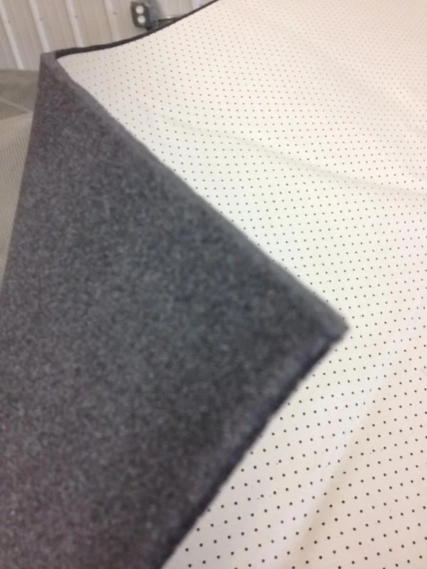

If you want the stock perforated look your choices are limited. Fabric and upholstery stores have good non stock options. Somewhere on here there is a thread where a guy used a thin, gray outdoor rug, it sounds bad but actually looked really good. I think I like the white or off white look best though. White spray in liner looks good too and can't sag.

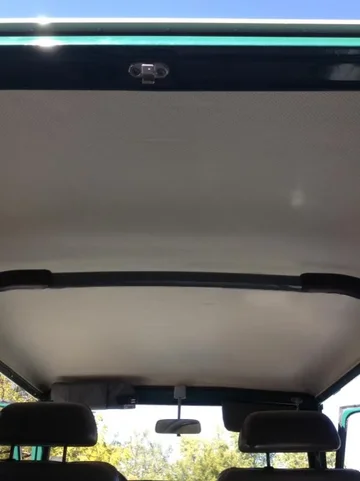

High end automotive carpet installed without removing the top. Done by a shop here in town. I removed the old liner and the old adhesive. This headliner has been through over 10 years of summer heat here in Southern Arizona and still looks like it did when it was installed.

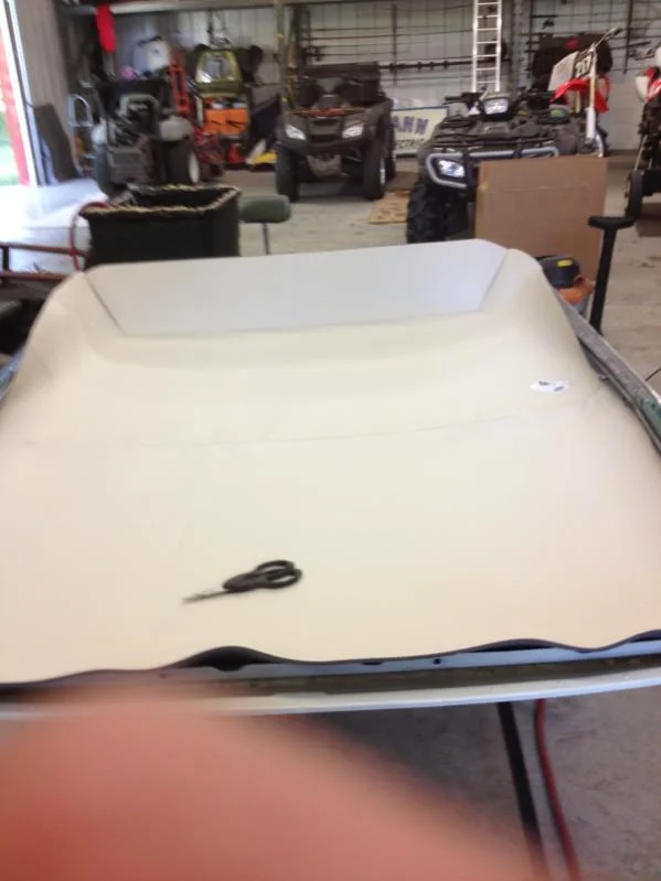

All Done - I LIKE the Cruiser Corp Headliner! It's thicker and less prone to wrinkles than the SOR headliner. It's also a couple bucks cheaper. If you buy it - Remove it from the box and lay it out flat for a couple days as it comes folded. I tucked it all in and went around the top with a Sharpie under the lip and then just trimmed it up with the scissors. Turned out great, Miller Time, Have a cigar!
